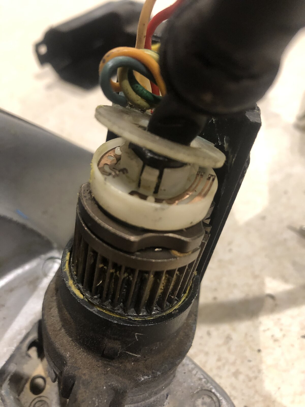

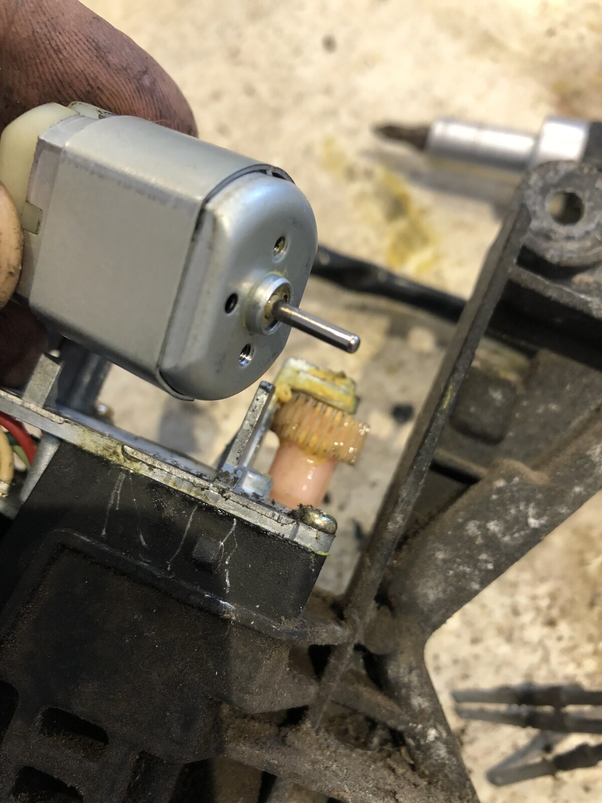

They came on a breaker I recently bought. The passenger side one would work sometimes and the drivers side one did nothing.
Drivers side: turned out the electrical contacts came away in the sensor/ turn table bit. Dab of super glue to keep them down, gears re-greased and oiled, job done.
Passenger side needed a wee push and it would fold. With lack of use the base part that turns had far too much resistance, causing the worm gear to spin on the motor shaft. WD40 and everything oiled, works again.
Might make another thread when I retrofit them to my truck. I have other pictures for anyone else toiling with repairs.
