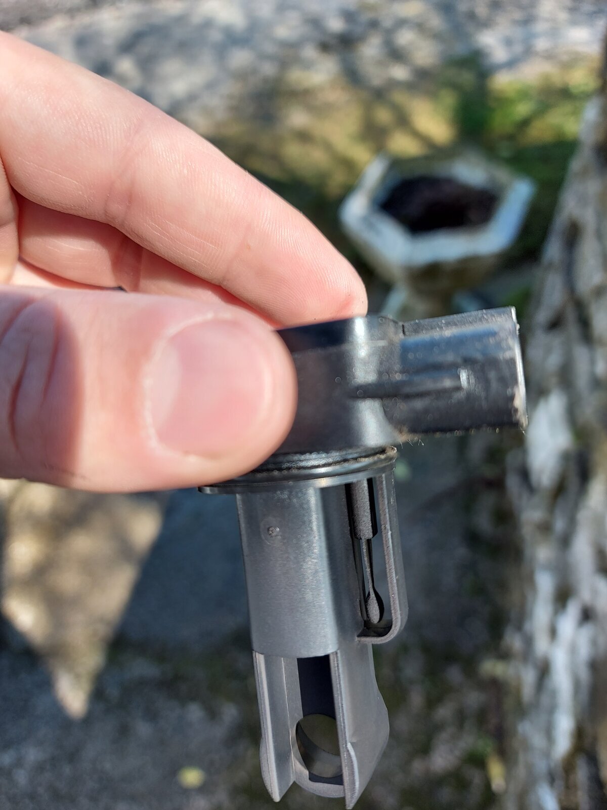

Last weekend I checked and cleaned the MAF,and it was dirty. I used whole bottle for cleaning from Liqui Moly :)
