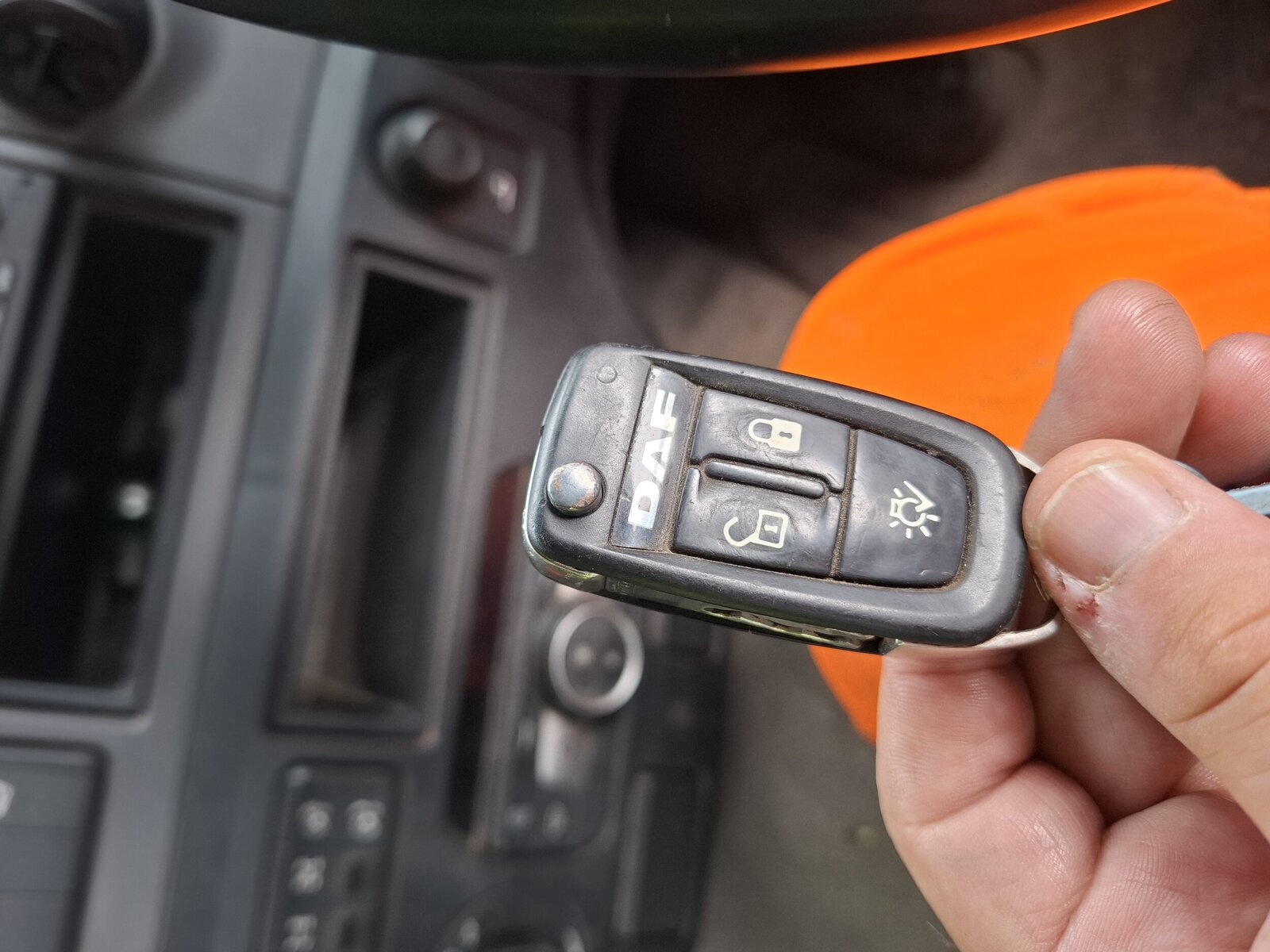

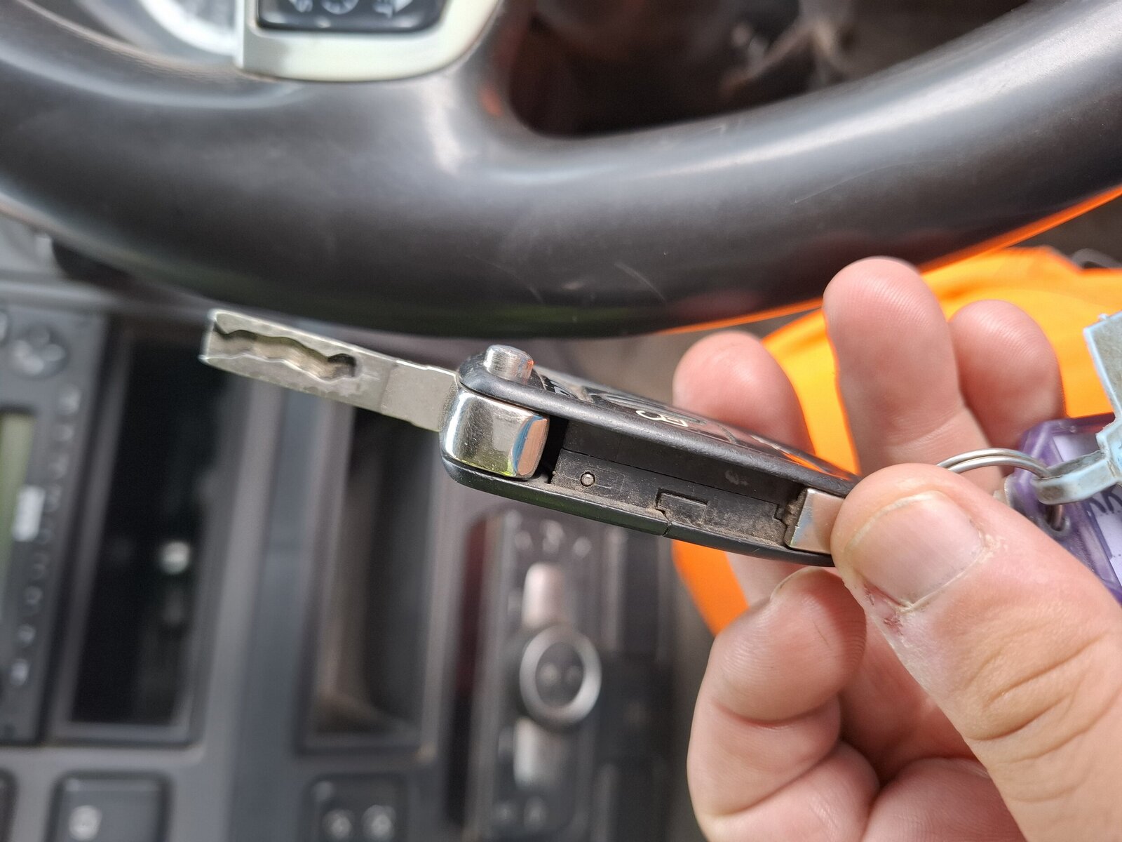

This is a daft wagon flip key.
Don't see the problem in a good key service programming a similar key for the landcruiser 120..

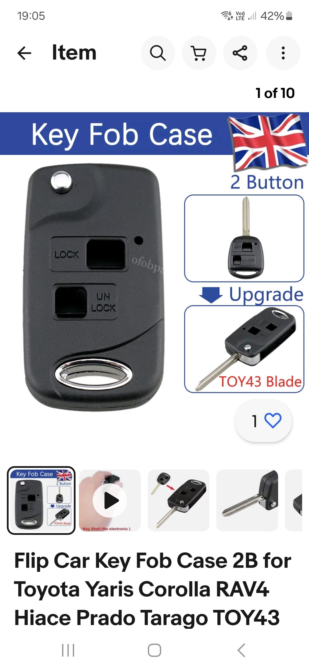

The yotamd one does not include the blank you need to buy that from whoever is going to cut the key
ebay 355892099180
I've had one of these for 6 or so years, used daily still does the job and not falling apart.
Simply transfer the plipper gubbins from the rubbish Toyota key into the case and get the flip blank cut, i think i used the grey key for pattern cutting as it was unused.
Note, its been a few years now but i recall there are several different pattern/length blanks so make sure the blank is the right one for your key.

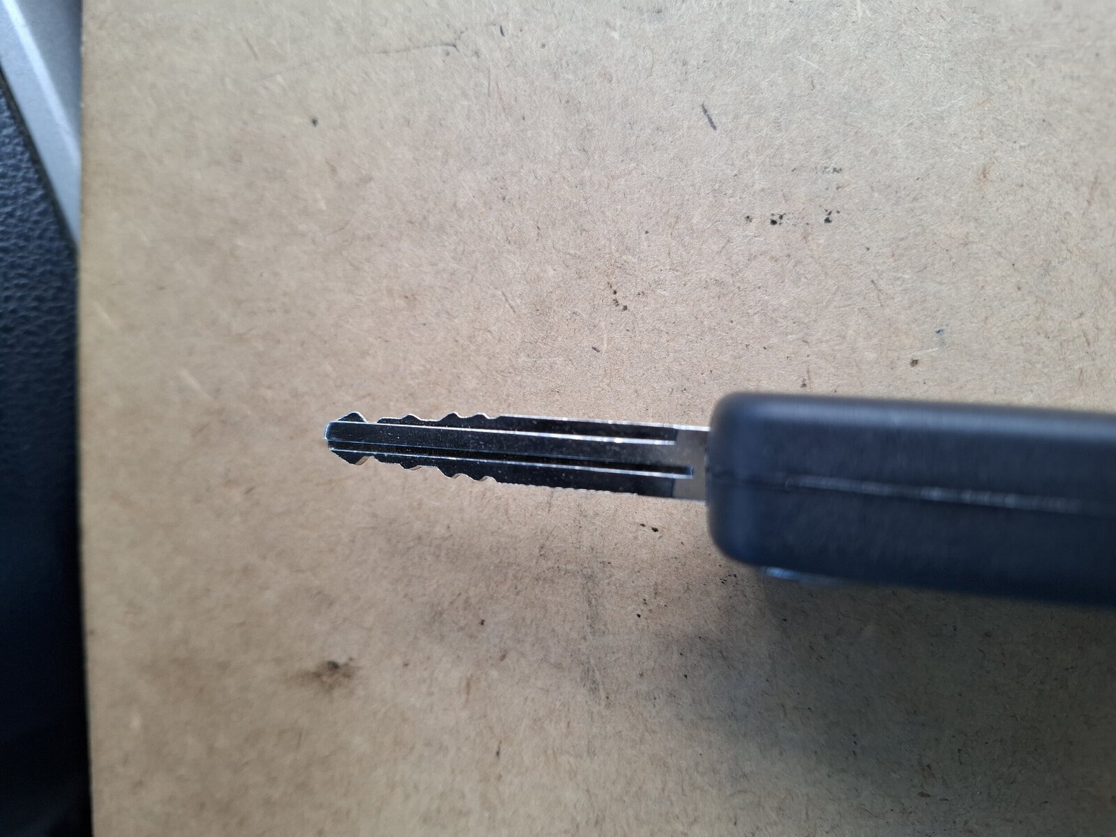

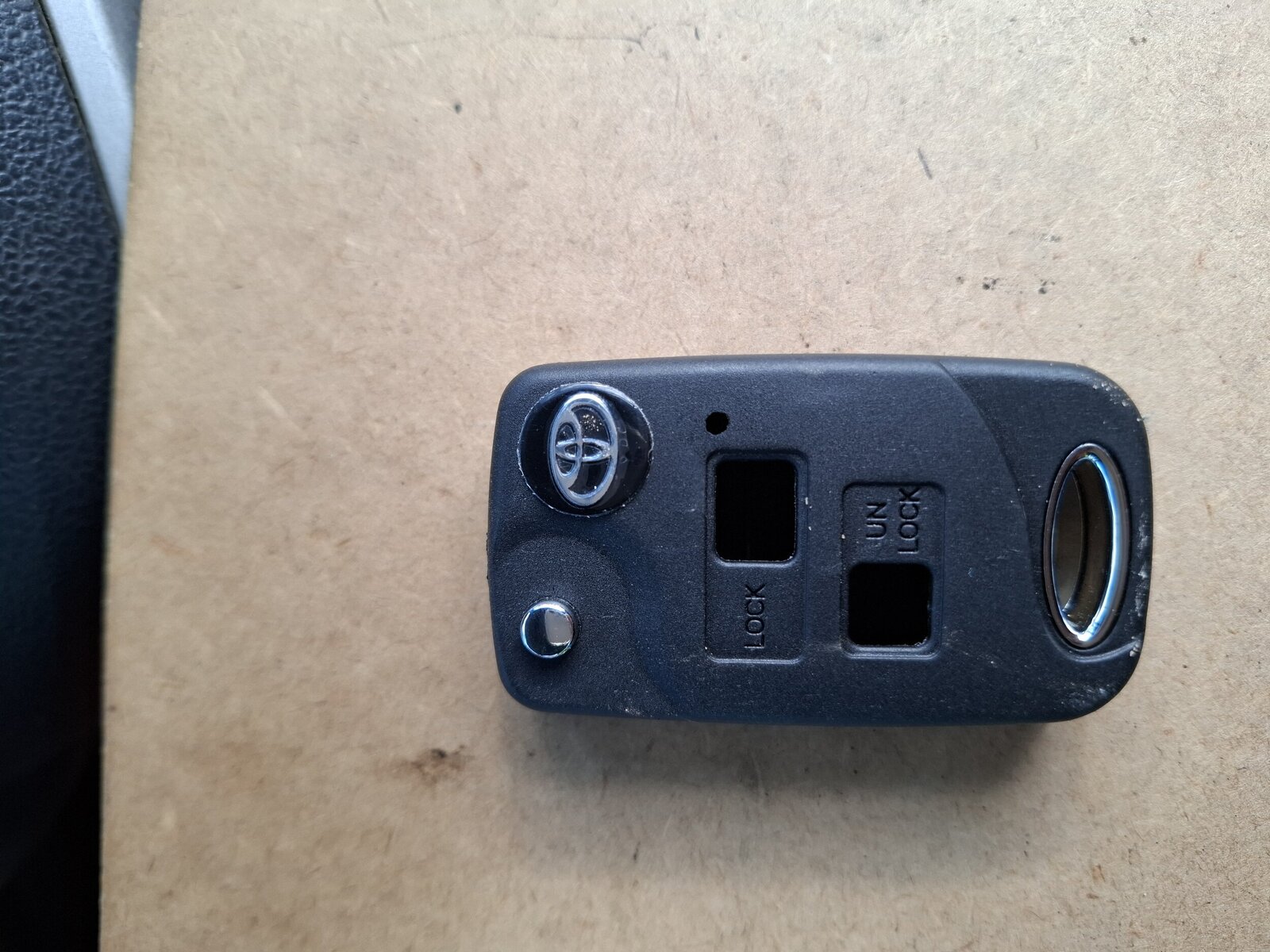

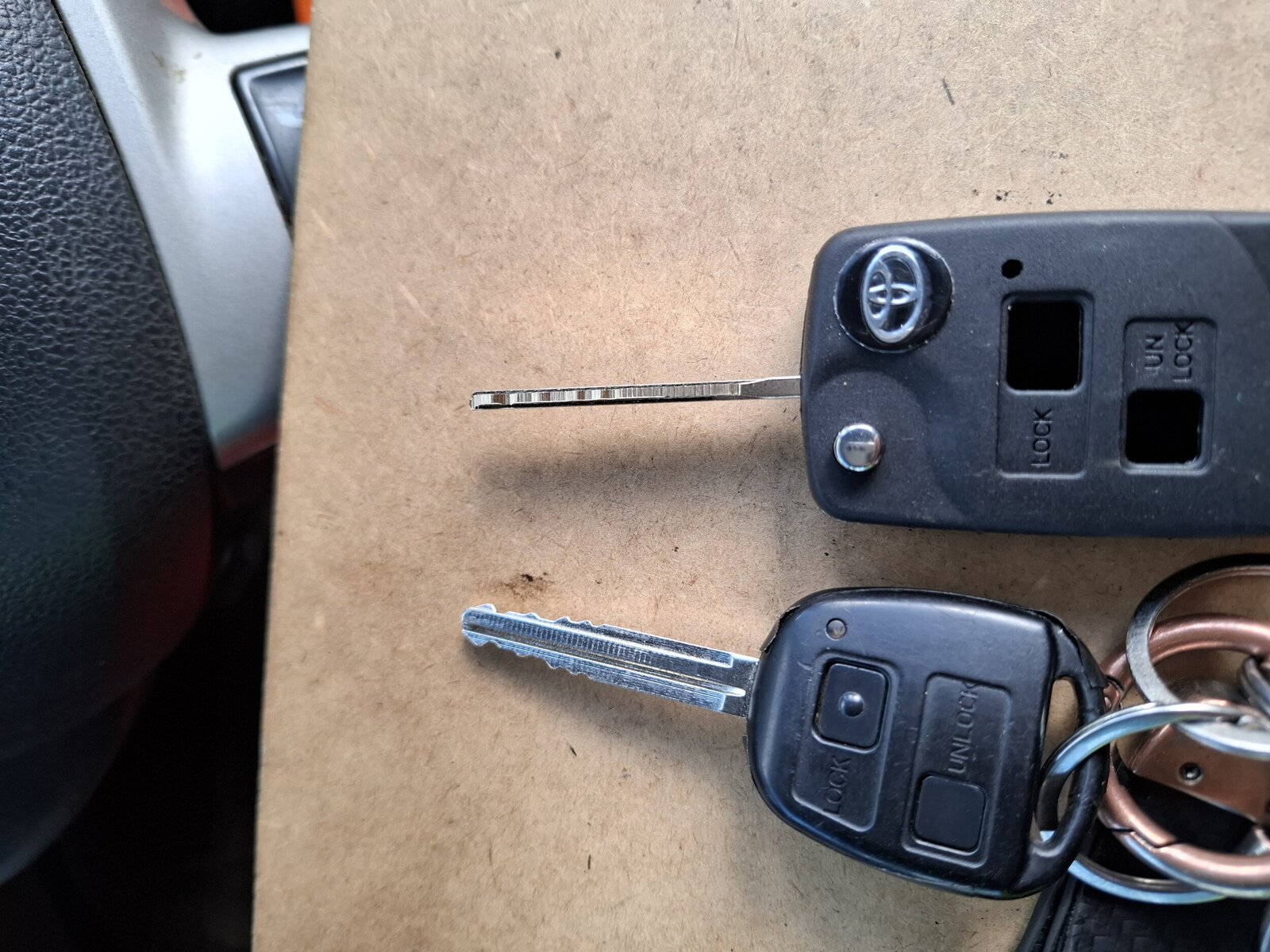

Finally got round to getting my flip key cut.
I went to NW keys on karl2000 advice.
Cost my £5 but not had a chance to test out yet as that will be when I'm home.
The guy did say
( the key could jam in the ignition due to being aftermarket. )
He also said because the transponder is a bit further away from the ignition it may not start.
But for the sake of £10 total worth a try.
Will try on my door lock first before my ignition.

Update my new keyfob works perfectly.
Ignition turn on the key was smooth.
Key in the door was also smooth but then I keep everything lubricated.
