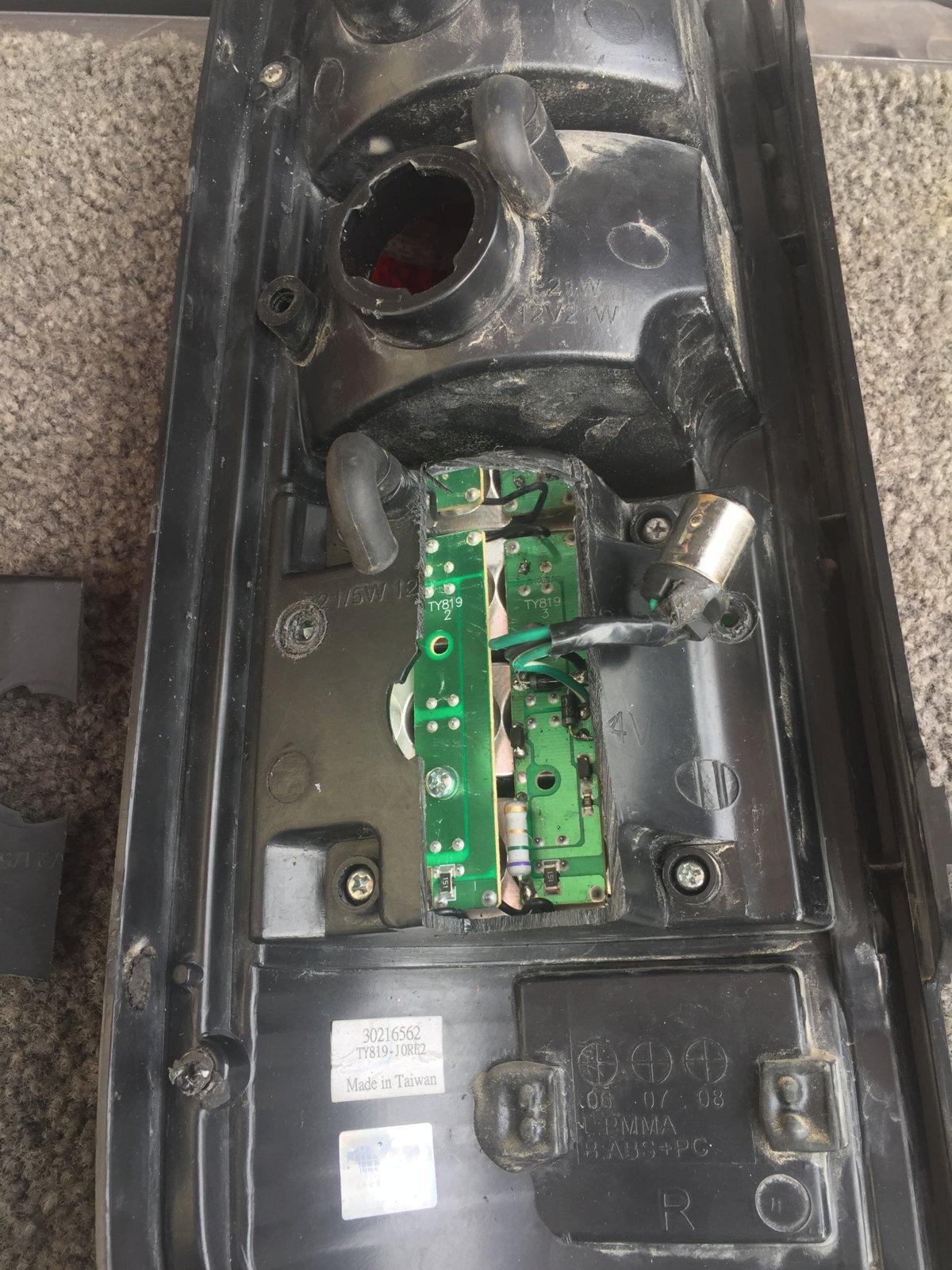

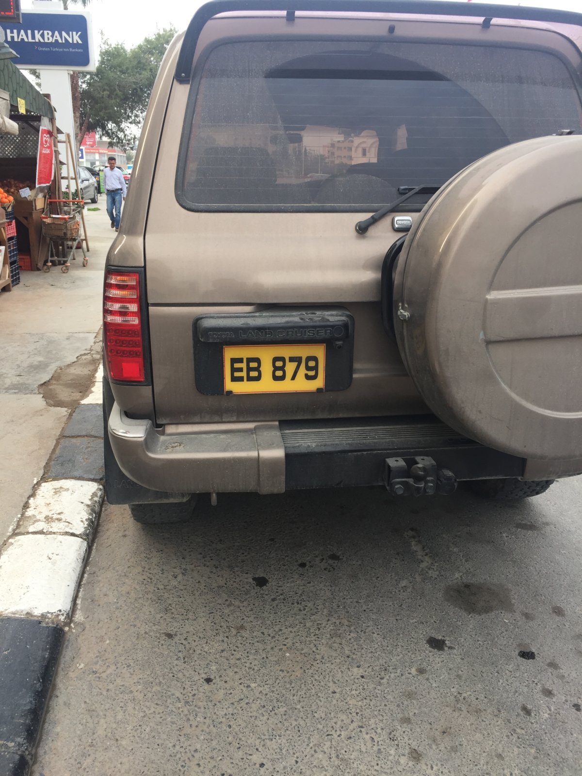

Guys some of you may have or have wanted to changeover to these. Mine being over 6 years ago to switching over. Everything was great with them other than when they go wrong there a pretty much throw away item.
Mine went wrong on the drivers side some months ago. The brake light failed to work with only the standing light working. I took it to the specialist electronics store for repair. Bottom line it’s a half fix with 3 if the leds not working. So having to live with that for now.
My plan is to replace the electronics for the red standing and brake light eventually with a led alternative as a option that’s possible.
Having researched on a lot of people experience failure with these.

Yes Clive most are non repair items hence why I had to cut into it to access the electronics. Whats your remedy Clive for the DRL's?
