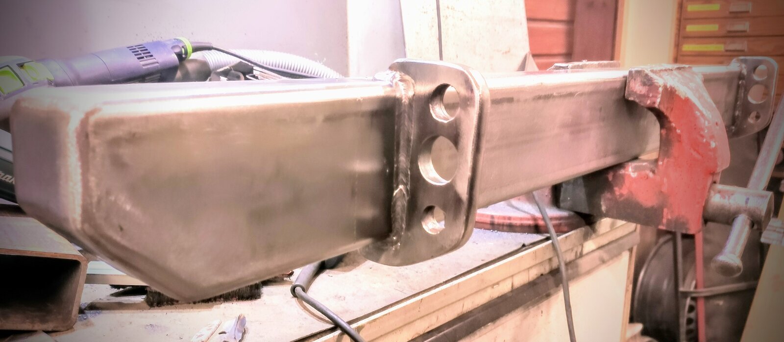

The rear axle, which is certainly newly manufactured, I have now blasted, then painted with black 2-component epoxy primer, then 4 layers of 2-component epoxy paint, so we can hope it can now stay in good condition for a while?
A small picture during construction of the combined attachment for the towbar and also the diesel tank
Hasplate under development for tank, silencer etc. there is little left 80cm clearance under the tail plate
