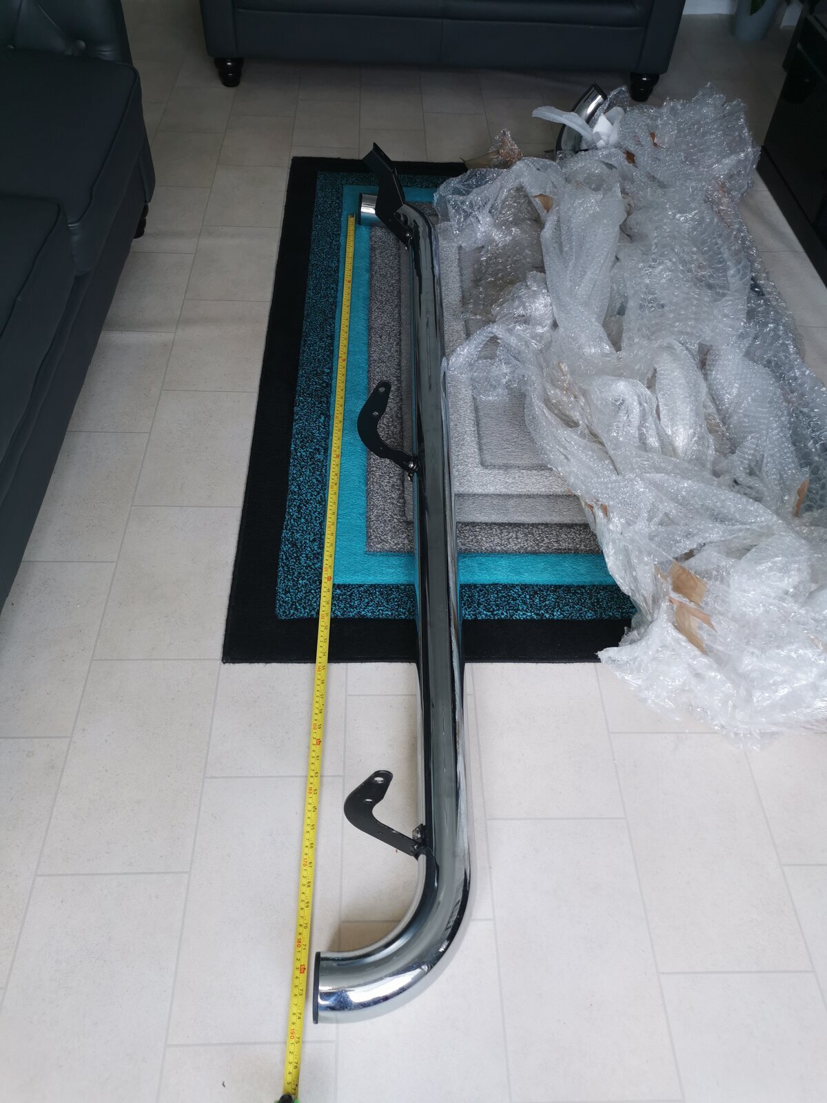

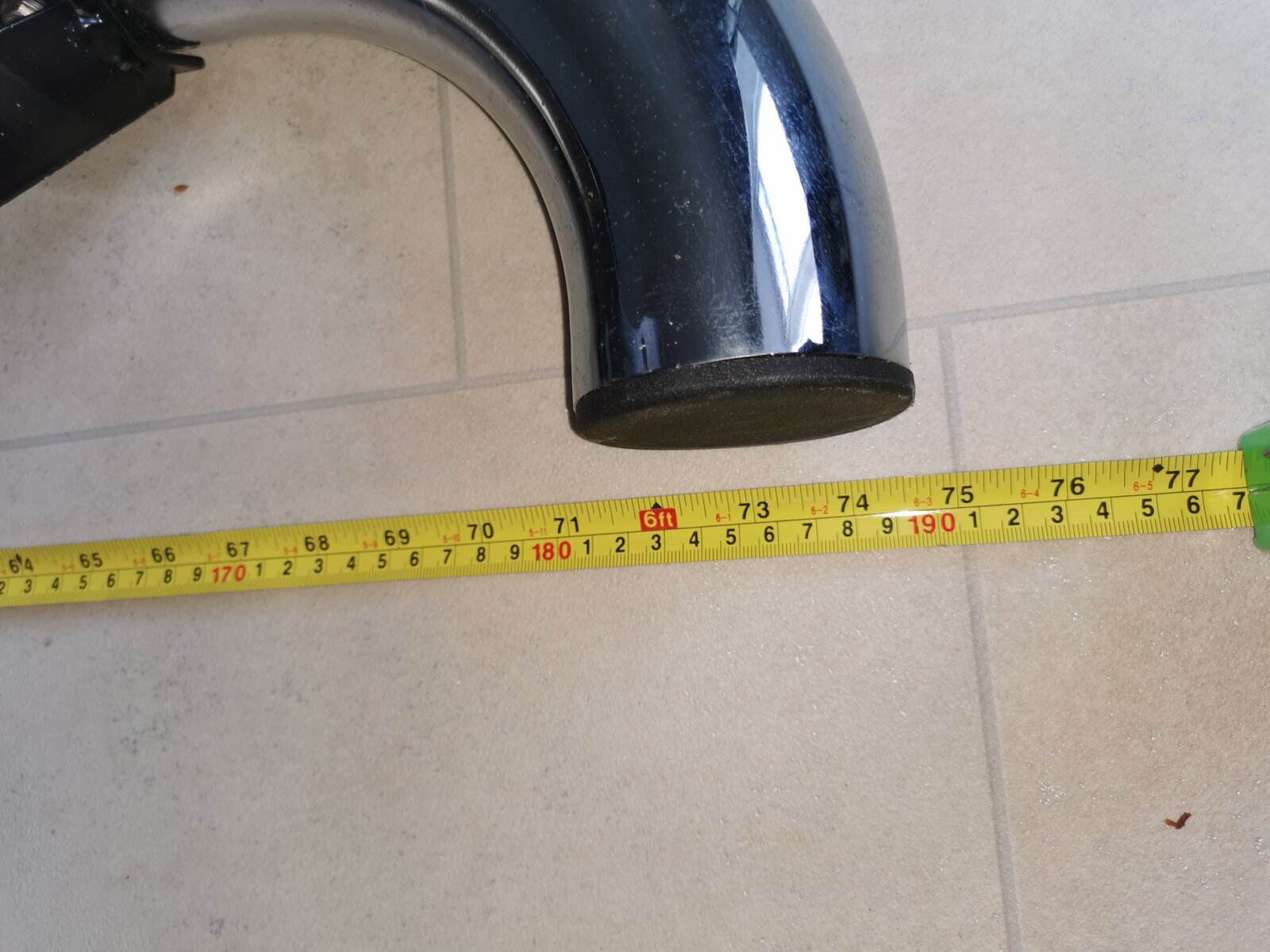

After measuring my original ones which look to be 1760mm the new ones look to be 1890mm so bit of a difference.

They look like the original side decorations as fitted to MK6 Hilux, have an identical as new set sitting in my garage from when i removed them and fitted a set of stainless steel steps.
Too slippery for us as steps in wet weather, hence why they got removed from my Hilux and replaced.
Try them wet and see if they're grippy enough for you mate, would hate to see you go to a load of trouble and be disappointed or worse the good lady slips off and does an ankle in.
Tony, You have answered your own question mate, with the measurements there. Too long.
As said my replacements were 1800mm and just fitted between the body wheel arches.
Agree with Juddian, as straight shiney s/s tube, they will be really slippy, mine are shaped with a lower section front and rear, which have a plastic type tread fitted by doors where you would step up to get in.
At one stage, I thought mine were going to be a bit long, despite me confirming measurement with supplier, and I did consider having each of them professionally cut with a section out of the centre, then using the appropriate size inner joint to reconnect together. May or may not suit you.
As it happened, mine were exactly the correct length anyway after a bit of jiggling to position them and start marking fixing holes in the rails.
