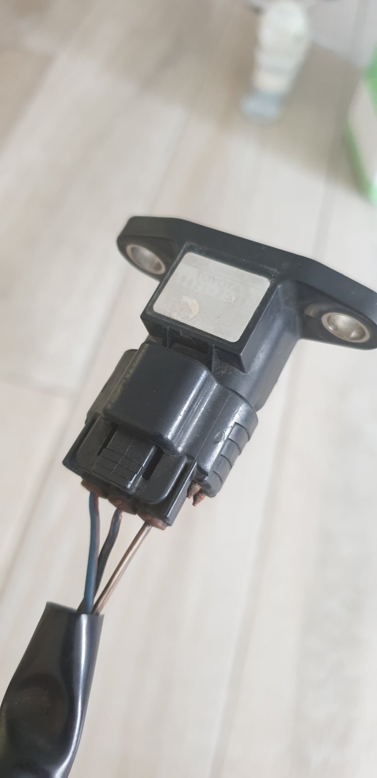

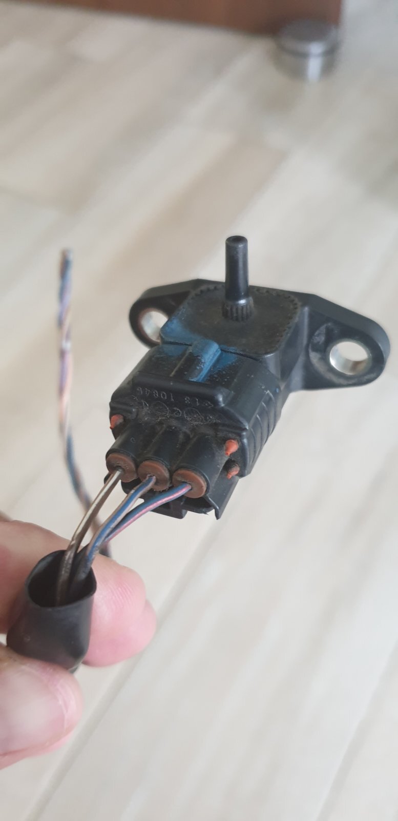

I need to know exactly the pinout for the MAP sensor on 1hdfte.
There are 3 wires:
- blue/red, wich on diagram it has a note with VC
-pink/blue, on diagram is noted with PIM
-brown/white, noted with E2 on diagram
I presume that blue/red is 5 Volts suply, pink/blue is 1 to 4.8 V signal emitted by sensor and brown/white is ground.
Is there anibody to confirm or to help with an advice regarding this pinout?
Pics for attention!
