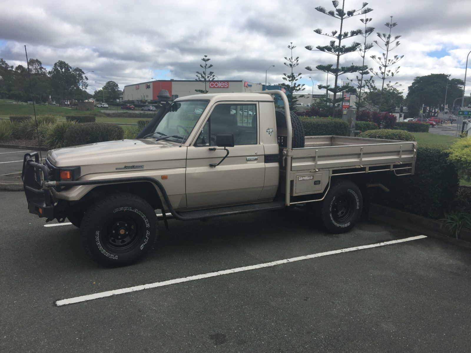

This is my new (old) LC
I haven't taken it off-road yet as I'm currently going over the beast to make sure everything is ok and up to the task.
I'm putting in a heavy duty clutch next week, and after that I'll do a rebuild on the swivel hubs and add new wheel bearings all around. I'll do all new oils and filters etc whilst I'm at it.
Eventually I'd like a rear locker, but for now just want to get it all serviced and up to speed.

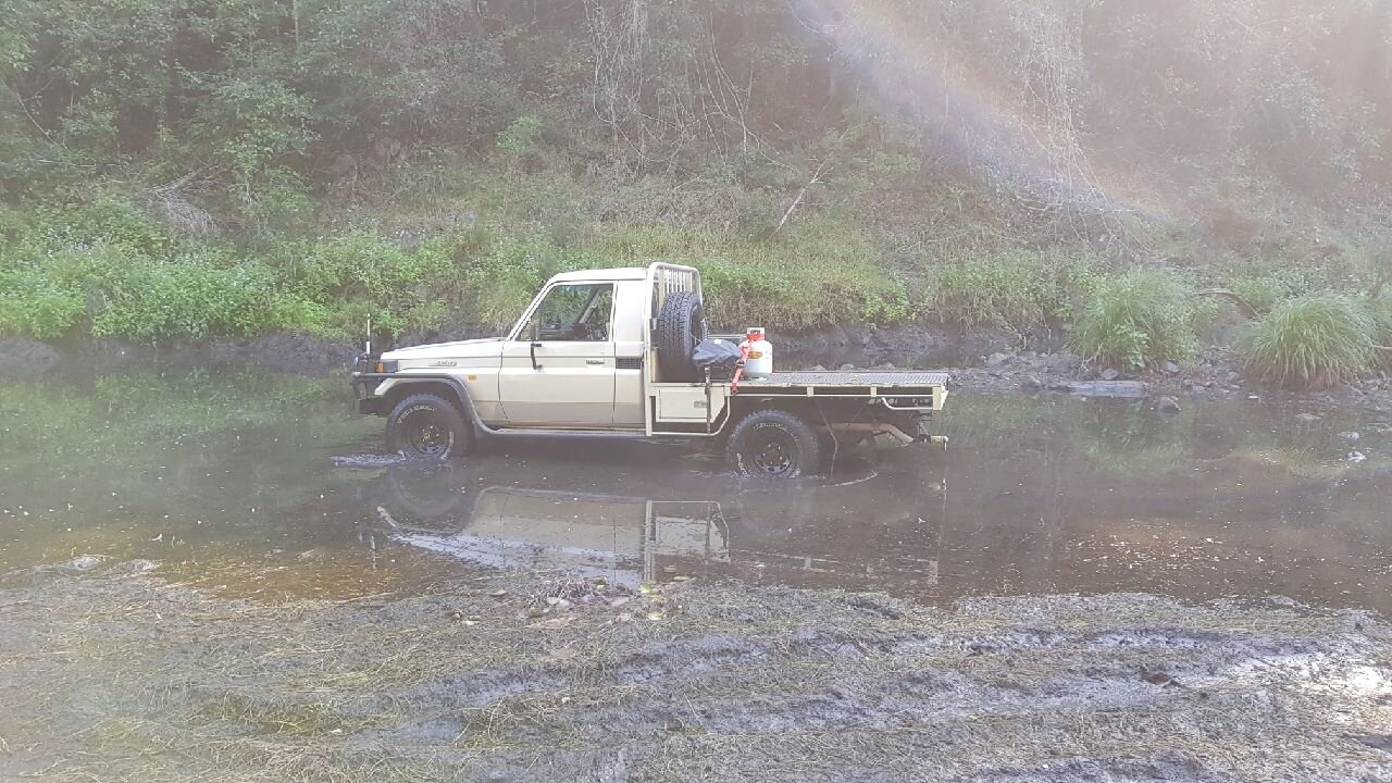

Well I must say I'm really impressed with the NPC clutch, I went for a 4wd today and unfortunately the track was severely washed out. We pushed on but it consisted of allot of rock crawling, allot of the rocks were loose and about football size scattered all over the track. To top it off the track was steep, to steep to stand at some spots. It was a bit of a scary run but we were committed because the terrain dropped off to one side, no turning around.
I had to feather the clutch for hours, it performed flawlessly and as good as everyone says. The feel is heavier than normal but nothing compared to a usual heavy duty clutch.
I rate it highly after today, and as I was the only one who clutch didn't stink proves that a heavy duty clutch is worth it.

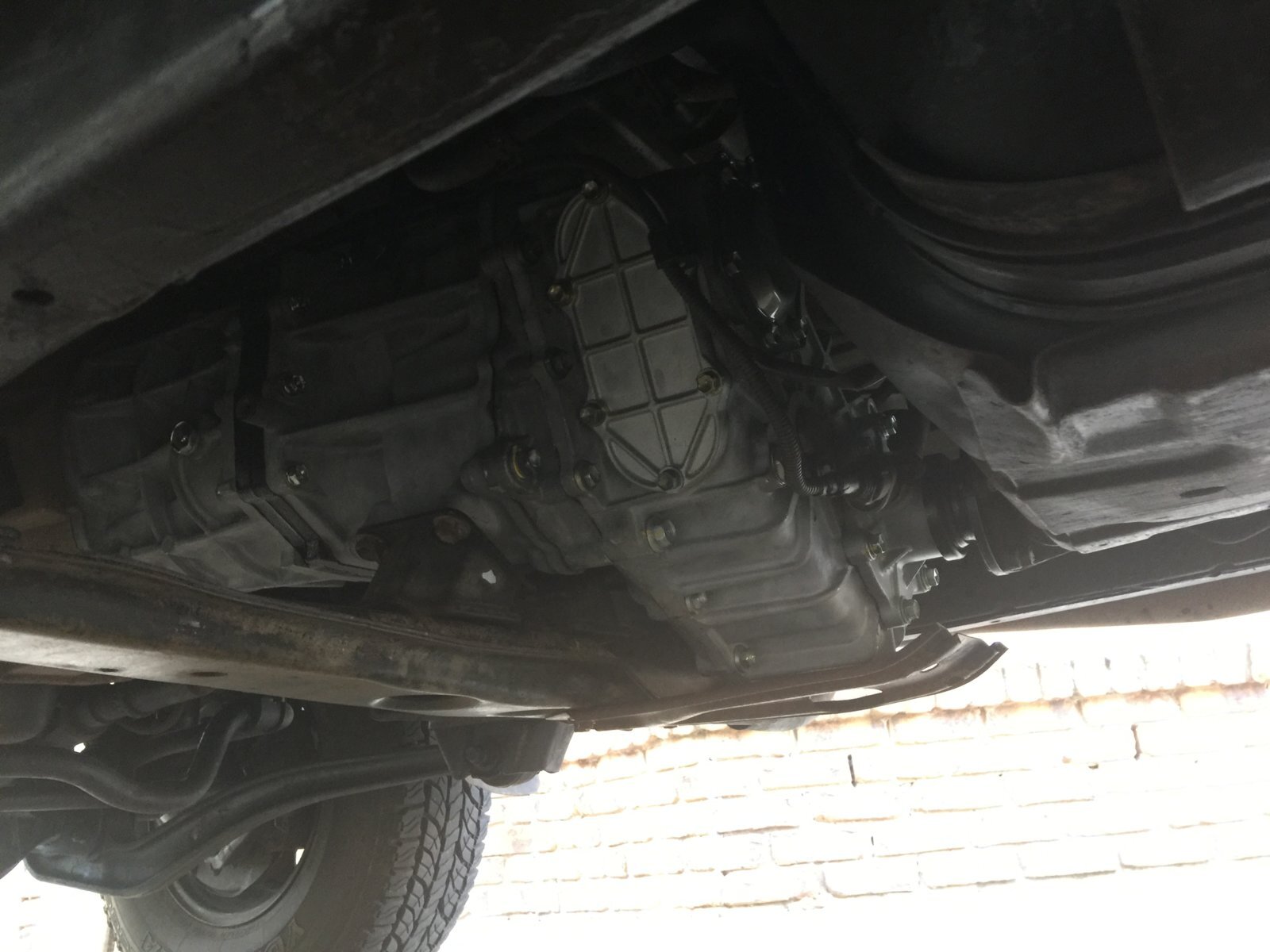

Well I put a reco gearbox and transfer case in my LC, all is good with the ol rig again. I got a modified box, one piece main shaft and upgraded gears with full teeth. Feels good, goes good.
Here's where the gearbox decided to strip out, talk about a crap day getting it out of this freezing muck. LOL

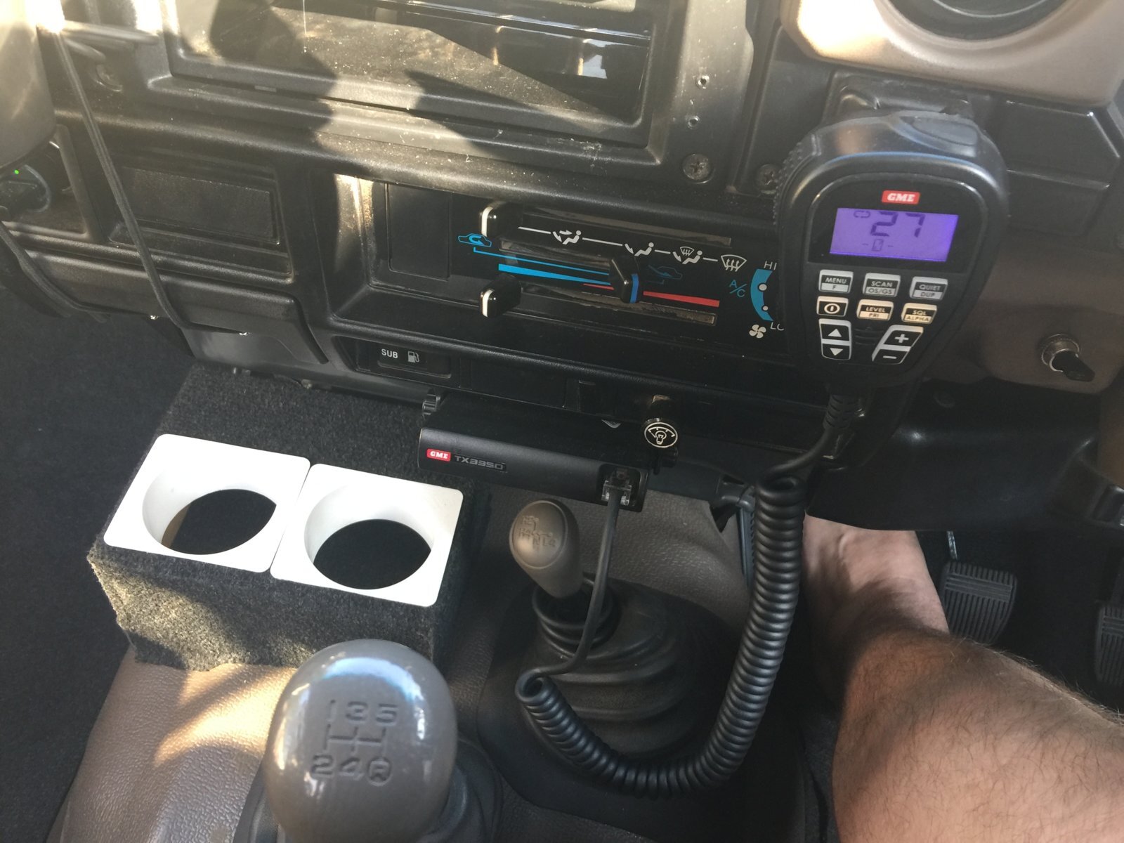

Oh yeh, I've installed a new GME UHF 3350, a new light bar and 2x7" spotties as well. I also installed a new kenwood radio with Bluetooth etc.
Old Cranky (kids named it) is about as modern as she'll ever be.

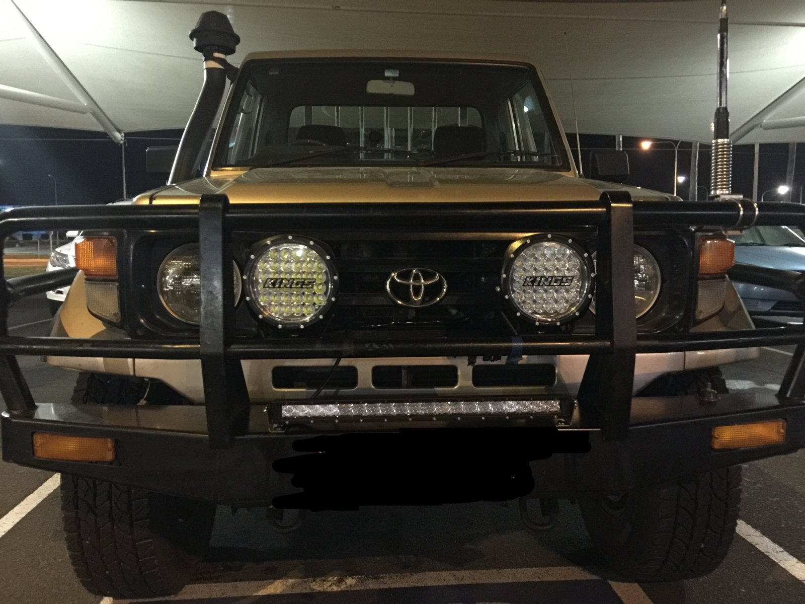

Here's a pic of the new 7" spots and light bar. They're only cheapies, but man they work sweet.
I did a quick photo edit and blacked out my number plate, looks a bit dodgy lol

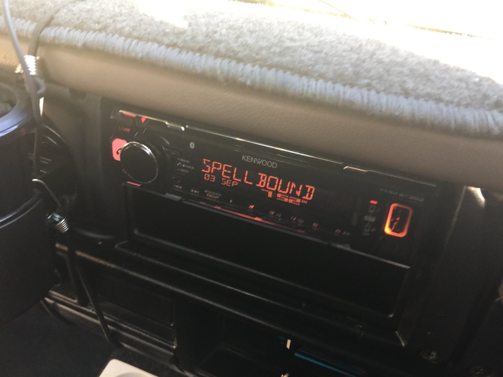

I put in a new stereo and speakers, also a new 80 channel uhf. As you can see, I also made a cup holder set lol . Got sick of having nowhere to put my coffee.

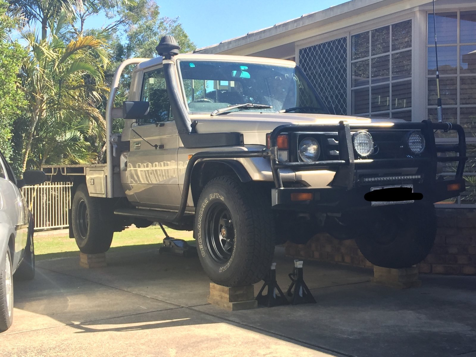

Here's one of 'Ol Cranky' up on some blocks I made to rip the broken guts out. They'll also come in handy to spray the bottom with Inox before a beach run .
With summer just around the corner down under, I plan on plenty of beach runs.
