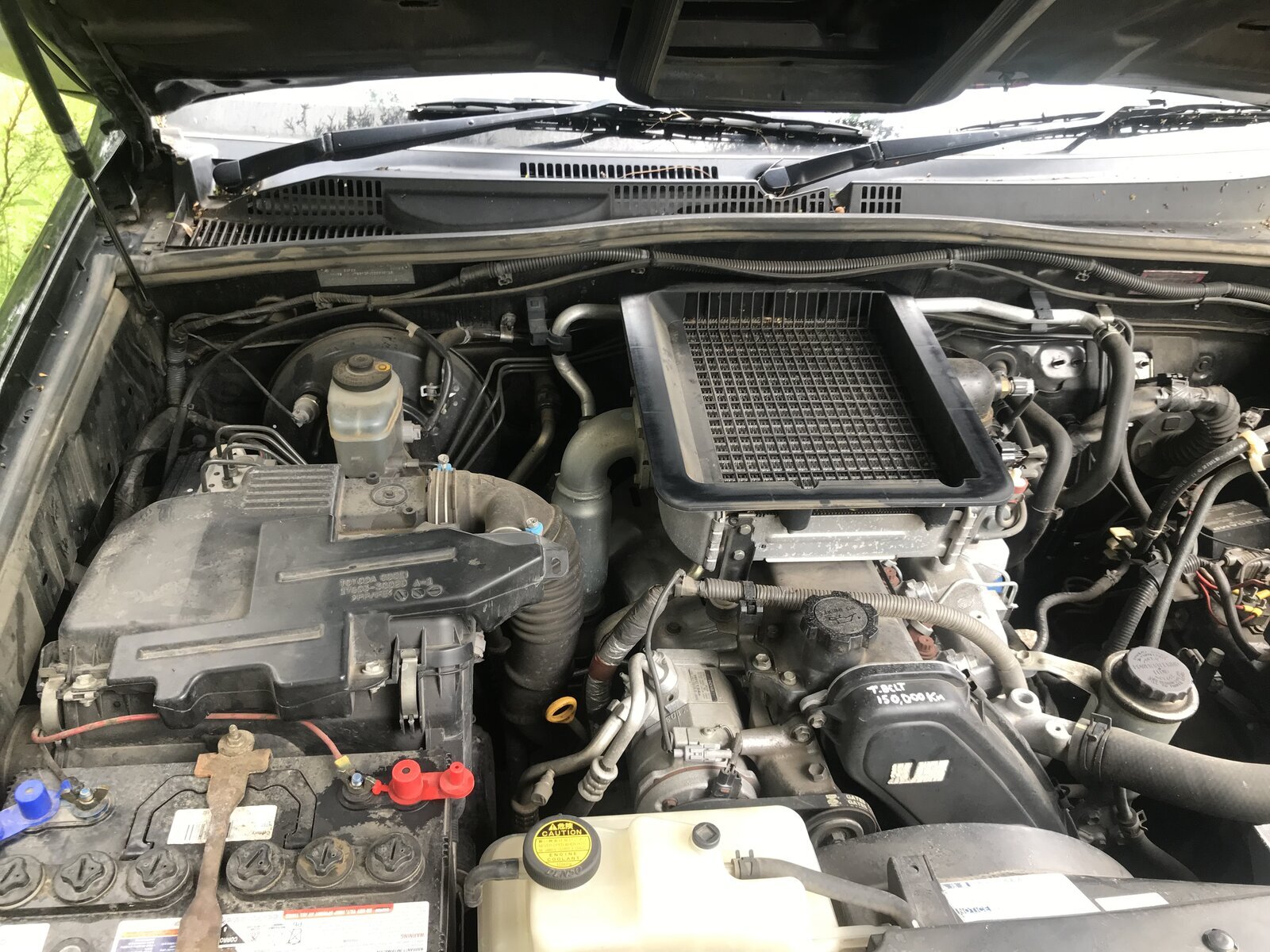

Juddian, here is a photo of the engine for you. Cheers

Eat your heart out peoples.
Look at those injectors, can't leak and carbonise the oil leading to engine destruction cos they're on the outside where they should be, the slightest seepage will be instantly noticeable, no more difficult to remove than a set of spark plugs for cleaning/overhaul when the time comes.
I must be getting old, can't remember now if my 70 with the 3.0 litre had an intercooler radiator on top, i'm inclined to think not.

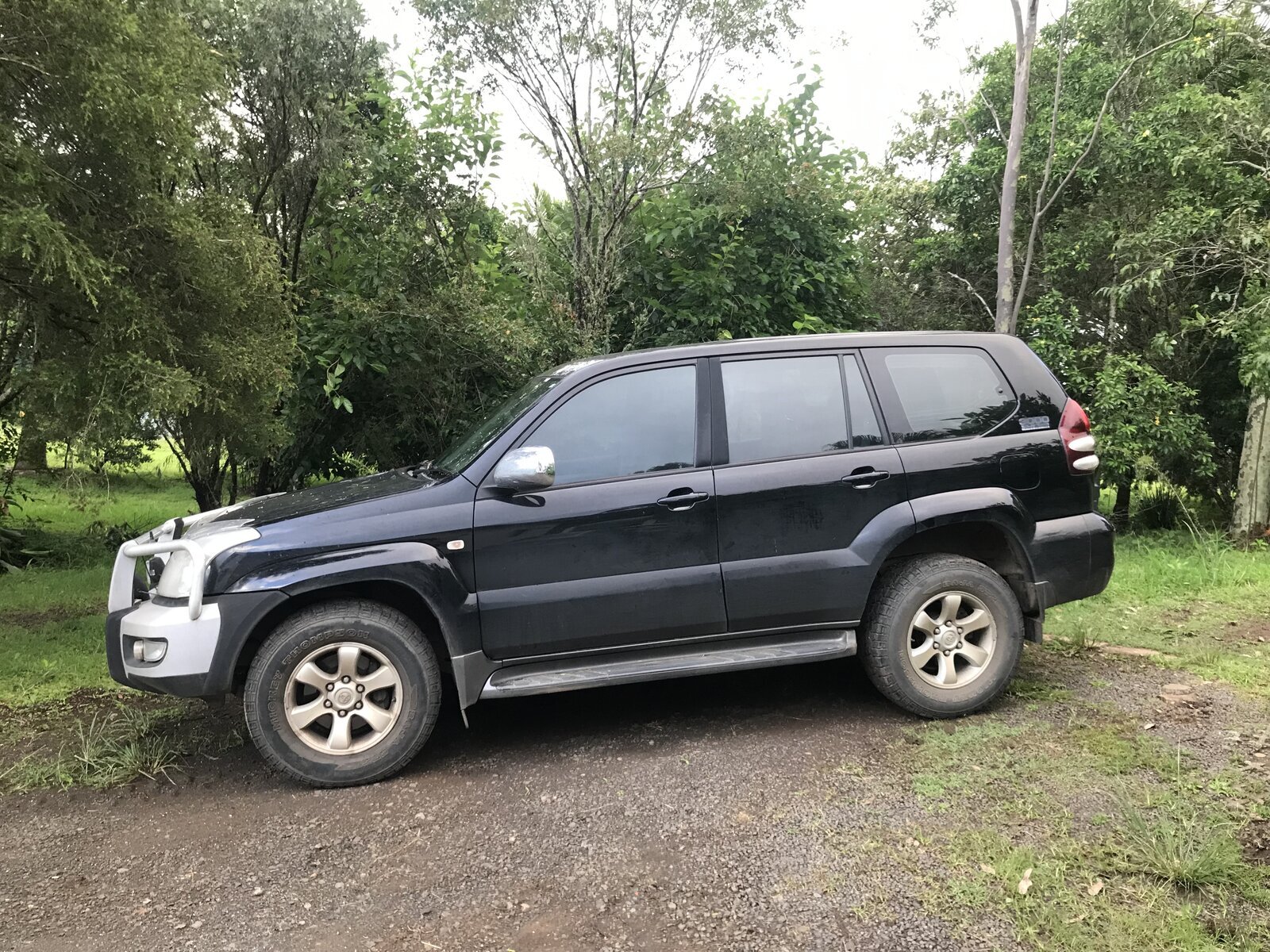

Photo of my LC attached. The more I’m learning about it the more I love it. Thanks for all your time on this.
