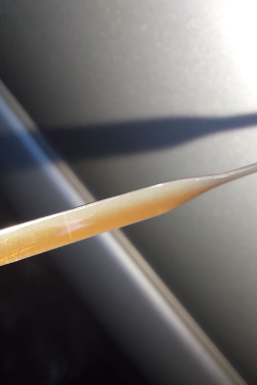

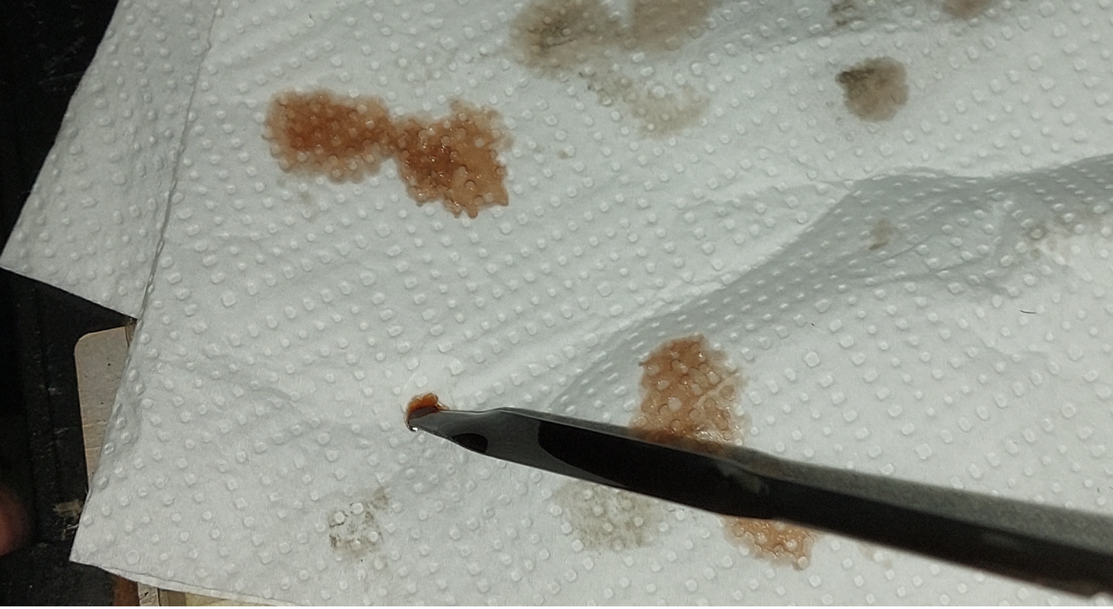

I've been doing some more research regarding the coolant loss and I read about the problems with coolant loss on 90 series with automatic gearbox. Apparently there is an ATF cooler inside the radiator (part of the radiator?) which can get punctured and the coolant starts draining into the autobox. Is that correct?
I hope my coolant loss was connected with system air bleeding and not coolant leaking into the autobox... I mean, I have a new radiator so the problem shouldn't be there.
Now I am concerned about the previous radiator which was in a bad shape (but wasn't leaking, according to the mechanic) and we didn't check for the punctures on the ATF cooler back then. Maybe the mechanic checked for ATF cooler punctures/checked the ATF but I'm not aware of it. I assume that ATF leaks from the hoses a little when you unhook them from old to new radiator? Mechanic would have probably seen the unusual ATF color/density if something was wrong with the old ATF cooler? Could somebody tell me where the ATF dipstick is on an EU spec 1kd-ftv with LHD?
There is a water to oil cooler for the ATF in the bottom of the radiator. You lose a little ATF when changing the radiator, your mechanic should have checked the levels when commissioning the new one. I would think he would have spotted water contamination at the same time.
Update:
I checked the ATF on dipstick and it seemed very clear, red and oily, like it's supposed to look. Not milky at all. I hope I don't have any water in my autobox.
Pictures of ATF condition (looks orange on the dipstick because of flash on the phone camera):
Thoughts?

Mixed coolant and ATF appears pink in colour if I am not wrong from reading online stuff.
I dropped some water in the atf while changing my radiator the other day, it goes sort of milky. That looks like clean atf in the pics I think.
I read "milky" as lacks transparency , so i guess i'd investigate with a glass ?
Since you've already replaced the radiator, why not flush and replace the ATF for peace of mind? Not a big job and not expensive if DIY.
