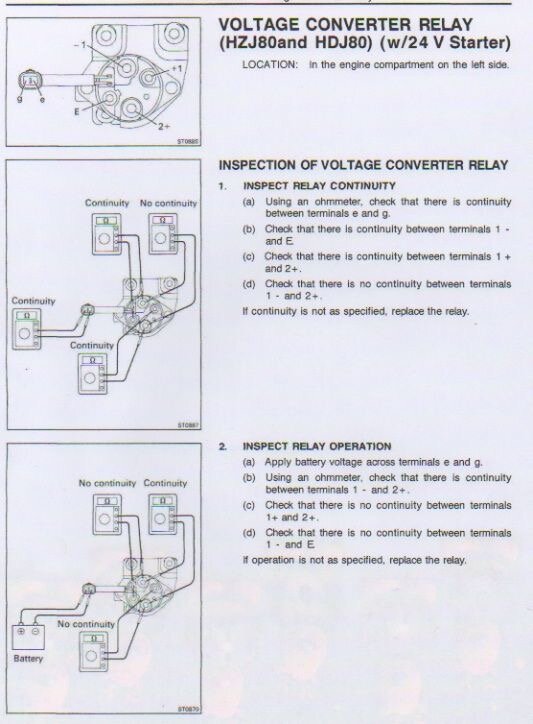

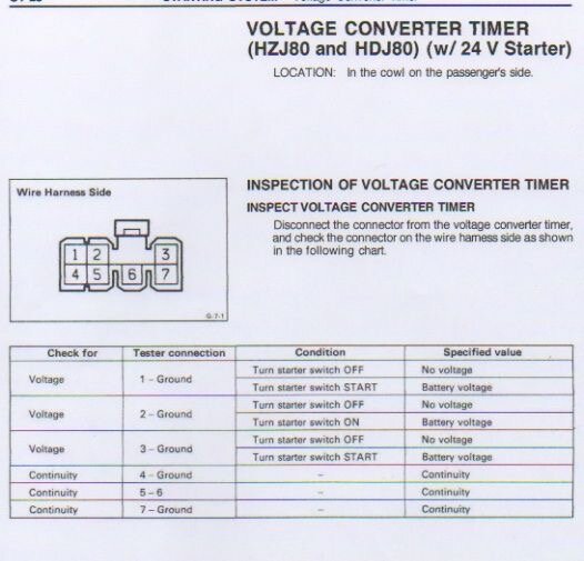

Had similar on my GS, had clicking or no clicking when attempting to start. Imob (aftermarket) would beep and flash. In my case it was the 24V voltage converter relay, had been working fine and packed in with no warning.
Slightly back and lower from the passenger battery is a black cover with one Phillips screw in it. It's underneath the cover. Easy to check with a multimeter.
I dont think this is anything like thw standard one.. I have an air filter just behind the aux battery
