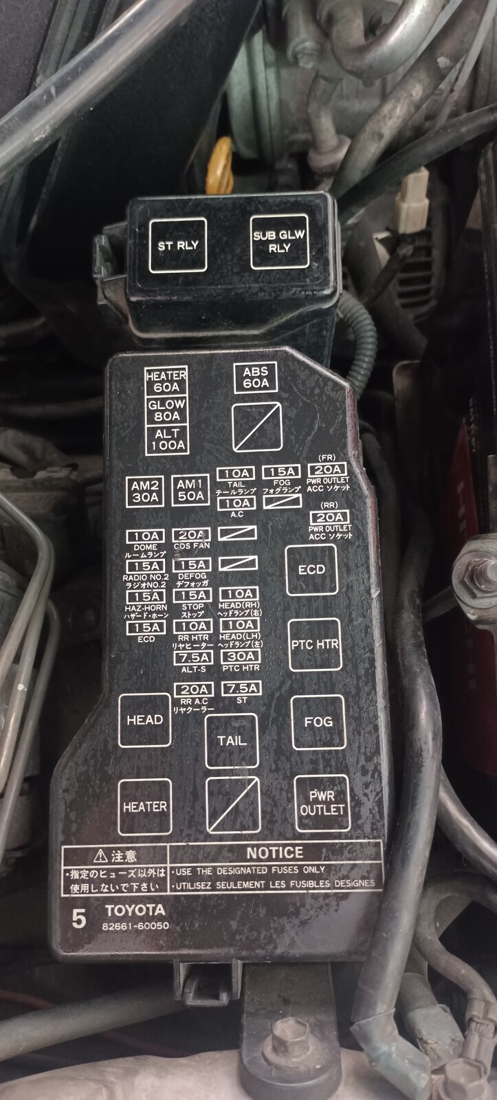

This fuse box right? Which of these are the fuse for the cigarette lighter?

Okay thank you so much for your help, if let’s say both of the fuses are good.
Does it mean the cigarette lighter outlet is bad? If so what can i do
