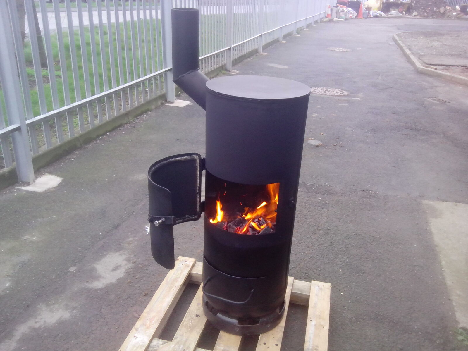

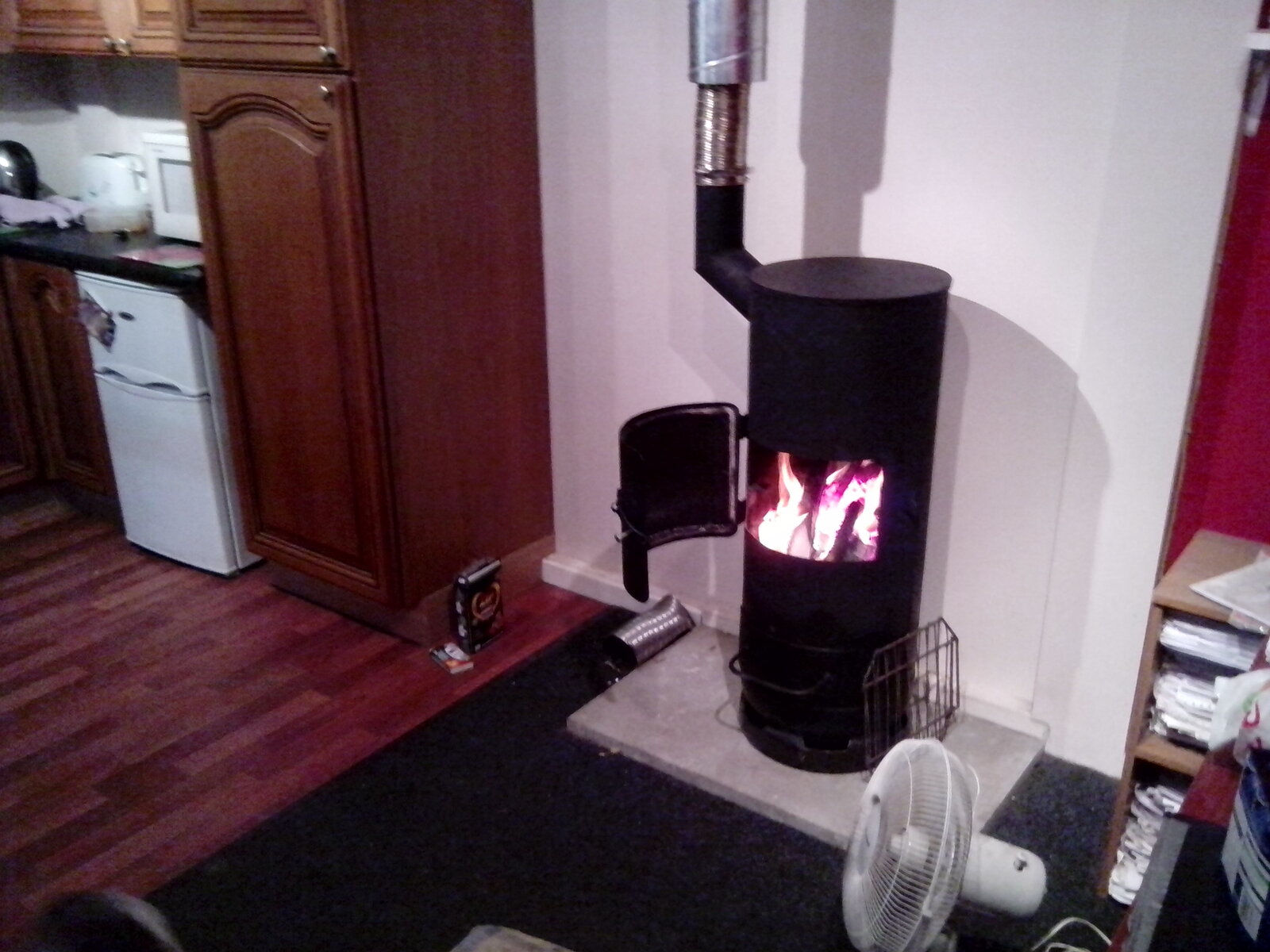

Was getting a little cold in the office and had no way to cook food beyond the microwave... Welcome Office Pig!
Got it installed on a 4" home made twin wall flue and the draw is so intense that it burns far too hot. Roped around the ashbox tray now and it's cooled down nicely, had an all night burn last night.

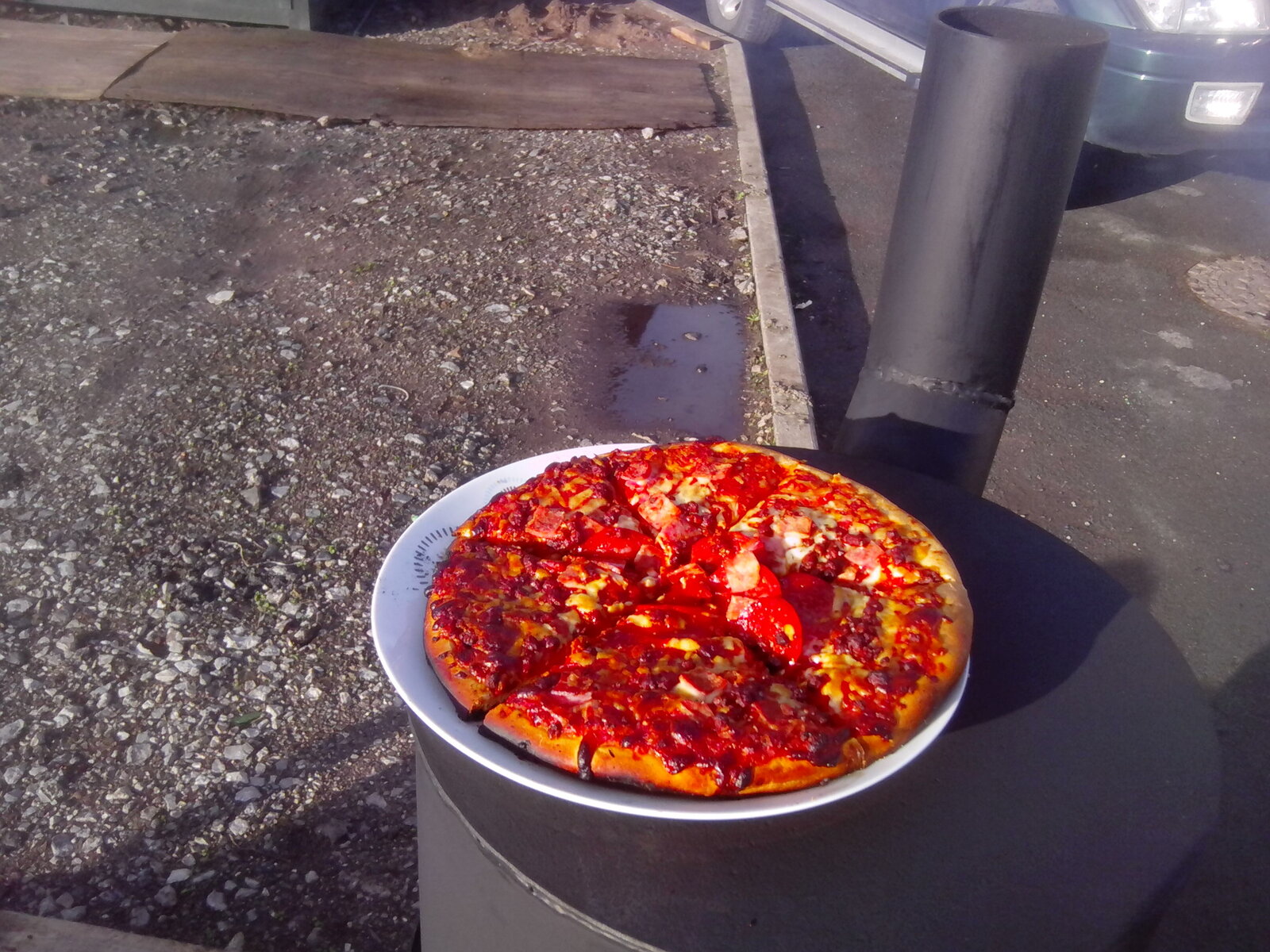

Pizza!

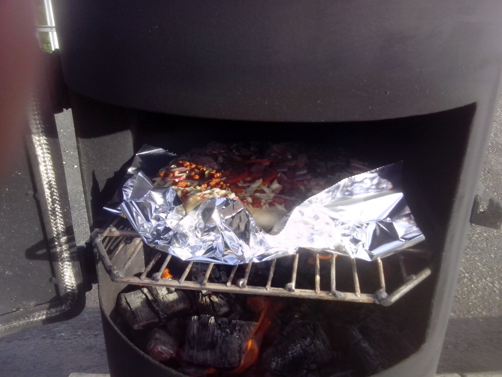

Cooks better now it's damped.
Toasty.

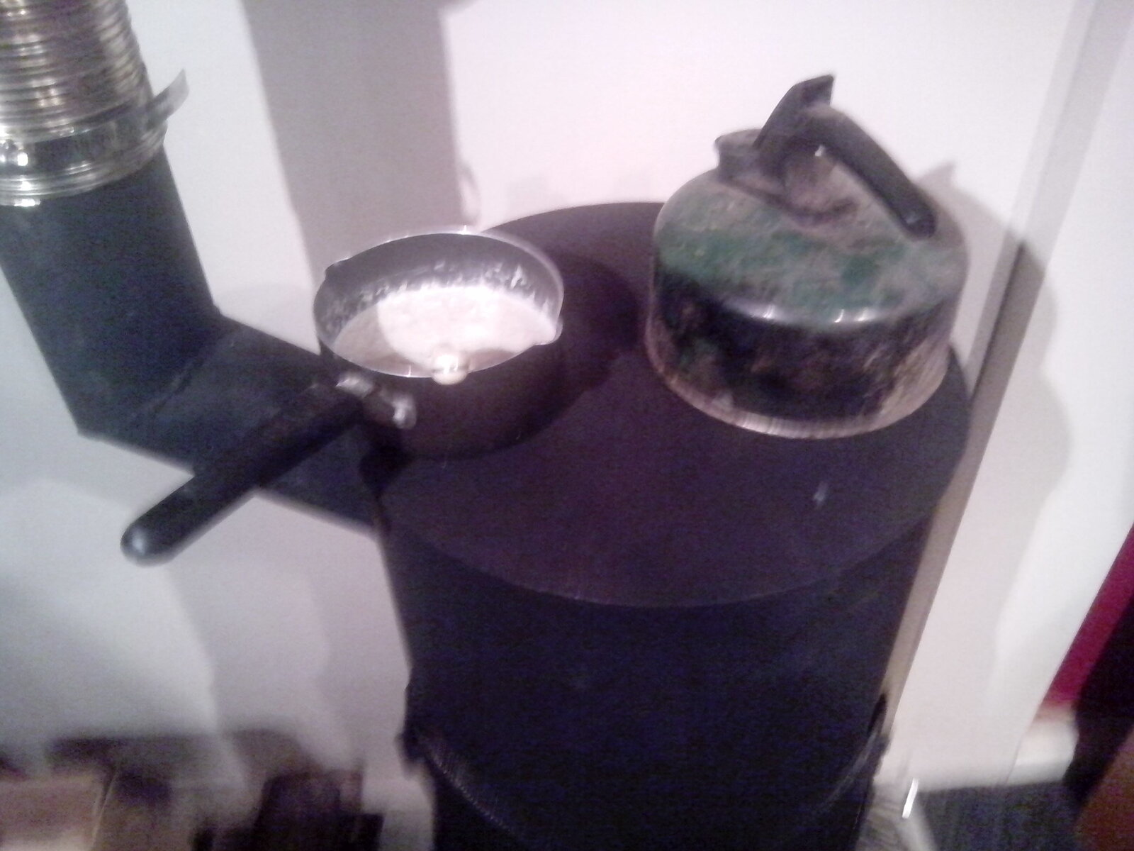

Anyone getting hungry? does mean baked spuds! I should be able to use the top oven I built for the tent stove too... anyone for cakes?
