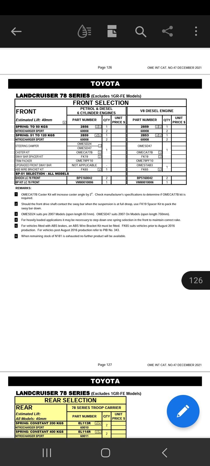

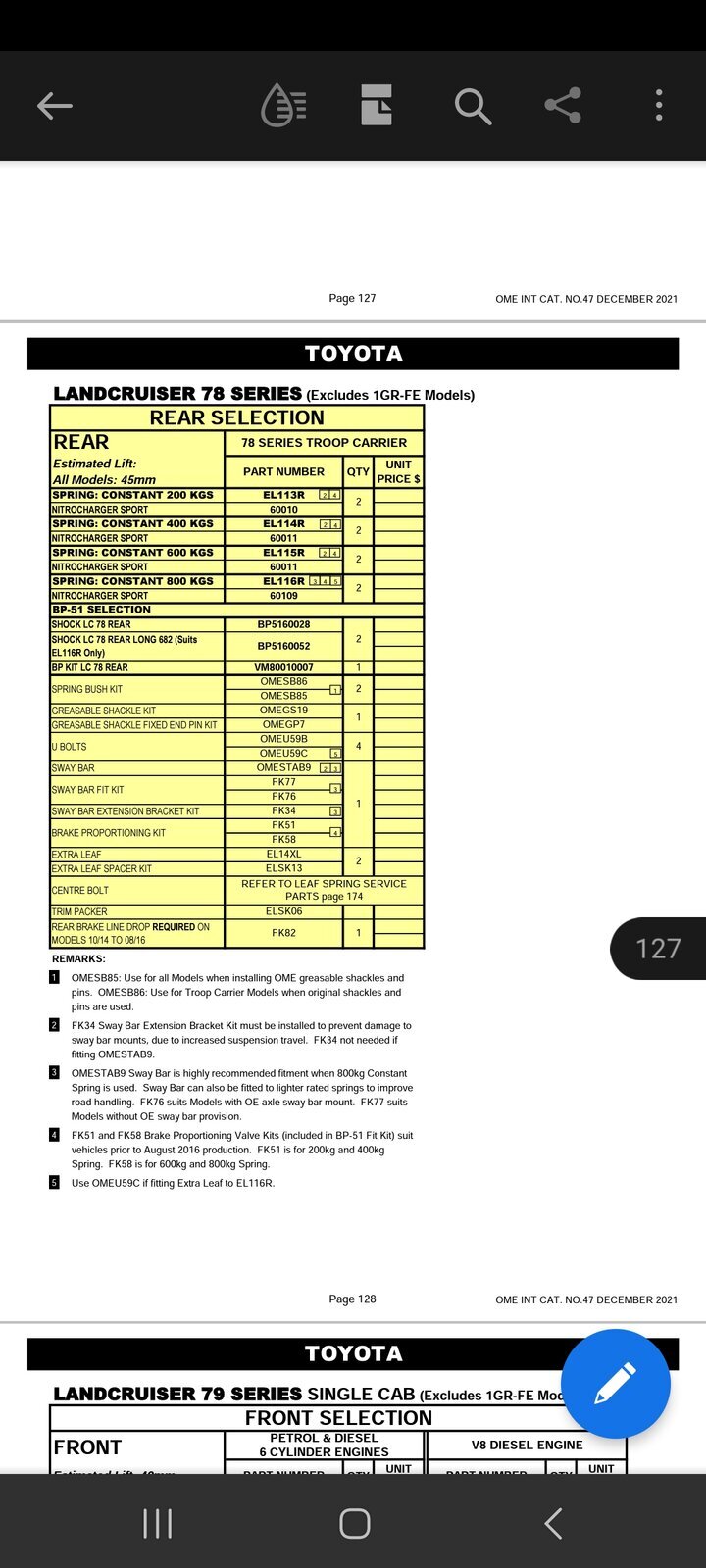

Good day all! I have a 94' Prado here in California and was wondering if anyone could tell me the part numbers for a full upgrade to my suspension. I would like to keep the 2" lift or even upgrade to a 4" if possible. I have attached the parts list, but I want to make sure I'm getting the right stuff. As of now I have a 2" ProComp lift which is just spacers, but like I said I want to do a full upgrade.

A side note... Take a look at toyodiy and punch in your vin number to get the Original Toyota specs and models, you can then work back to see what pieces of what are needed.

For the suspension, you may want to calculate weights and if you want to go over the original spec. 50kg isn't a lot, is that what you are looking at?
Finally, why do want to 4 and not 2 ? Even with 2 you can get fairly chunky tyres and the approach angle isn't terrible on these vehicles. With 2" you can likely get away without panhand, swaybar, arb recable, camber correction etc.

The lists don't cover the 78 prado, for the correct list you need lj78/kzj78 it will lead you to the correct parts.
Hey Kent, thank you for the information. I am completely okay with a 2" lift and was just checking the options that are available. As for EFS, I do not see that they offer anything for a 94 Prado (KZJ78). I'll keep looking for OME parts that fit OG.
