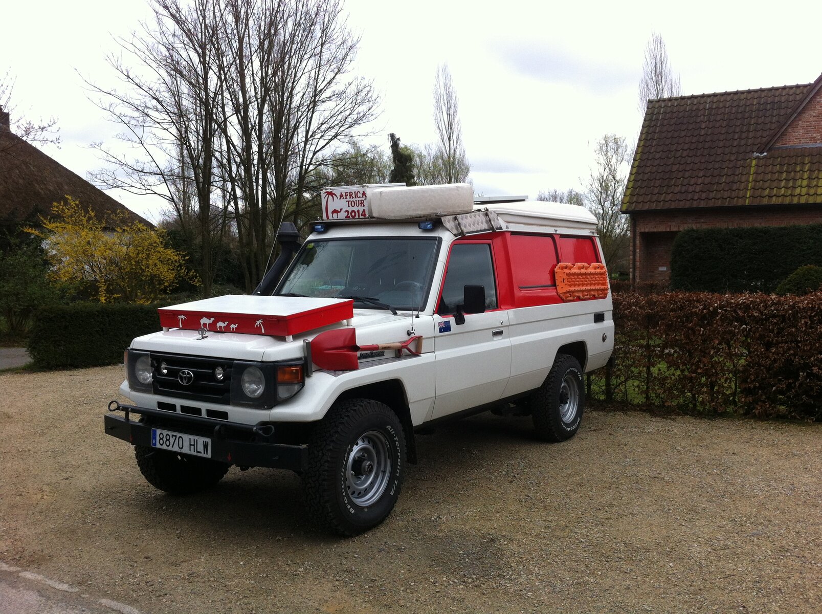

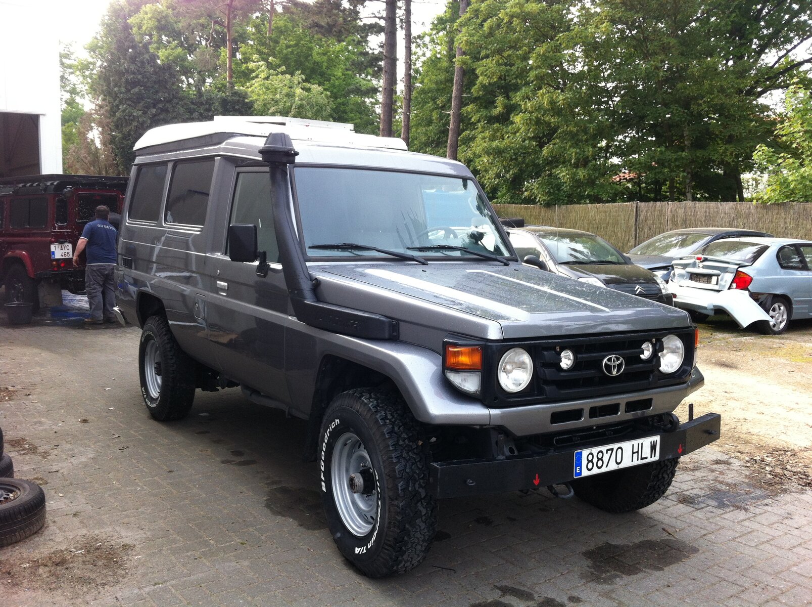

Here is a pic tof my brand new XZL in 8.25r16 next to my worn BFG MUD in 255/85r16
And fitted to a troopy:
(can't post pictures inline yet... too new here :-( - See attached images )
