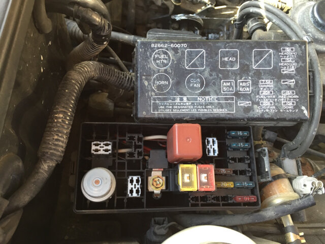

I have checked all fuses, replaced cig lighter fuse.......nothing.....any idea,s
Try the 'dome' fuse in the rectangular fuse box under the bonnet.
Thank you Star Cruiser, where can I get this type of fuse from, are you in the uk.
I think it's just a blade fuse from memory. Think it might be a red one. I'm not near the truck to look but it's pretty obvious.
Bottom right, 10A standard size blade fuse. Check it and see. Does the radio and interior lights on mine but not the cigar lighter socket.
Yes yes yes....... Thats it...............sorted
thanks very much.
