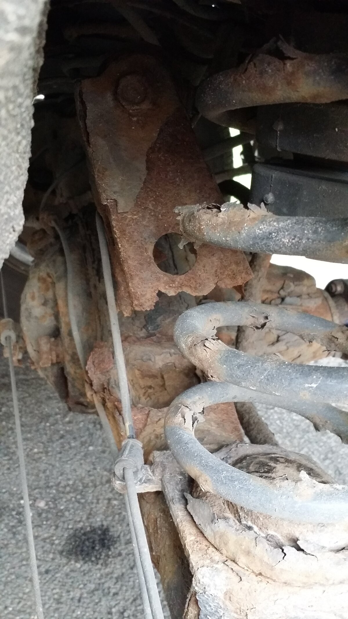

hi guys, not been on here for a while. been hearing a knocking comming from the rear of my LC90 over the last few weeks and thought it sounded like the ARB drop links. Went to change them today to find one of the upper toe arm links has snapped off the axle. Does anyone have a rear axle or know of any that will fit? Hilux Surf maybe?
This is the offending part.

Not sure about axles from other vehicles the surf ones probably compatible but there is a difference between the diff lock and non diff lock versions also abs/non abs. Milners have new casings available for just over £500 which isn't too bad imho
http://www.milneroffroad.com/toyota...kzj95-axle-frontrear-1/kzj95-axle-case-rear-5
I had the same failure on mine, bought a 2nd hand axle which was also pretty bad so took it down to my local engineers and got them the strengthed/repair all the axle mounting points
