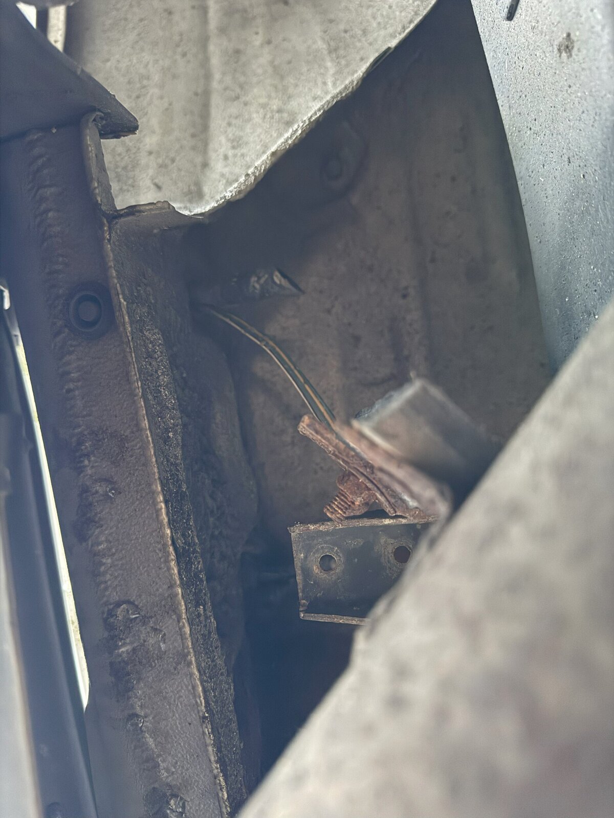

The tow socket is an interesting deal on this cruiser. It's a 4 flat marked OEM Toyota that comes directly out of the right tail light. None of the wires were damaged and look is like new condition. I thought it was odd that these four wires molded together would come from a taillight from the manufacture and not plugged into the harness. Is this actually the way Toyota did their simple trailer wiring?
I will snap some pictures of what I have and run some tests on that plug. I may tear into the taillight as well if I get the time before reposting.

Apologies! Please see attached pictures. No tests performed yet, I had to go earn a living today.... But I did get some pictures on the way out the door.
The trailer plug does NOT go into the right taillight. It goes into the body and to hell and gone from there. :tearsofjoy:
