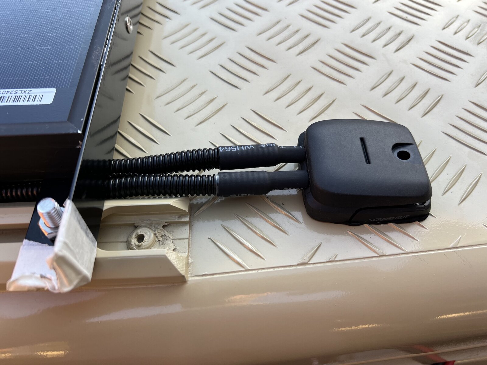

I'd just use a scan strut gland and then go down the a-pillar to the firewall grommet.
