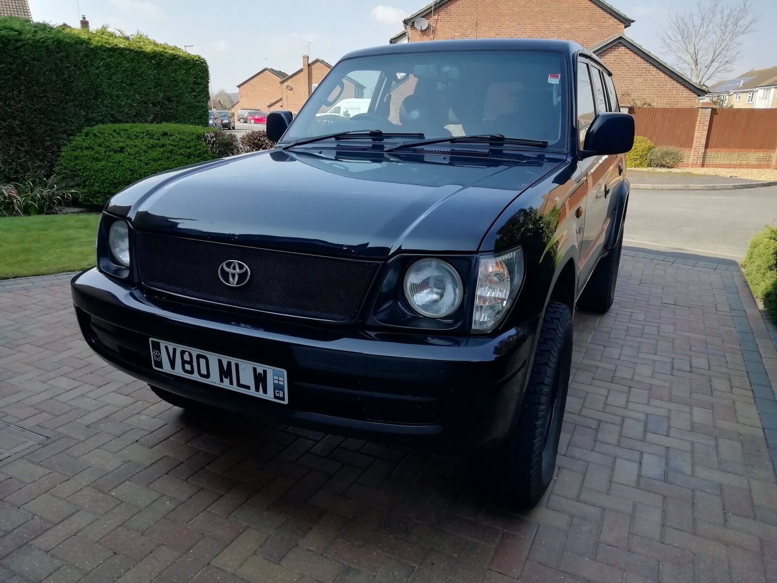

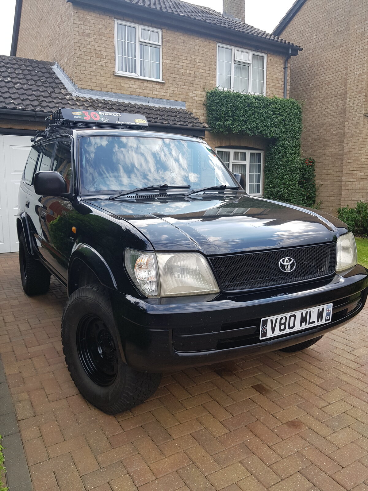

I have always preferred the look of round headlights over the square ones on the 90/95 series, so when the opportunity to get a set popped up, I decided to take it. They were extremely easy to install, tasking less than an hour to swap over. I am pleased with the look.

@Bert do you retain the control of headlight angle from the cabin and was it easy to set them up for left hand drive and alignment?
@MikeJak I fitted the round headlights and there is no automatic/in-cabin height adjustment available, only manual with the adjusting screws.

Thanks @Bert , did you have the headlight adjustment in cabin on your cruiser with the original lights? (I think it was introduced with the facelift later model) would be nice to maintain it if I can…

Hi @MikeJak
My old Prado doesn't have the adjustable lights, but removing the old square lights and putting the round ones in was no bother. Without touching them at all, the round ones slipped straight in, no re-aligment necessary with the ones I received (mine is right hand drive). Nayab is a great man to purchase from, I have no qualms about buying from him.
