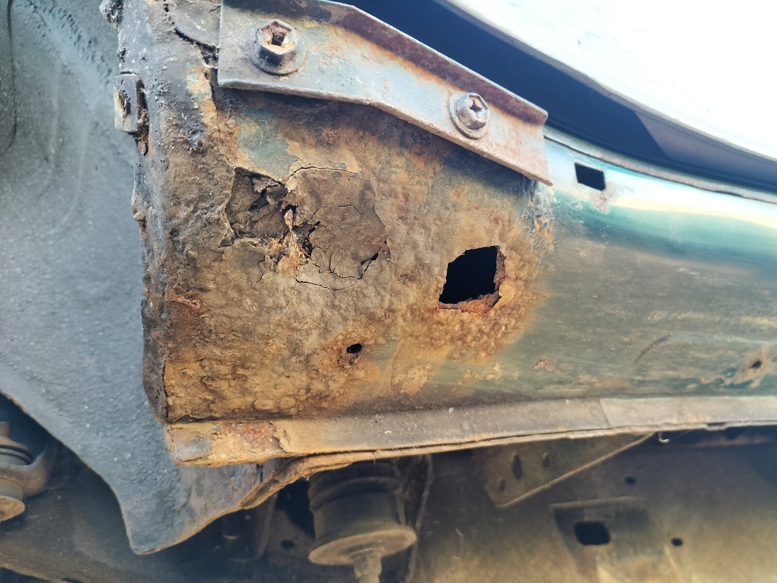

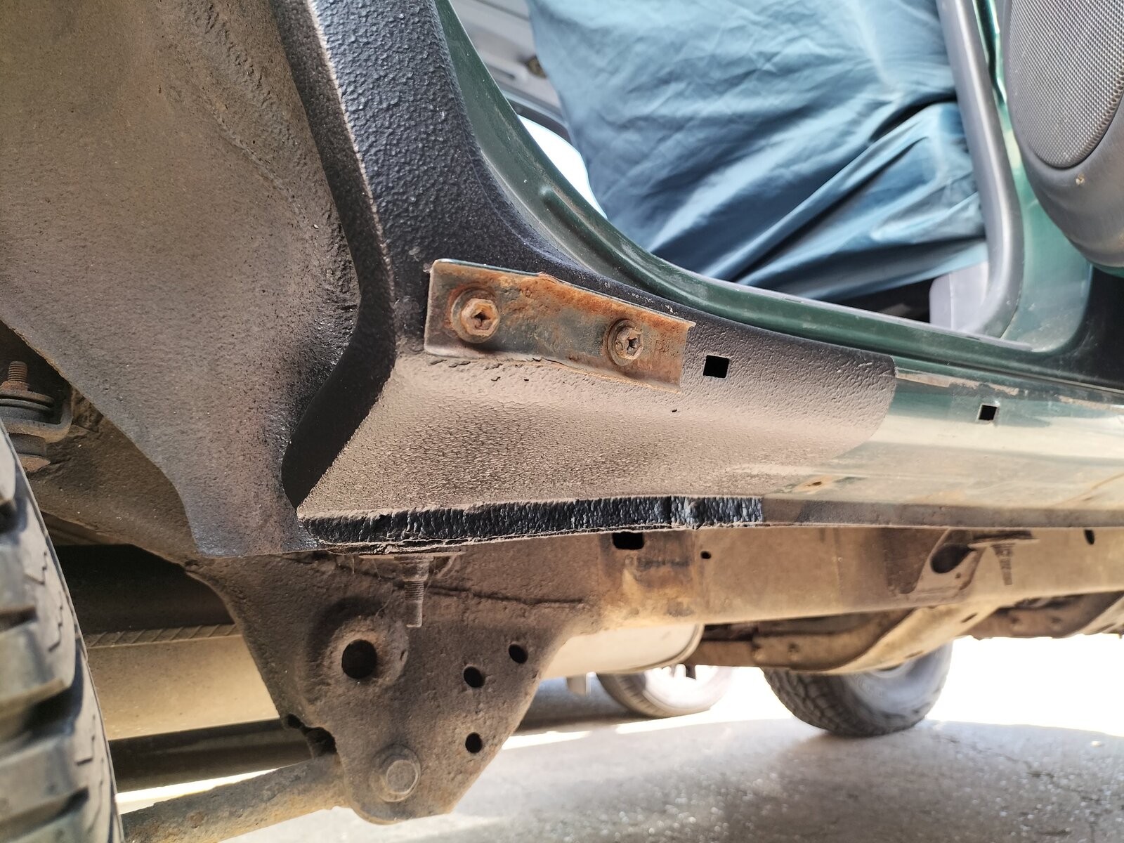

Good luck Bob. Mine is in today for a bit of patching up.
Edit: And a few hours later, job done.

@Bert - Good job there. Looked bad enough, have you a pic at the stage where you had the old metal cut just? You just had enough good metal left at the top of the sill to weld to yeah? What's the bit of metal bolted on with the 2 bolts for?
Hi Mister Cruiser. My local body repair shop did it for me. He had to cut out the bottom section completely, and yes, there was just enough metal left enough to weld to on the underside of the metal plate. As long as it lasts for a few more years, it will do. The plate is there to support the sill moulding that normally covers along the bottom of the doors.
They repaired the other side in the same spot just over a year ago, and it is still looking good. So, fingers crossed.
