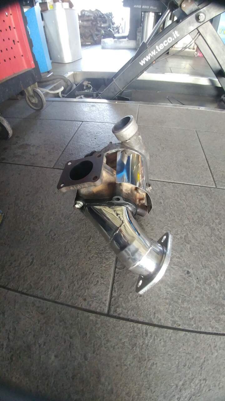

While you guys are looking at all this i'm not having much luck finding a 3" dump pipe for the CT26 so if it's got to come from Oz maybe i could chip in with shipping costs .
Shane any custom exhaust shop can made you one ....thats what I did personally just need a spare turbo for them to work off.
