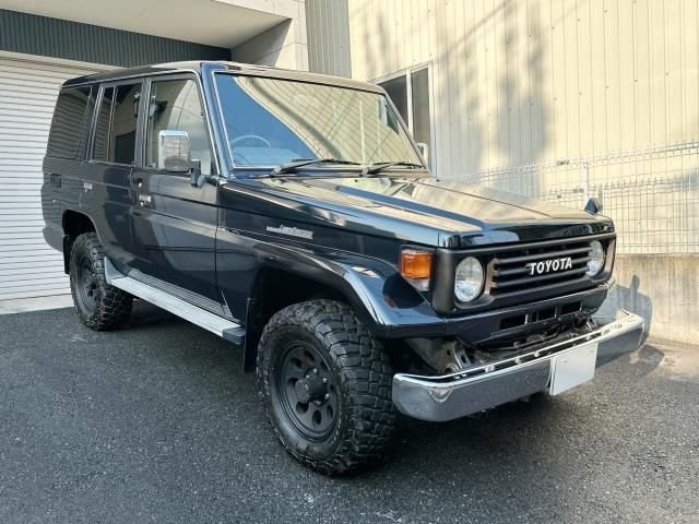

My search was interrupted when i posted the one above , I was actually looking for a factory 4.2 turbo 70 series which I'm sure I've seen somewhere in the past but can't seem to find ?
Ah right, I wondered what happened! Was that the 1HD? I'm not entirely well-versed in Land Cruiser engines!!
