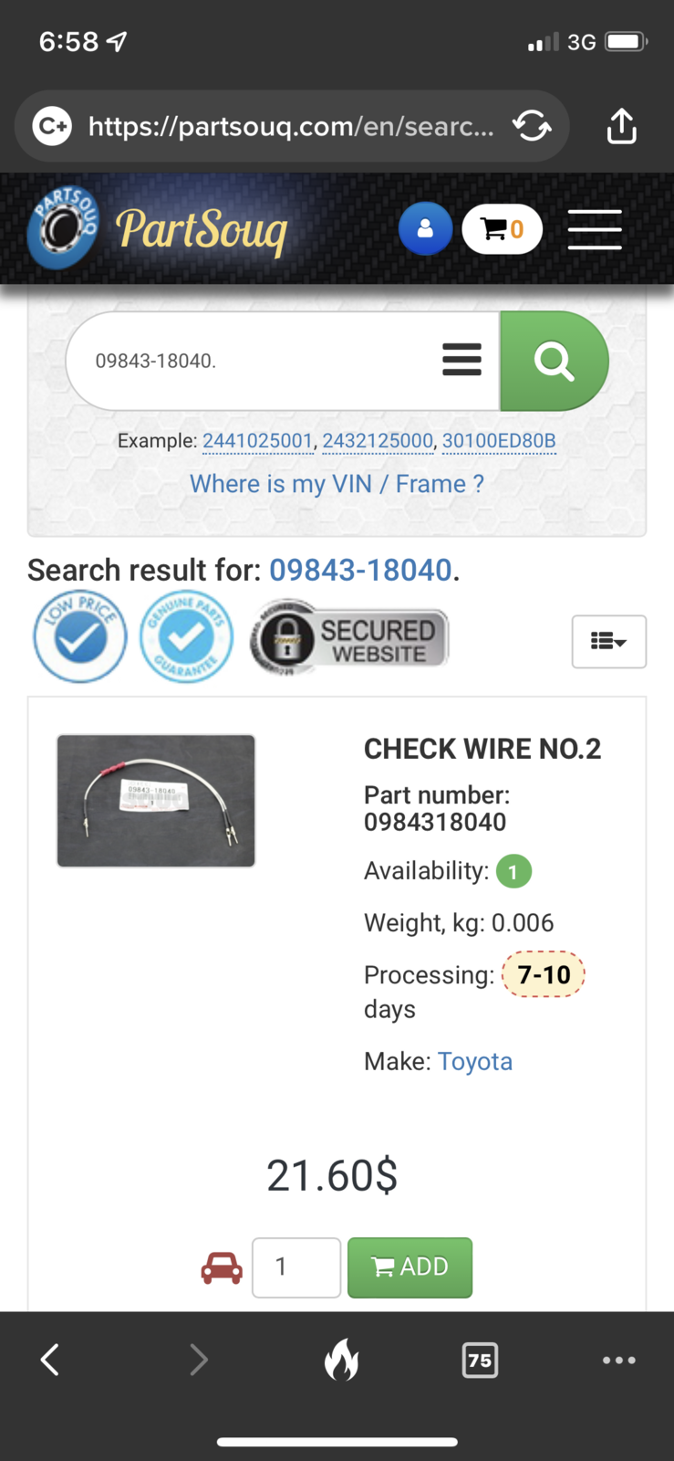

Not sure what this is for and can’t help you on that but it’s available here.

Only reason I didn’t buy special tool is, it’s in $. sounds strange but I never purchased anything in other currencies so I naturally stop if it’s not in GBP. Now I have alternate to buying that tool. I can use any clip or wire.
