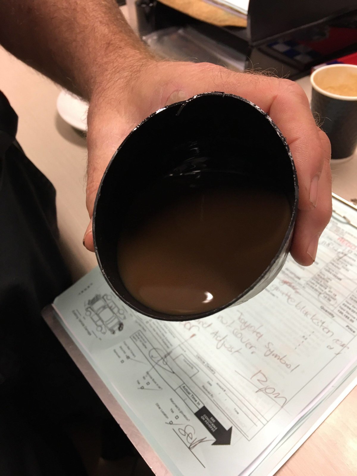

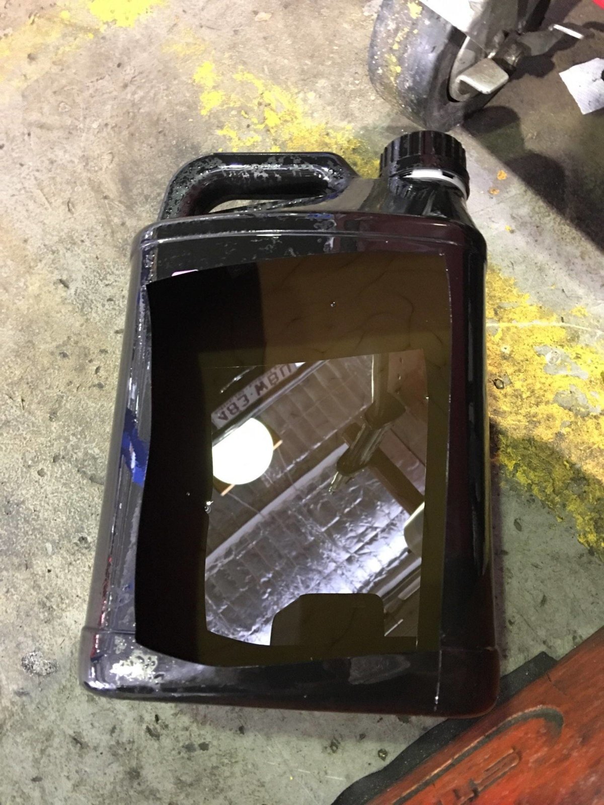

Looking for some information on possible ways that my transmission fluid could have got contaminated during a service.
The services was a 90 month or 150000km. The car has only done 85000km. In addition to the service the timing belt was replaced along with idler pulleys, tensioner, water pump and they sent the radiator away to have the top tank replaced due to a hairline crack in the top outlet pipe. Neither the radiator or water pump were leaking.
How could contamination of the transmission fluid have occurred?
Images of contaminated transmission fluid attached.
What exactly is the transmission fluid contaminated with?

It could have been contaminated at any point during the service, I notices the running issues when I drove it home. The car started to shutter and lose power whilst accelerating. It also clunked into gear a couple of times. They flushed the transmission fluid a number of times and test drove it and said the car was running fine. When I drove the car the next day I could still feel a shutter, loss of acceleration, slow gear changes etc etc.

How would the ATF be contaminated before the rad is removed? Is there a possibility that the coolant can flow from the radiator to the transmission? We are looking at all possibilities at this point in time.
In a rad with a leak between the engine coolant side and the transmission cooler side, yes there have been instances of this on other models. You specifically mentioned ‘during a service’ in the OP, hence the question to determine how you knew it was during the service. Turn this on it’s head and have the rad pressure tested while off the car to see if it leaks into the transmission cooler or vice versa.
