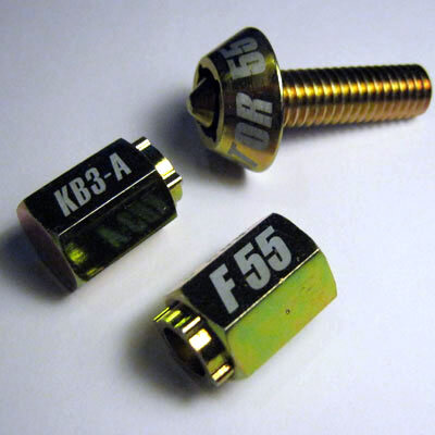

You can get these in the US but can’t seem to find anything like them in the UK.
[h=4]The winch lock bolt is a custom 3/8-16 precision security bolt made from 1045 carbon alloy steel heat treated to Grade 5 yield strength. The key patterned head bolt is proprietary and the matching key is not available at your local retail hardware store. The winch lock bolt cannot be removed with ordinary screw drivers, pliers, or commonly sold security bits. Simply substitute one of your winch mounting bolts with the “Winch Lock” bolt and your winch is protected – simple![/h] Fits all winches with standard 3/8 -16 mounting hardware.

Having given it more thought durring the day would the following work...
Use a wheel stud and press/hammer it in place in the winch and then use a locking wheel nut on the stud.
Yep that would work, provided you have enough room to fit and remove.
Might need to grind the locking nut flat though, otherwise it will only tighten down on the angled section?
