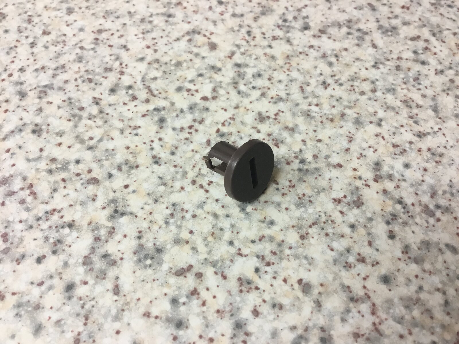

80 interior rear step nuts , I’m assuming they are something fancy and I can’t find them to buy ?

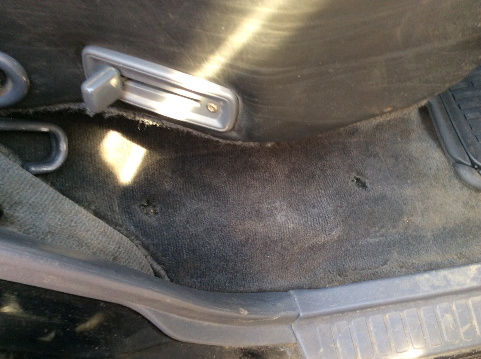

I can’t see the retaining pins that should be welded to the floor and protruding through the holes in the carpet in your photo Shayne, are they still there?
If not it’s a waste of time trying to buy the nuts, they’re plastic with a coin-sized slot in the top to spin them onto the “threaded” pins.
TBH it’s a waste of time getting them anyway, there’s almost no strength in them, I bought 4 for 2 quid, proving they’re not genuine, and the thread snapped out in them as soon as any pressure was put on them.

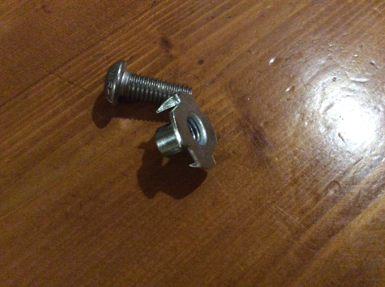

I’d go for some rivnuts in the floor and a skinny bolt with a mini penny washer.... must have a go at that myself one day...
Don't tell anybody but i was actually vacuuming the carpet when i remembered these so the studs are there and the carpet is just lifted . I got the steps with the truck but i've never seen them fitted .

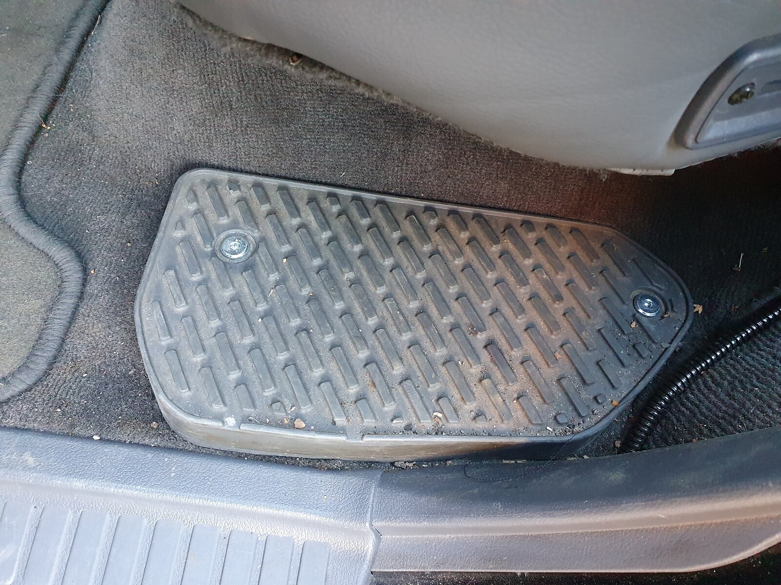

Says something that i want them tidy so adult passengers might be more inclined to respect the truck (keep things tidy) the toddlers take rubbish with them :crazy:

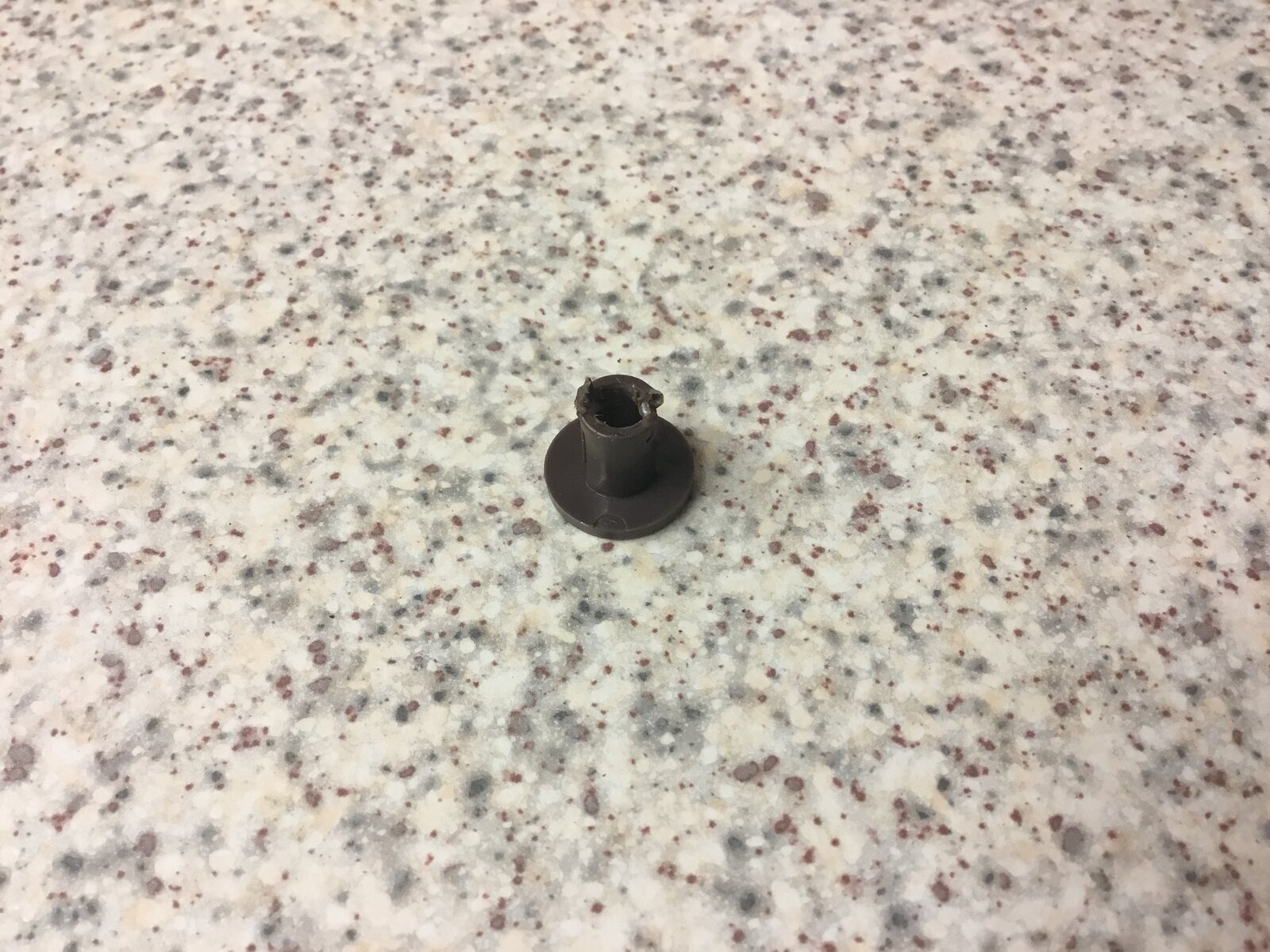

That's mine. They won't screw on that's why I put butyl in which holds them.
The plastic ones broke when I was having all the grief with the fuel tank and it had been apart a few times.
Needs a good hoover and general clean! Hasn't been washed for a couple of months!
