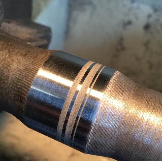

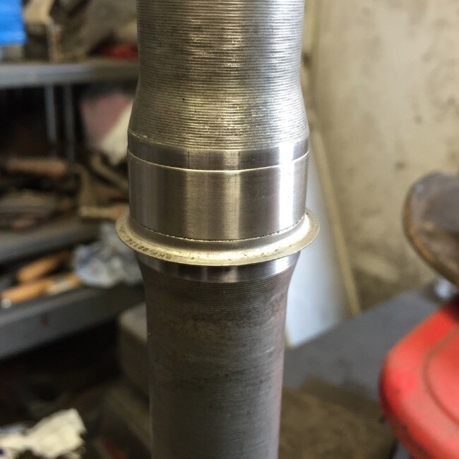

Where do you buy them (SKF -Sleedisleeve) I must say I've not come across them before you posted. Never too old to learn! The short one was £120 incl the long one was £259 Incl

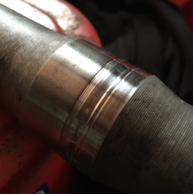

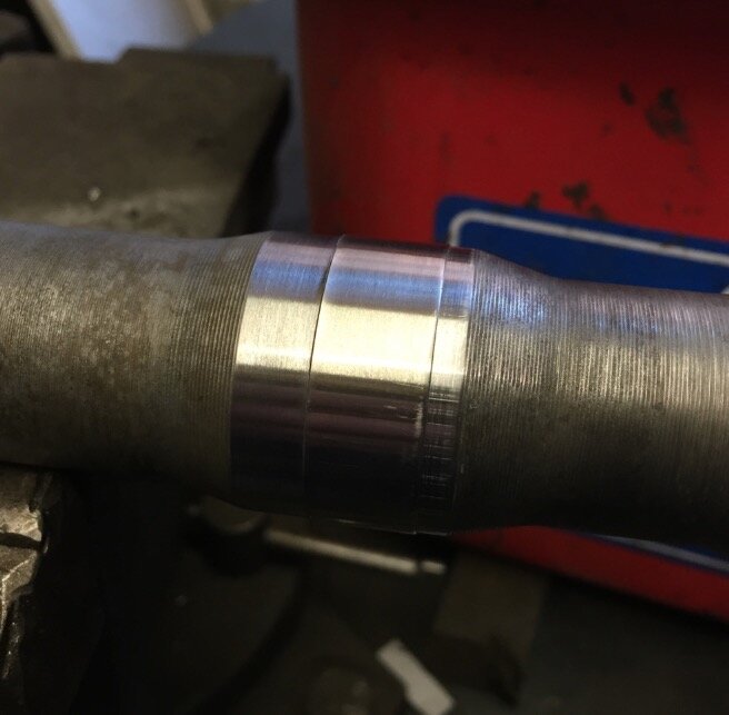

Jeez! Sleeves cost me £30 the other week. I got mine from a bearing specialist but you can order them on line. I only used on in the end. I filled the groove first with a compound then put the sleeve on. Job done.
