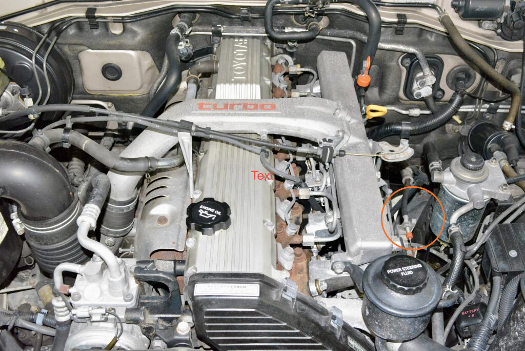

P.s check the throttle cable from the gearbox to the engine / fuel pump as if thats worn like mine was beforehand it also prevents the gearbox from engaging. I did have a small write up on here somewhere.
Best wishes
do you mean the pressure cable that can be adjusted??
I did have a problem this morning when I out the car in reverse it took a little while for it to engage !
Needing two people one pressing on the gas and the other checking on the cable going to the fuel pump from under the engine bay. If it shows little play or movement then the cable needs changing. If it's stuck you may temporarily take this end off and drip some mechanical oil into the wire to free it up and then check again upon the same method. Not a rush job if this is the case so take your time.

where would that cable likely to be on a 1hdfte engine??
cheers Mark
thanks very much ill check this out
