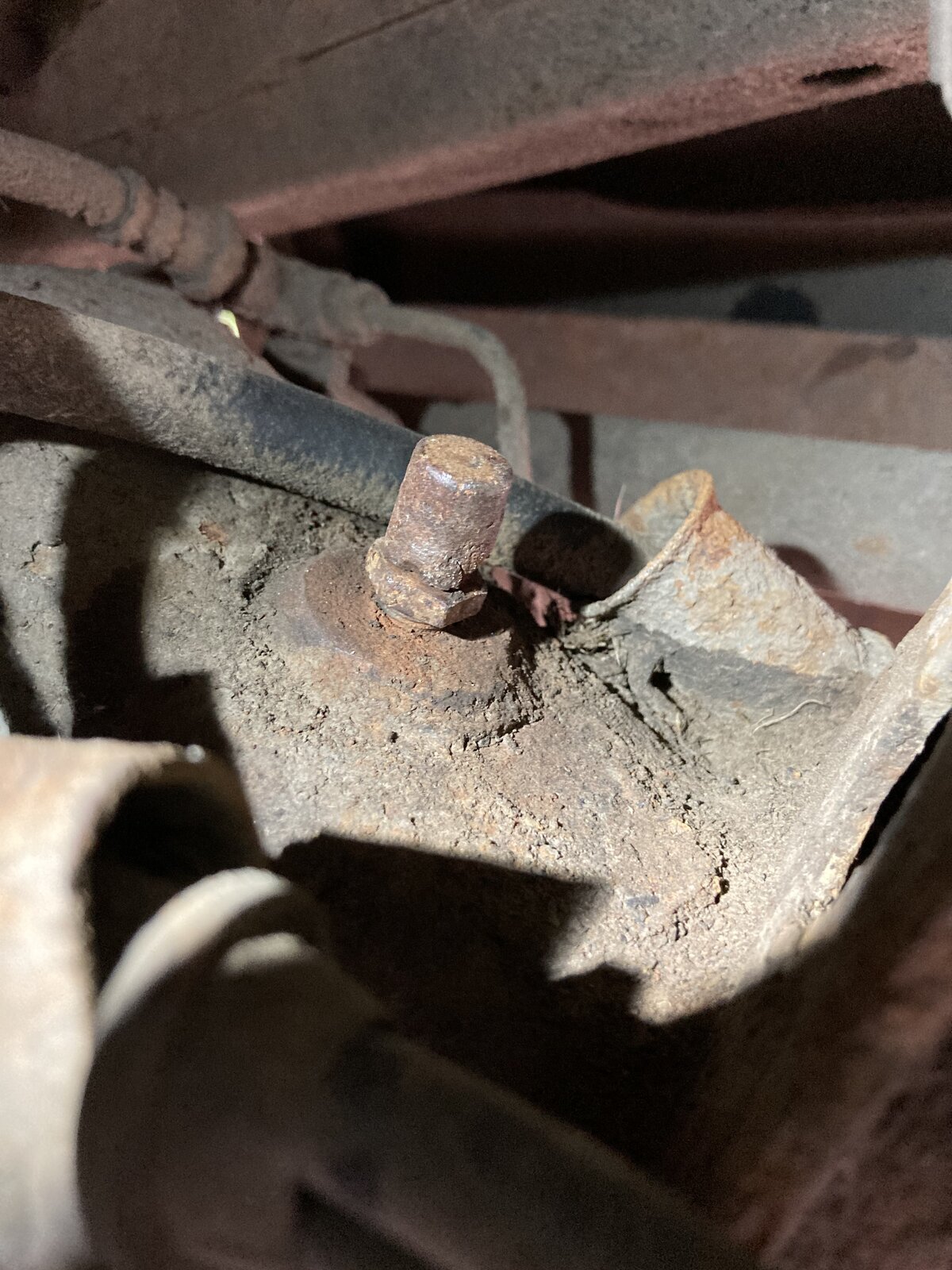

When changing the differental's oil and transfer box oil, I noticed the oil spat out of the filler plug of the rear diff when I took it out. Too much pressure build up I think to myself. When I looked at the diff breather valve on the top of the housing it was rusty and falling apart. More to the point it was blocked solid.
So I bought a genuine breather from Milner, (cheaper than Roughtrax), and fitted it as seen below. The important part of this story is that if the Diff builds up too much pressure that it can blow out seals. So for £10 incl P&P its better safe than sorry.
Thought I'd share this...

Regards the access. You can get at it from behind the diff and over the back axle. Wire brush it off then soak it in release agent first. Get a deep 14mm socket and undo it. Its easy as its on a tapered thread, similar to a pipe BSP pipe thread. Using a spanner isn't easy due to the access as you said CHADr, but doable.

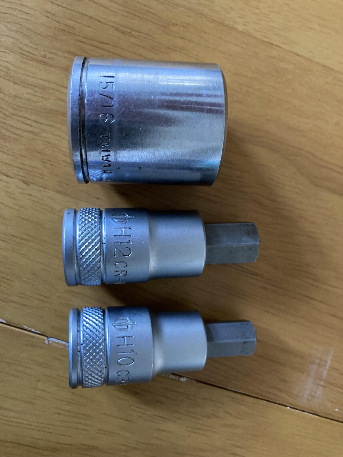

Ooo, thats a difficult one. The front diff fill plug is a swine to get at. I took of both skid plates to make it easier. The fill is a 10mm and drain is a 12mm hex socket. I got mine from Screwfix, £10 for a set and decent quality. Use a short breaker bar, it'll reduce the chance of problems.
I was fortunate all the diff and transfer box plugs came out ok. I sprayed them in Plusgas release first.
Another tip, use a 15/16 inch socket for the rear diff and transfer box plugs. Its slightly smaller that the 24mm suggested and a better fit.

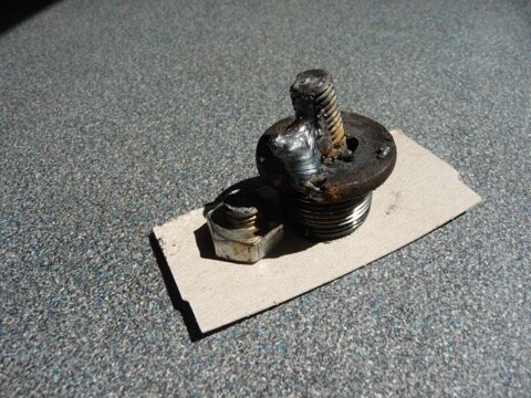

Worst case scenario some have welded a nut onto buggered plugs just to get it out .
I'm in the weld-a-bolt-on club. It snapped off but the plug still came out with Mole grips on the weld blob.

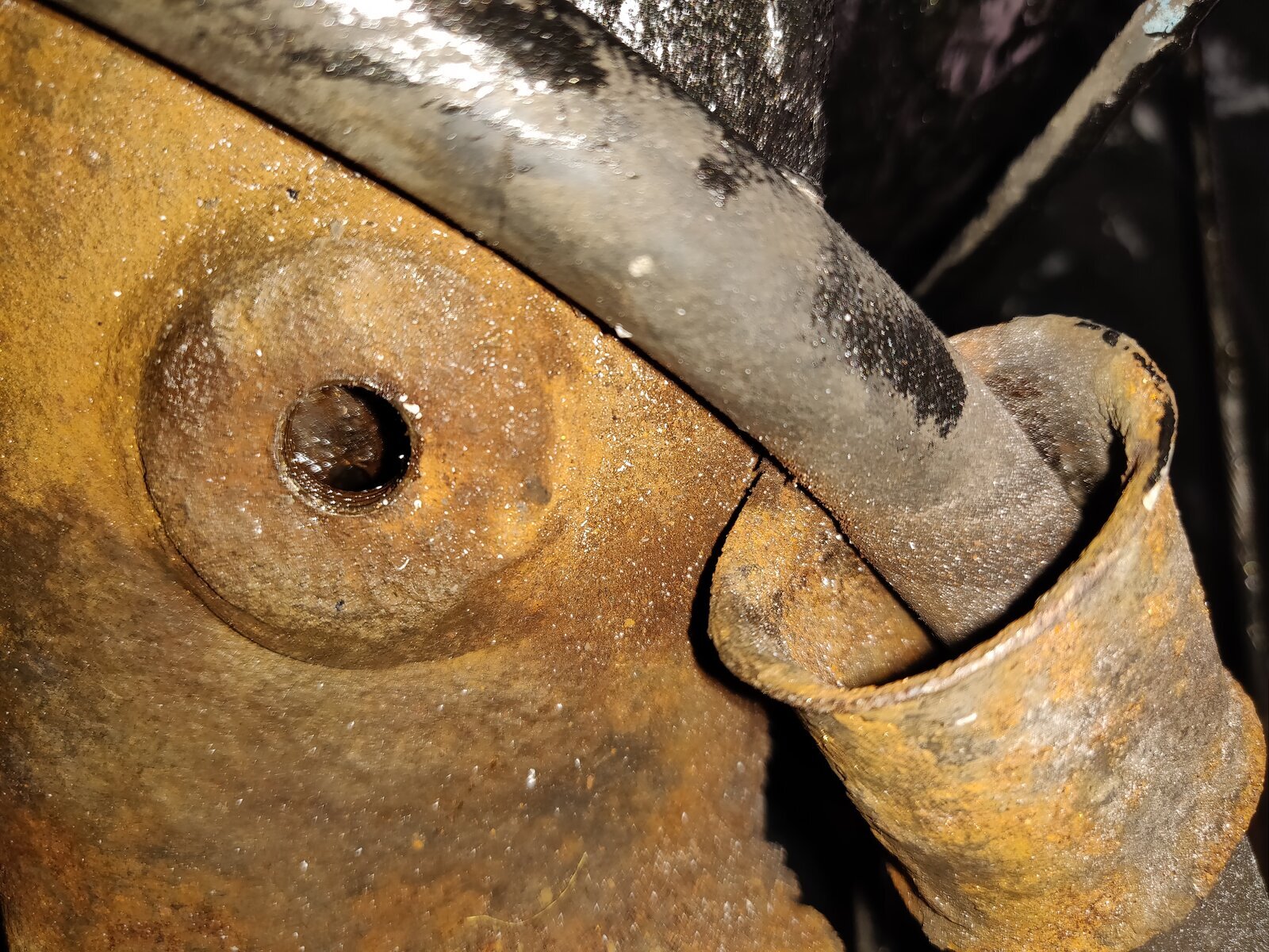

Not the best picture but you can hopefully see what I'm talking about - there is something solid at the bottom of the breather hole. I'm not sure if it's the diff as it seems far too close to the case - there's hardly any "gap" if any.
Edit : this was nagging at me so much so, that I've just ordered a cheap USB endoscope from Amazon. The camera is only 5.5mm so should be able to get a look inside......
Hope it doesn't become a case of curiosity killed my cat diff....:wtf:
