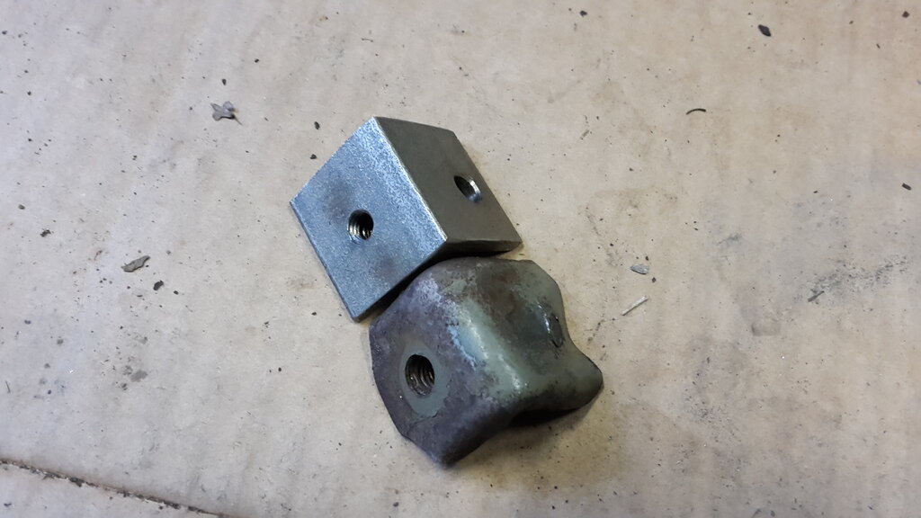

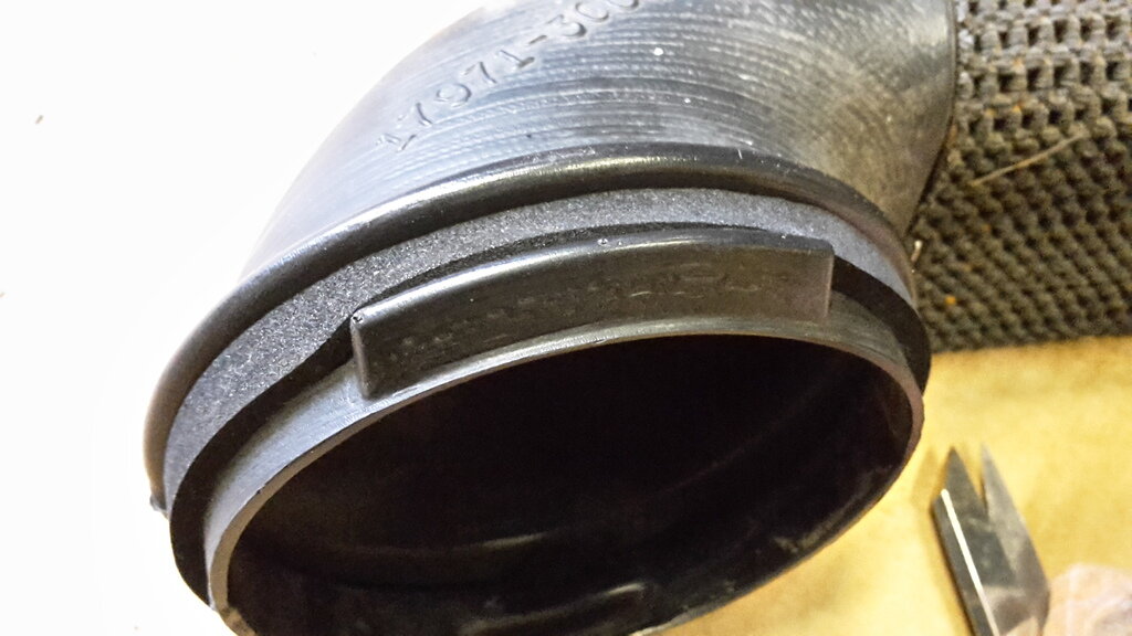

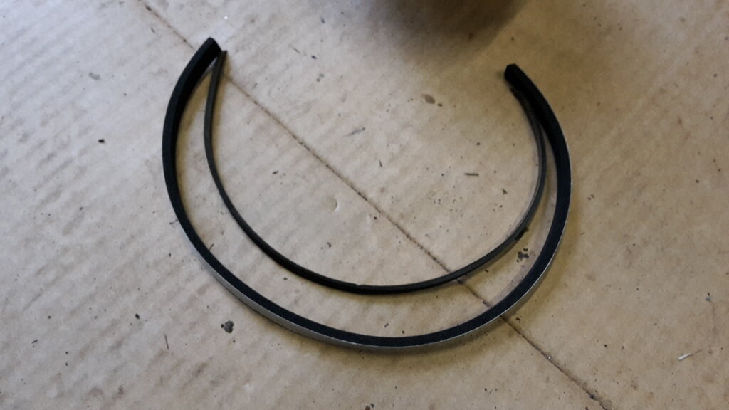

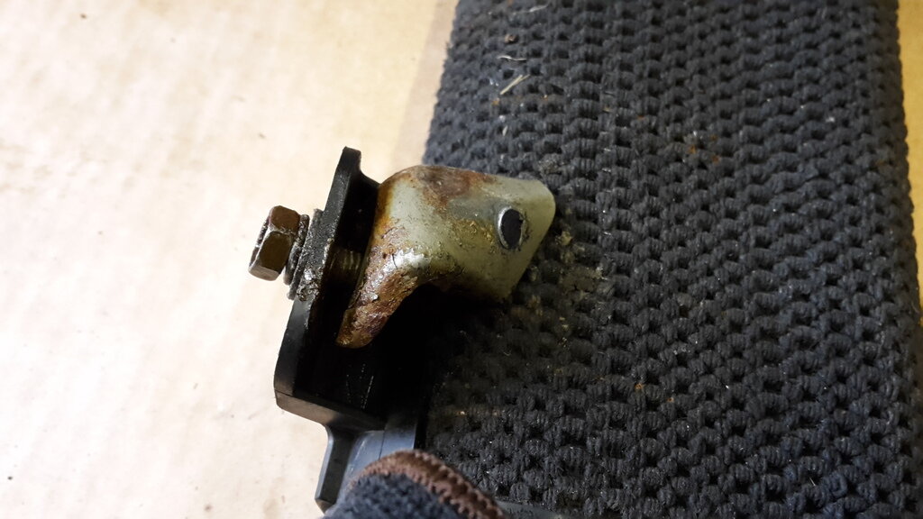

My 120 had the rattle as described above, a quick recon proved the culprit to be the very same.
However, it rattled only in cold weather, never warm or hot weather. I bought the spare clips and foam rubber, then used the rubber for another job and never got round to fixing it as it was warm weather again. That was winter 2017/18.
It rattled all winter of 2018/2019 as well, which is only 2 months here, and I’ll get round to it this winter if I can find some more foam rubber, which is a real challenge in itself - that’s if it starts again. Hasn’t done so far, so it might be another 12 months before I need to address the issue!
