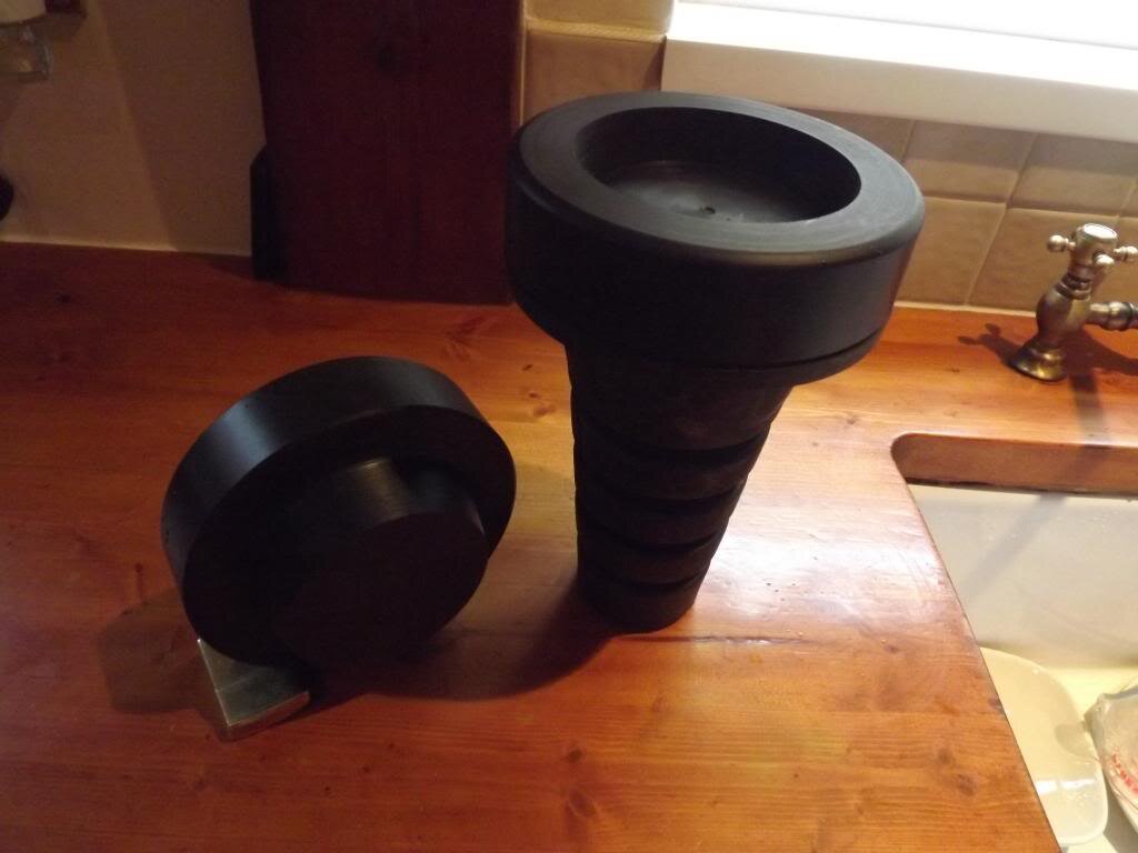

For Clive really we discussed it recently and i just chanced upon my own pic while googling rocksliders

So what did you buy, the whole set-up in the photo or just the spacer pieces to use on existing cone stops?

I took the standard cone to a local plastics place because the metal place had nothing big enough to lathe , explained what i wanted and collected an hour or so later , can't remember what they charged me but it was under a 100 quid i think .

Sadly my first attempt at this was via ebay and i sent a cone and never got anything back so the spacers have been used without cones ever since . I hope to remedy this soon as i am sick of buying replacement axle stops !
The plastics place i used doesn't deal with the public at all i don't think i just walked in and said hi . Wondering if i could sort out something for you mate i googled the place and came up blank so maybe its gone but i will pop down tomorrow for a look if you want its only 5 minutes away .

Let me see what's available here, I've made no enquiries at all this end yet, I only know I need something to raise the effective bump-stop level at the front by about 1".
The front tyres are just catching on more severe 'dives' into hollows or depressions, nothing serious... Yet!
