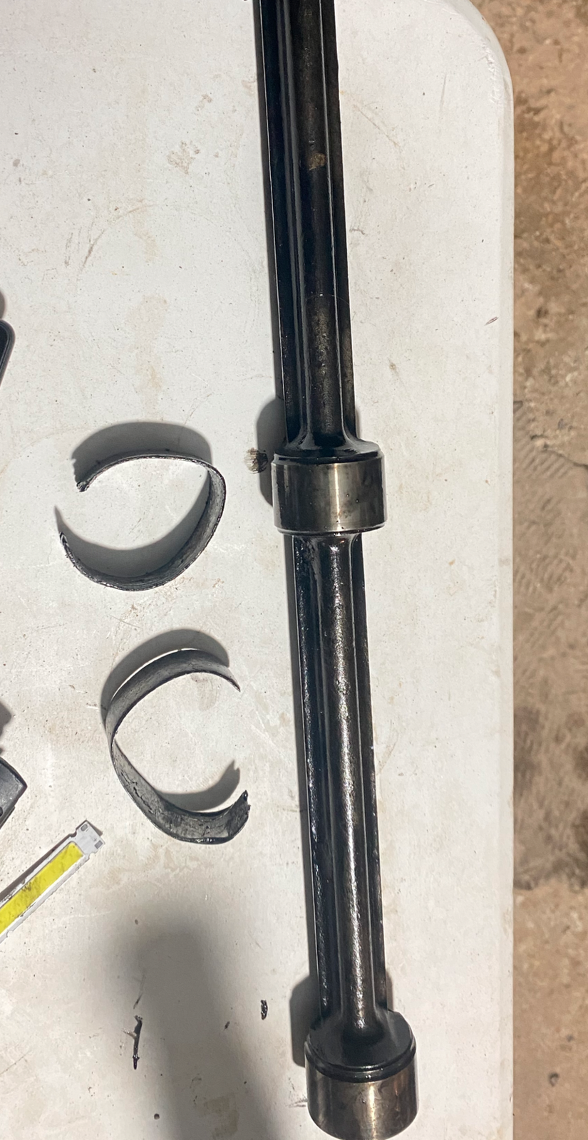

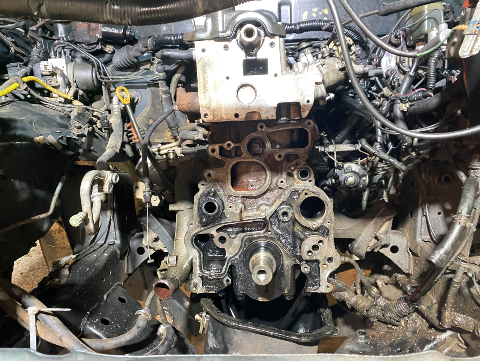

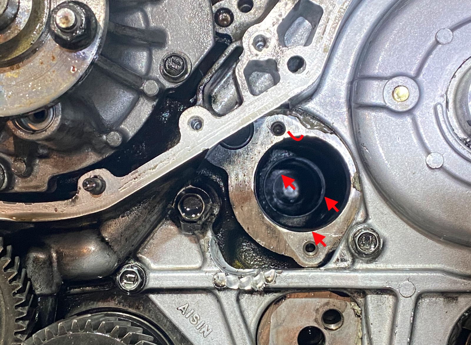

Already 'bricked' it by trying to flush the engine by running it with diesel for about one minute... Oil pressure dropped and after opening the oil pan (adventure on itself) i found the balancer shaft thrust washer pieces. After opening the front cover found out two out of the three balance shaft bearings twisted and out out their cavities, rolled up on the shaft.
I am currently in the process of overhauling what was a prefect engine with 411psi compression before my very wrong over carrying disastrous activity.
