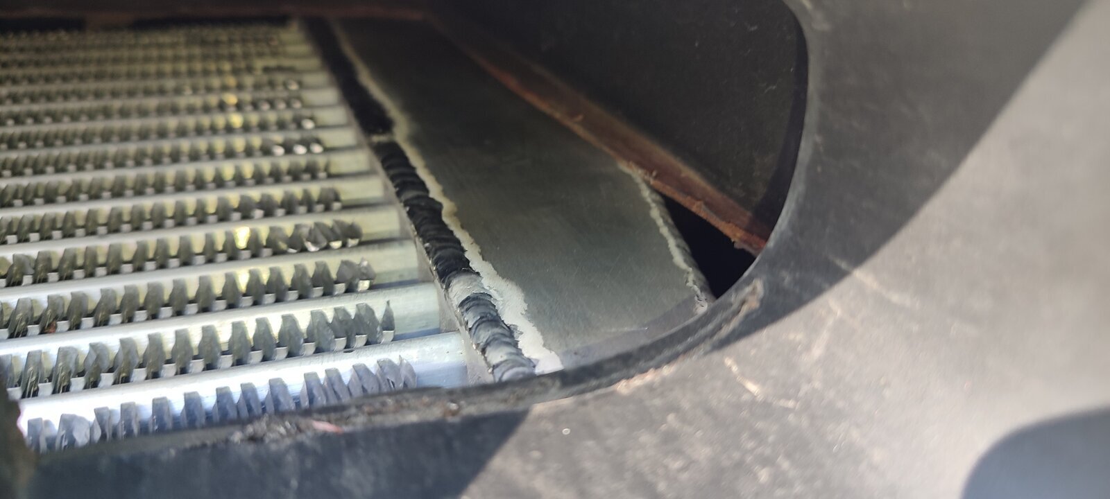

It's possible I could cut n shut the end tank on the exit side of the intercooler so it drops down at an angle and it might be enough to avoid touching the underside of the bonnet I'm about to head away for the weekend with the missus but next week, I'll have a look at that as an option also. The way it sits inside the bonnet a scoop might allow for that. Will still be close to touching but might just get me over the line.
This pic is looking through the bonnet scoop to the right/exit side of the intercooler. As the IC is off center, it doesn't seem to touch the other side I don't think. I'll have to have a other squizz in daylight. But yeah, that could be an option.
