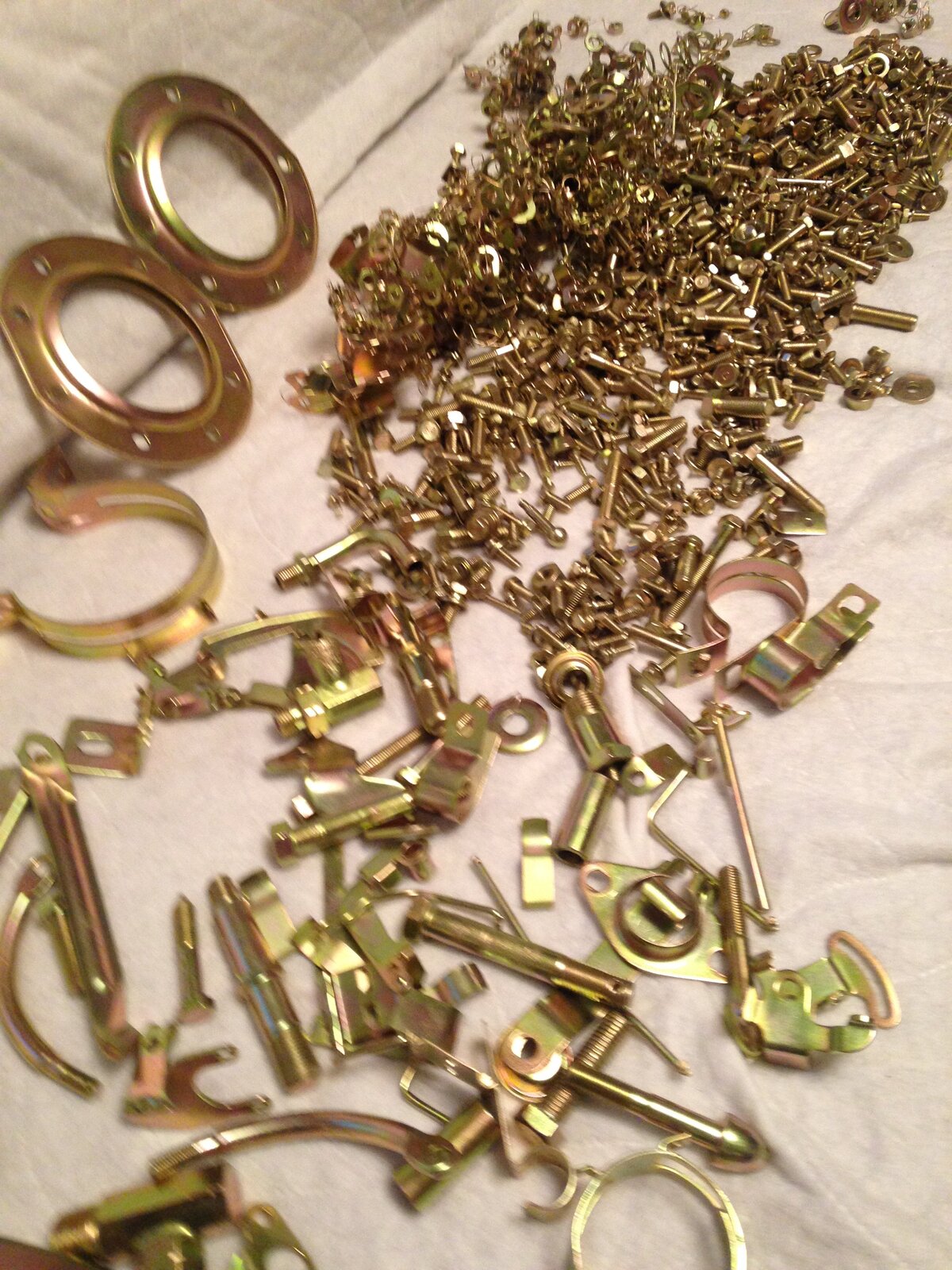

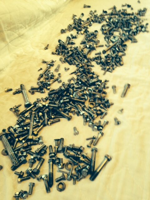

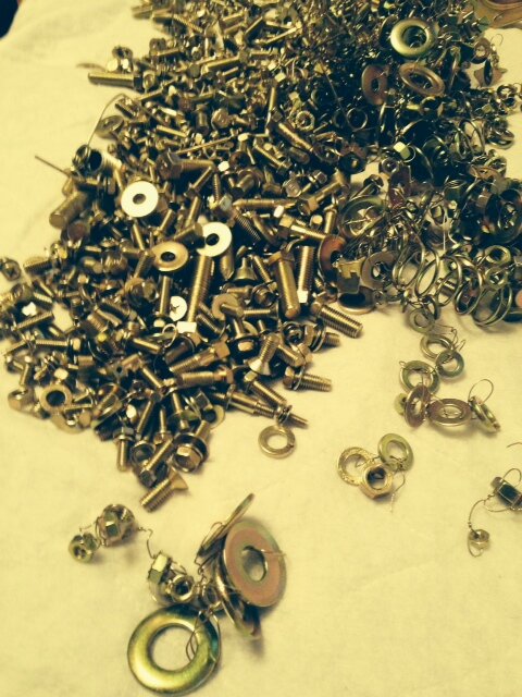

Mitch, hadn't checked the site for a few days. Sorry for not directly answering your questions. If I were you I, if you don't have one, I would buy a small blast cabinet. You can farm out the big parts for media blast (frame body etc...) but do the smalls yourself (bolts, brackets, etc...). On the nuts and bolts, it's a lot of work, but worth it in the long run, I made a container from a plastic box and cut a hole in the top for the blast gun and cut the bottom out and installed hardware cloth. This insures that you don't loose the small parts in the process. I blast the nuts and bolts and then wire brush them smooth prior to having them zinc plated. I do the same with all brackets etc... only you don't need to put them in the plastic container. The parts will come back from plating looking as new. image (39).jpegimage (56).jpegIMG_0631.JPG The first pic is of the parts prepped and ready for plating the two following photos are some of the parts after plating. Take lots of photos as you take the Land Cruiser apart. It helps to identify the correct nuts, bolts, brackets, etc...... I also have a large blaster that I can set up outside. I put down and up tarps to contain the media as I blast the frame etc... I had the body blasted by an expert to avoid warping any of the medal. Frame after media blasted.

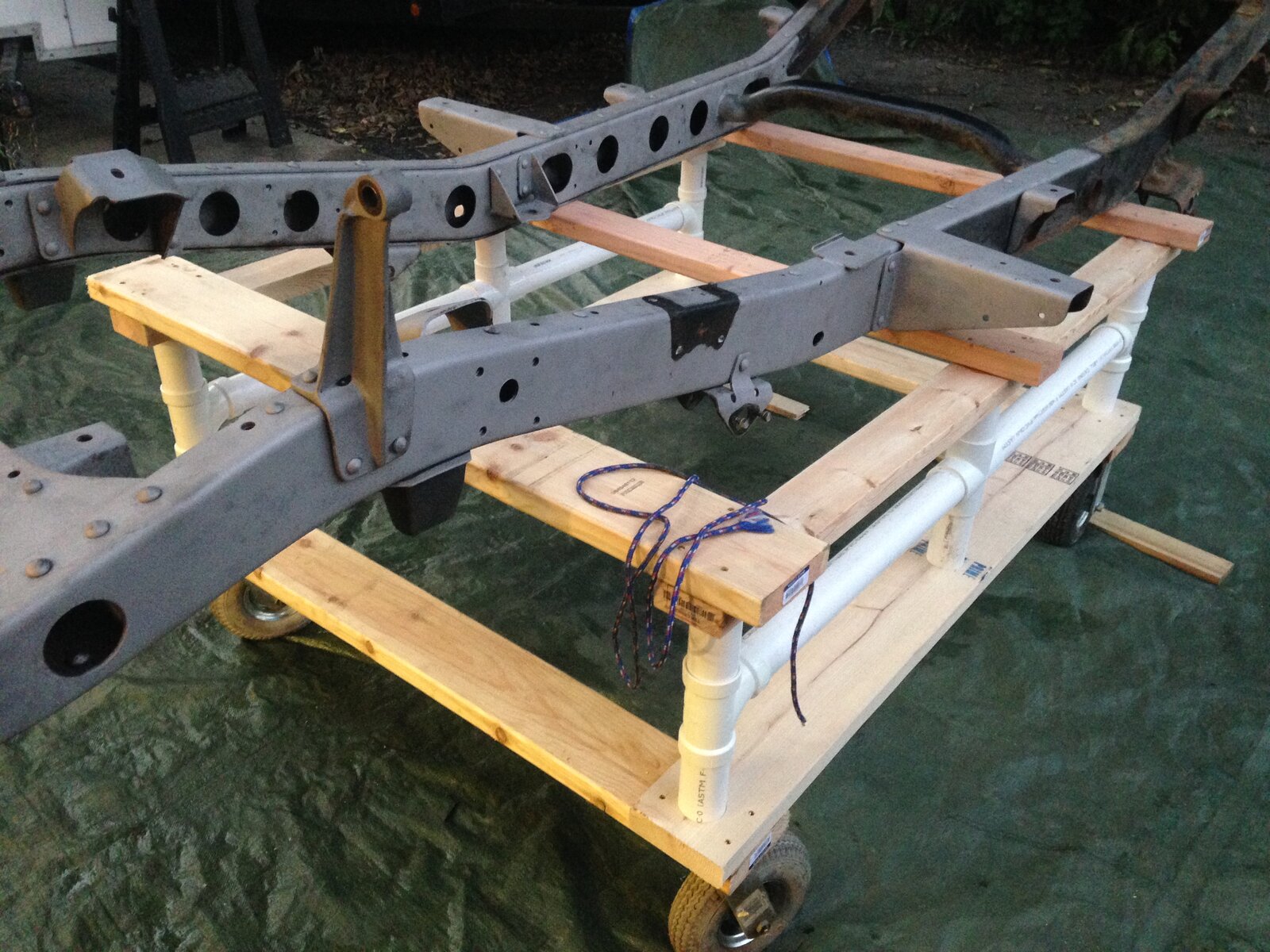

Mitch, hadn't checked the site for a few days. Sorry for not directly answering your questions. If I were you I, if you don't have one, I would buy a small blast cabinet. You can farm out the big parts for media blast (frame body etc...) but do the smalls yourself (bolts, brackets, etc...). On the nuts and bolts, it's a lot of work, but worth it in the long run, I made a container from a plastic box and cut a hole in the top for the blast gun and cut the bottom out and installed hardware cloth. This insures that you don't loose the small parts in the process. I blast the nuts and bolts and then wire brush them smooth prior to having them zinc plated. I do the same with all brackets etc... only you don't need to put them in the plastic container. The parts will come back from plating looking as new. View attachment 24139View attachment 24140View attachment 24141 The first pic is of the parts prepped and ready for plating the two following photos are some of the parts after plating. Take lots of photos as you take the Land Cruiser apart. It helps to identify the correct nuts, bolts, brackets, etc...... I also have a large blaster that I can set up outside. I put down and up tarps to contain the media as I blast the frame etc... I had the body blasted by an expert to avoid warping any of the medal. Frame after media blasted.
. View attachment 24142
