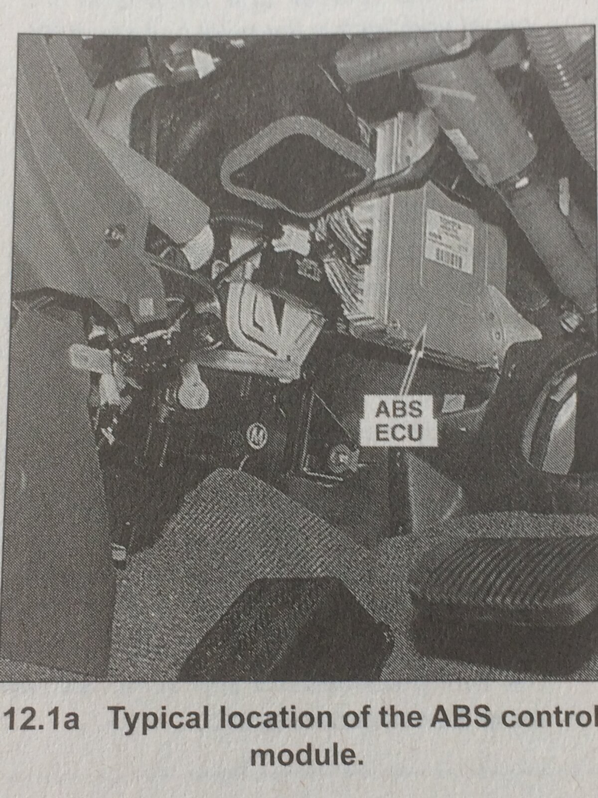

According to the Haynes manual, the “typical location” of the ABS ECU is above the brake pedal - see photo. Mine is a UK spec RHD Colorado 95, but my ABS ECU isn’t there. I am not sure otherwise.

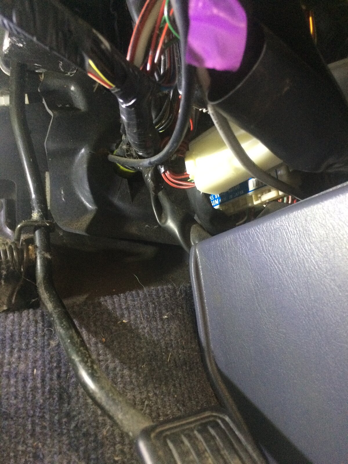

Ok - I just found mine. It’s on the side of the A-pillar, up and to the right of the accelerator pedal - see photo. The blue Aisin label on the ABS ECU can just about be seen.

Awesome, thanks. Just had a look and mines there too. Ill pull off the panels tonight to see if its all connected up
So checked the ABS computer and it is all connected up. I tried disconnecting and still no warning light. Went further and also disconnected the ABS pump, still no warning light. Reconnected everything and the ABS still doesn't work. Any ideas on what to try next? Was thinking I could open up the ECU to see if anything has been burned out by why would it not bring up a warning light even if that were the case?
