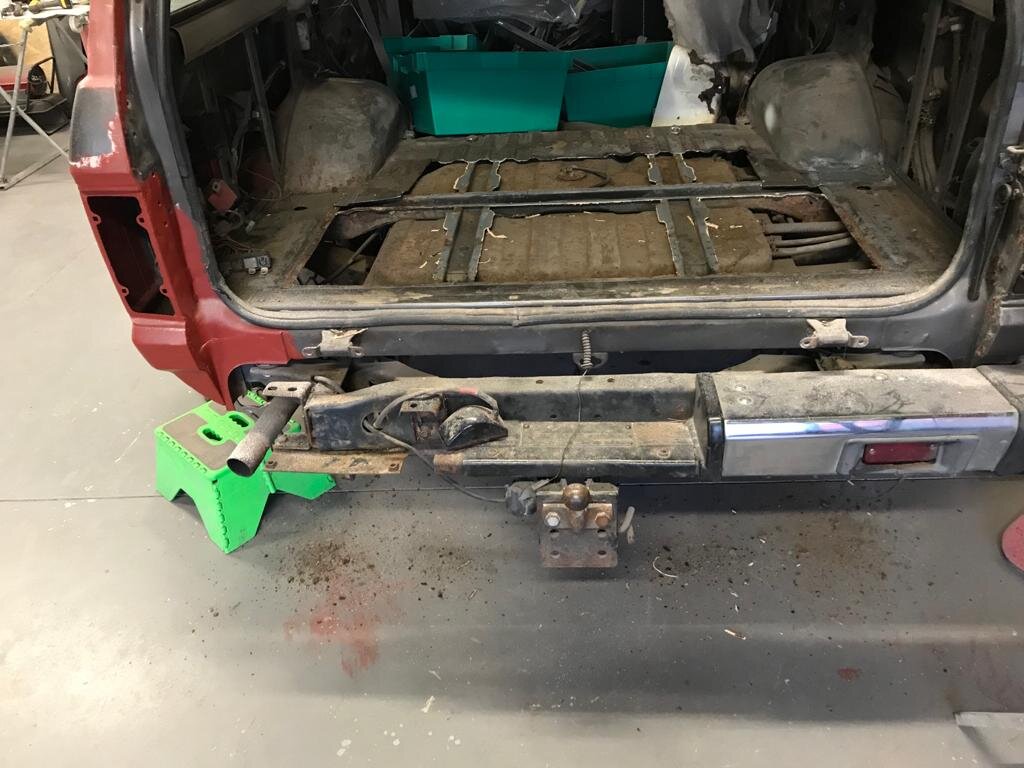

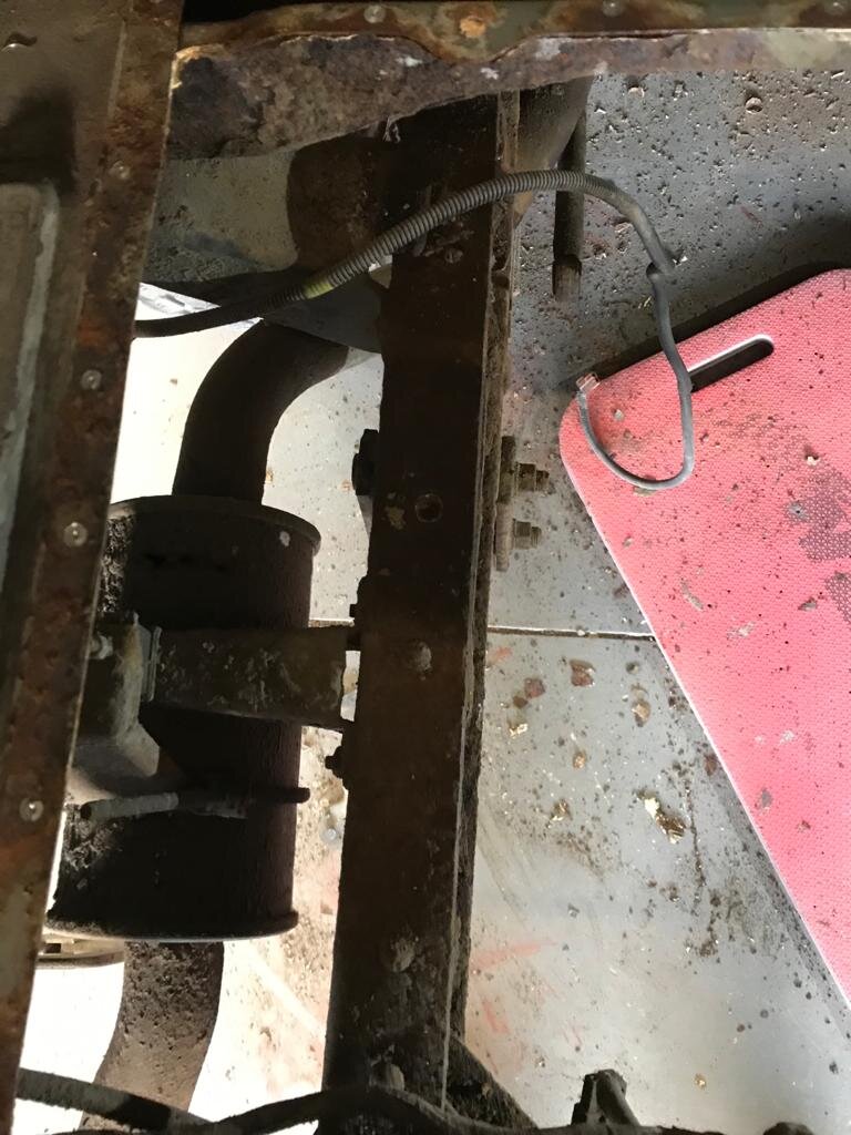

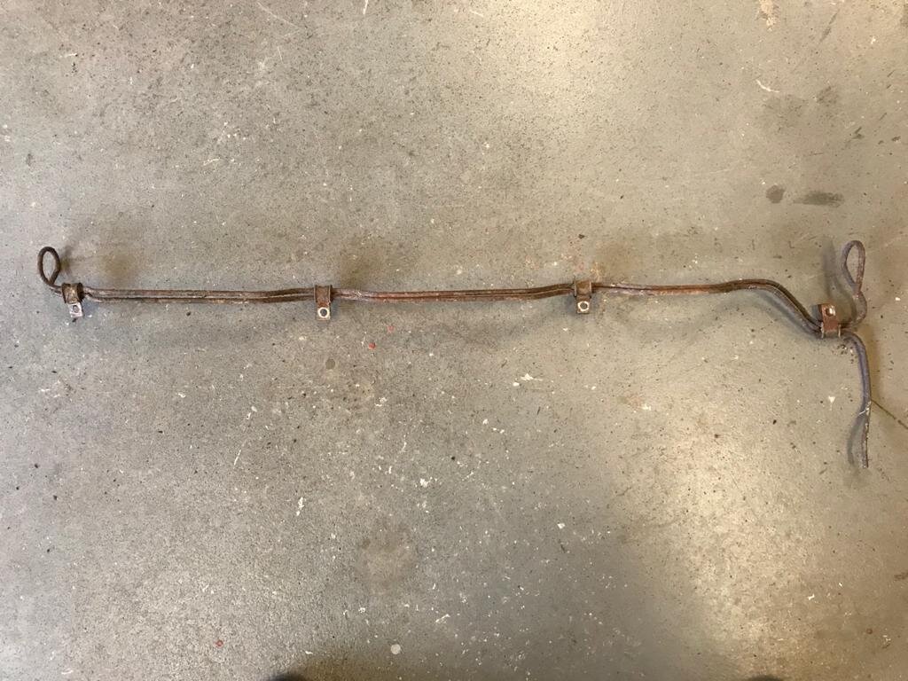

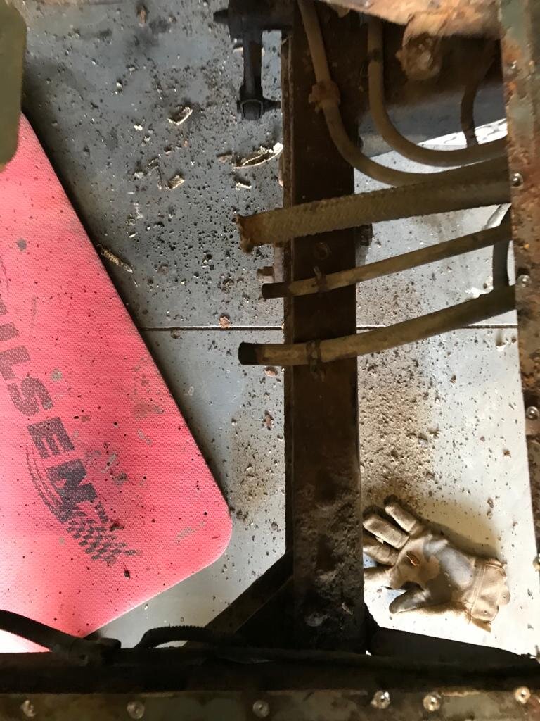

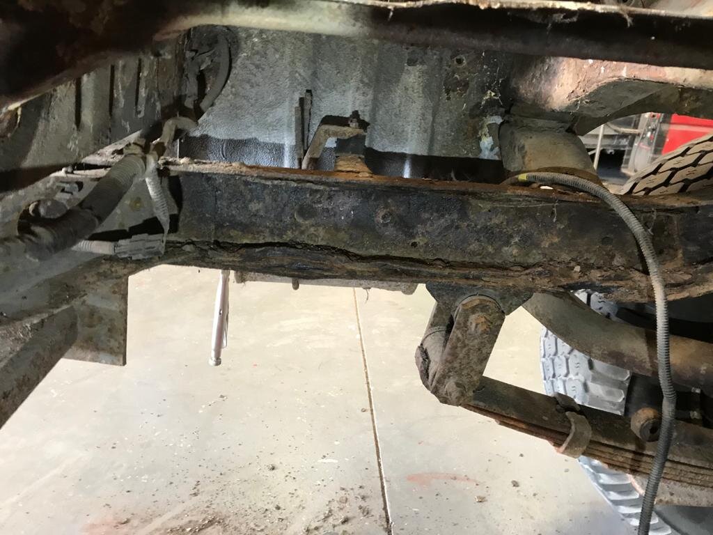

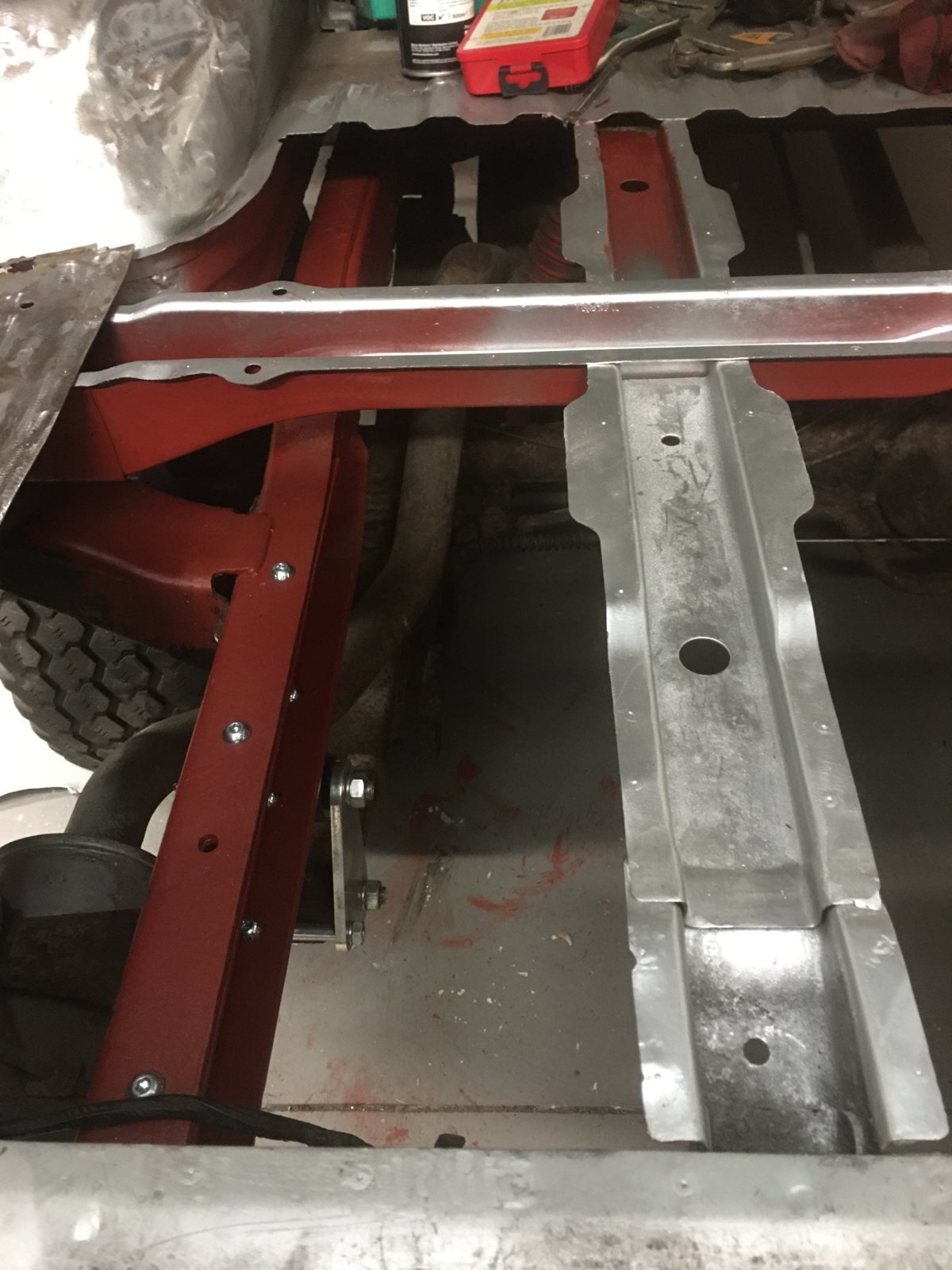

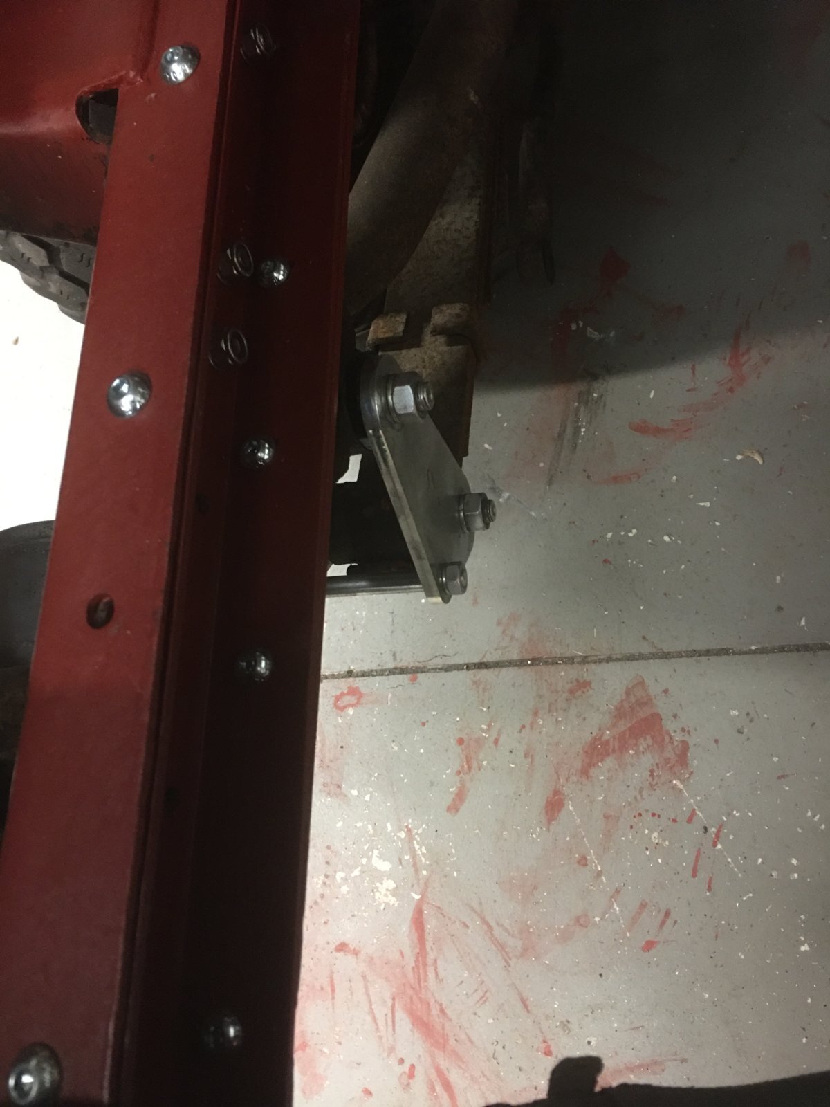

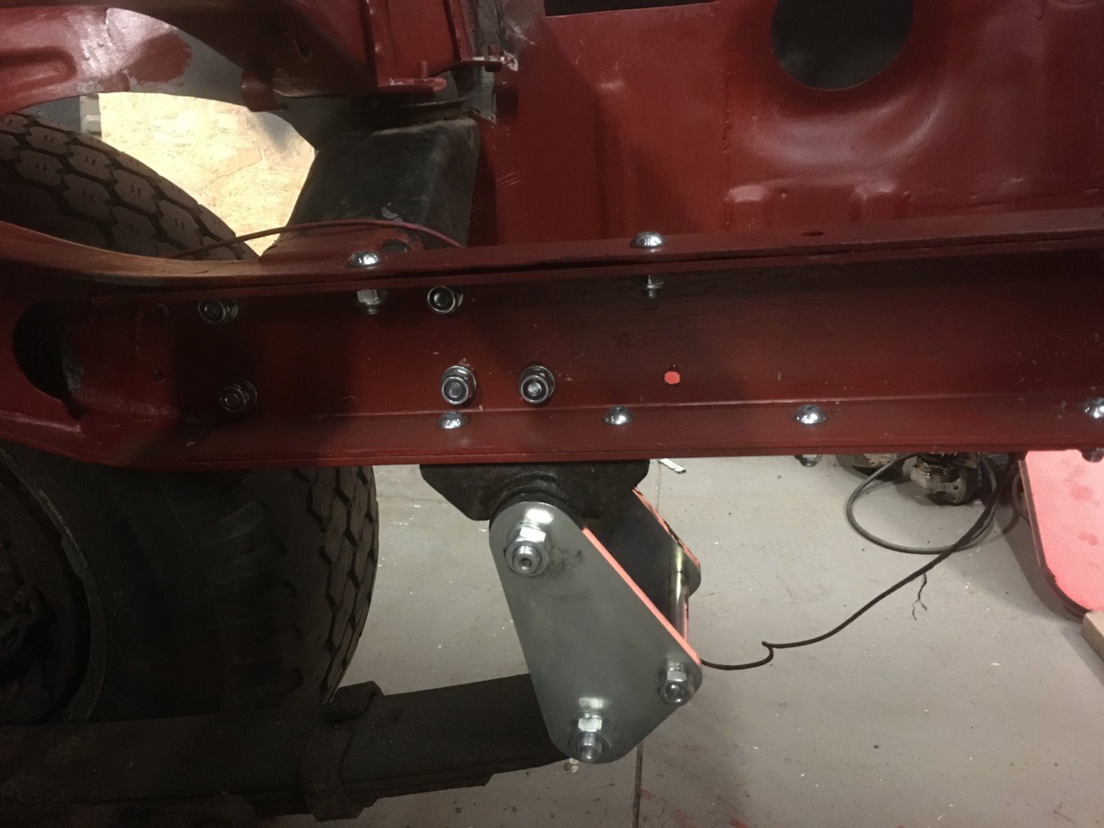

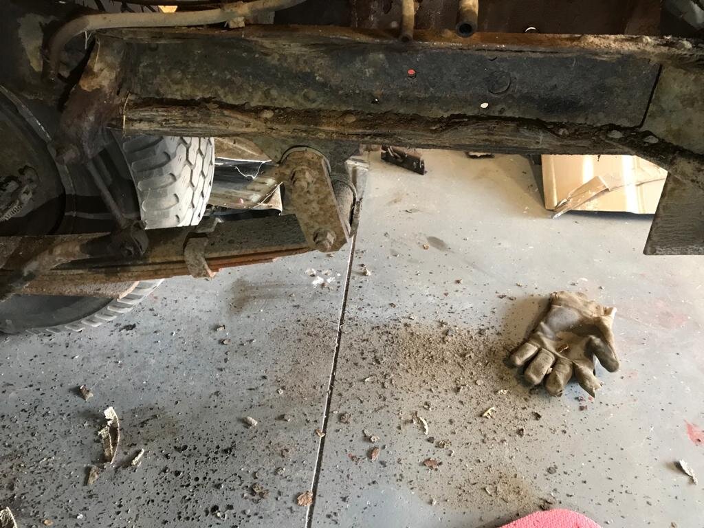

Hi there
Looking for rear chassis sections for a 62 or experience on previous repairs also fuel pipe as shown in pictures as that’s also rotten

I have some pictures on my old computer of a similar problem and the repair with box section of when I visited my friends in The Netherlands back in 2012??.. Solid repair and the hj61 is still on the road now! Infact they do sell the inner infill sections to fully box out the rear chassis, also an option.
When I get some time later I will get some pictures up for you... provided the pictures weren't taken on my now broken smart phone, but I don't think they were.
Also on the 90 forum side there finiterex 's 95 which had a new rear chassis section made and fitted. Which will shed some light on the process for you.
It's all possible!:thumbup:

Hi John, boxing it off is an option, in the past I have de riveted that section, removed the inner strengthening piece and replaced it with another piece of channel and bolted it all together which worked well. I've also seen it boxed with a bigger piece of channel on the outside.
This Idea of reinforcing the chassis around the rear spring idea wasn't one of Toyotas best ideas. I've had a fair few 80's and everyone one is the same.
