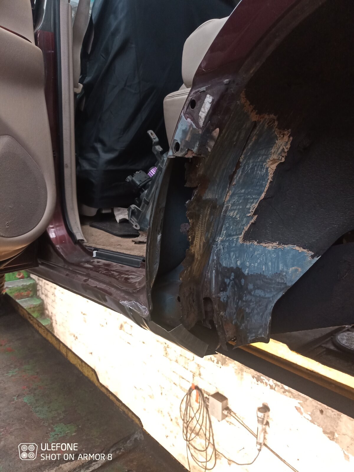

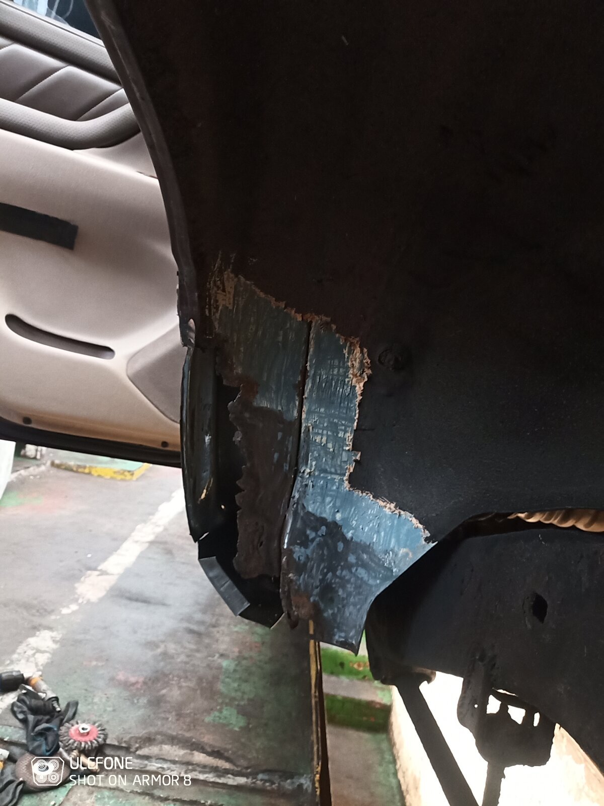

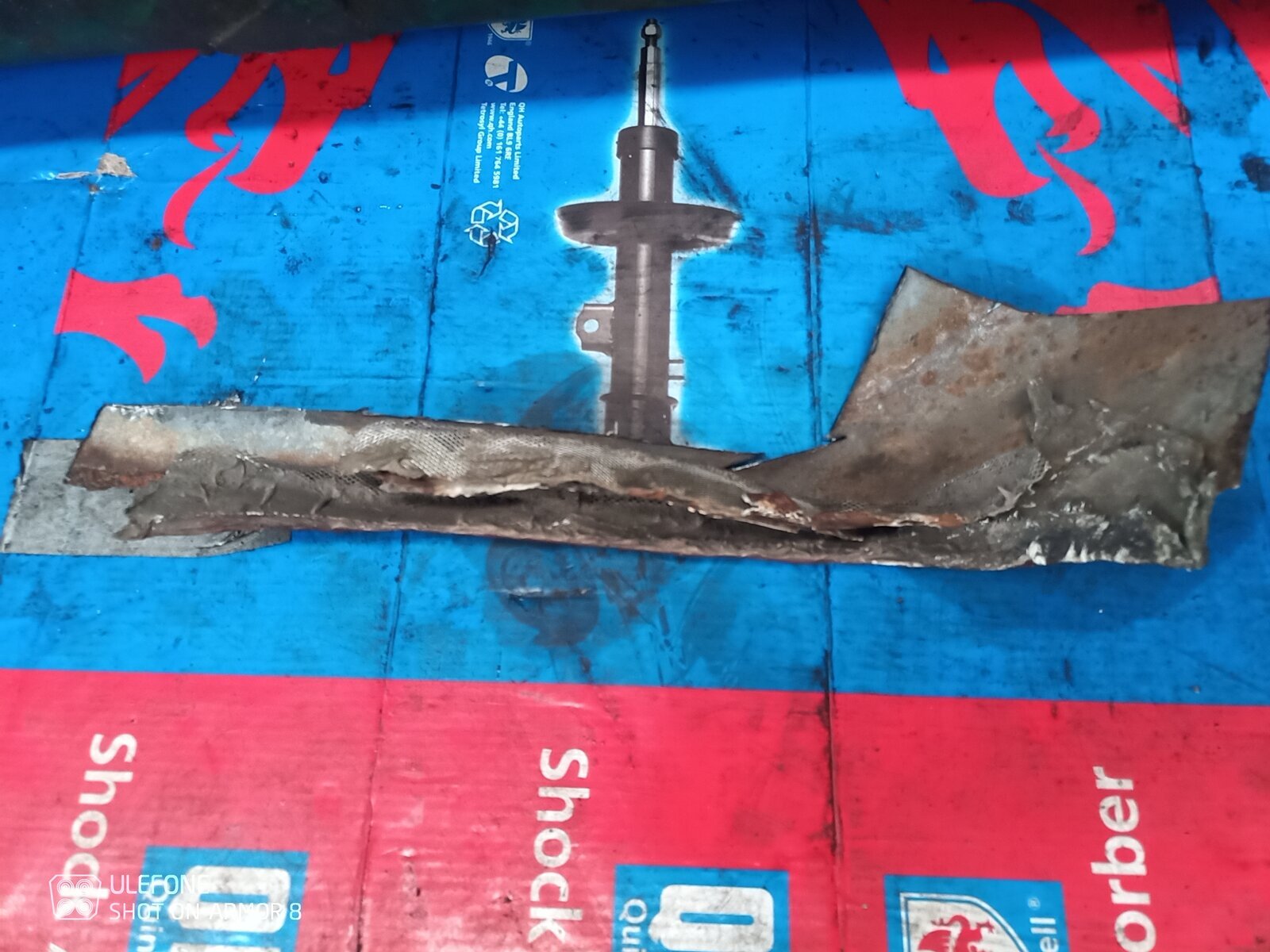

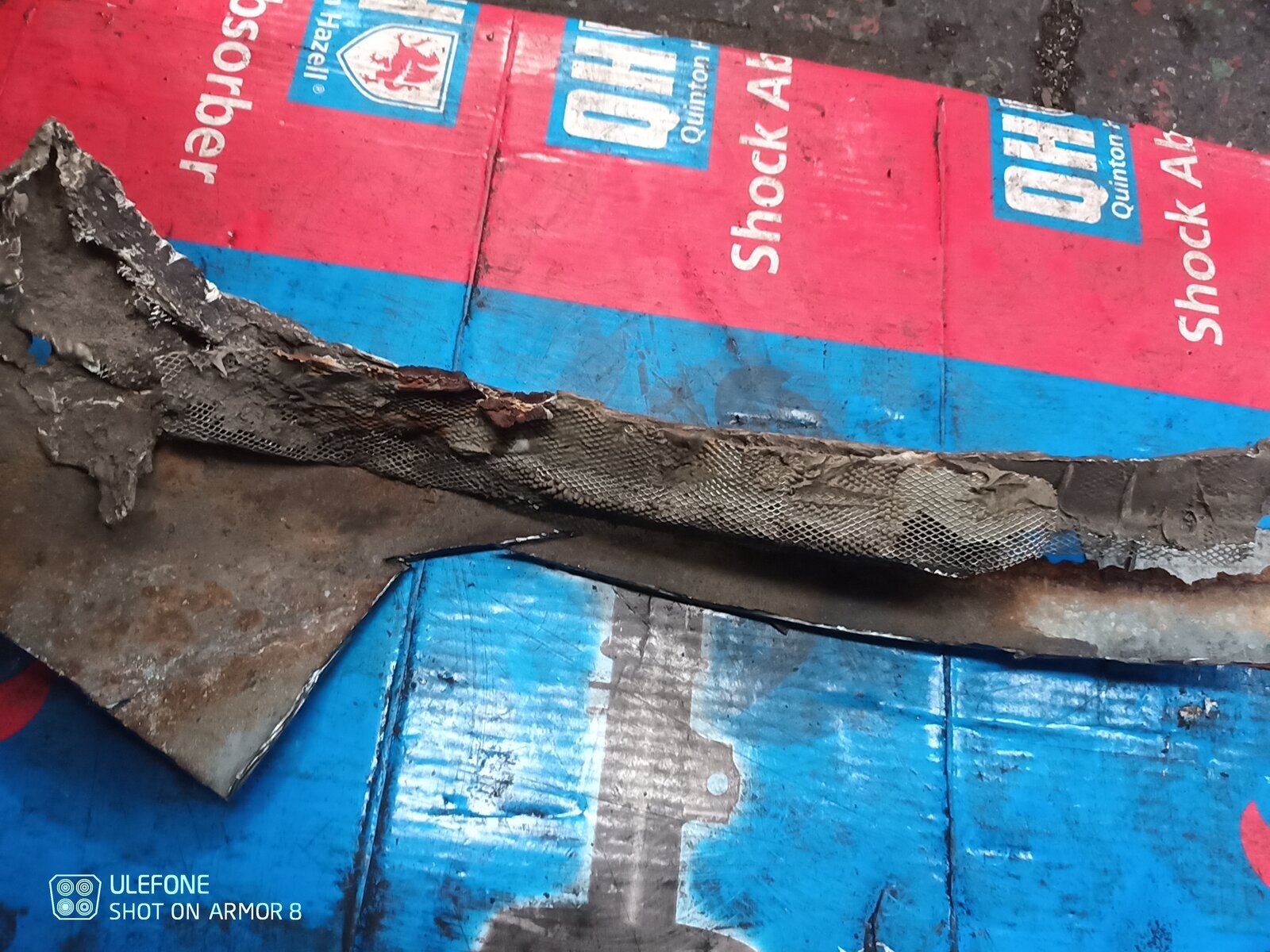

This is the worst bit that we have found on the Amazon. The NSR Wheel arch was blistering but it did not look too bad until we went in with the grinder to reveal a fiberglass repair. To be fair it was a good repair, you would not have known.

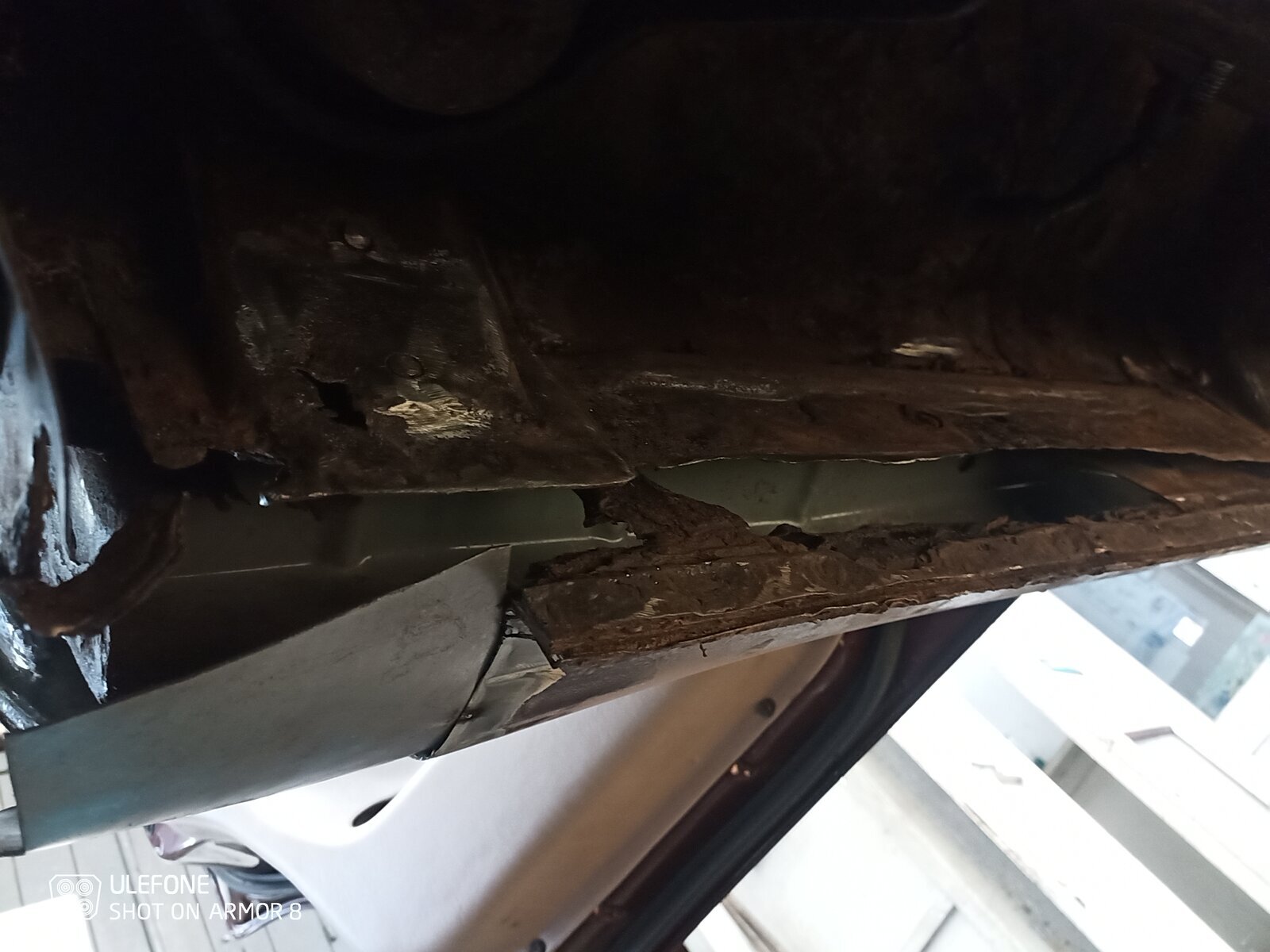

Anyway, its all cut out to reveal like a three piece sill arrangement, an inner piece with two outers. One the Outer sill, the other going up to the floor. On with shaping some new pieces in a 1.5mm steel plate to weld in. It will be strong when done, just proably means working New Years Day if I want my MOT pit back for next week.

The rear wheel arch/sill area seems to be a weak spot for corrosion on the 80 and 100 series. Looks like you're not taking any half measures with the repairs!:thumbup:
When looking at Landcruiser 100s before buying this one, I was looking on E-bay at parts, availability, like yer do. I did come across an East European site producing repair panels, sills, wheel arches etc. So when I did look at this motor these were obvious areas. I was aware that the sills needed the work and I am more than happy to do it, because I know what its going to get plus a large amount of Waxoyl blown inside. However, the wheel arches did not look bad at all. It was a good fiberglass repair but I want steel in there, it won't be rotting again.
I am sure that there are a good few out there without corrosion, but they will be in the ten grand plus bracket. That kind of money in a motor is not for me. My best motors have always been someone elses scrap with the potential for me to turn it into what I want. We have to put the labour during the early stages, but the end results are worth it.
