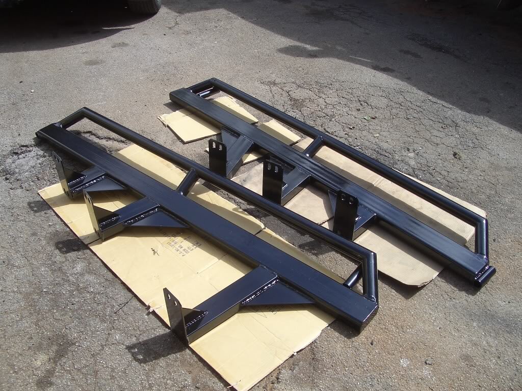

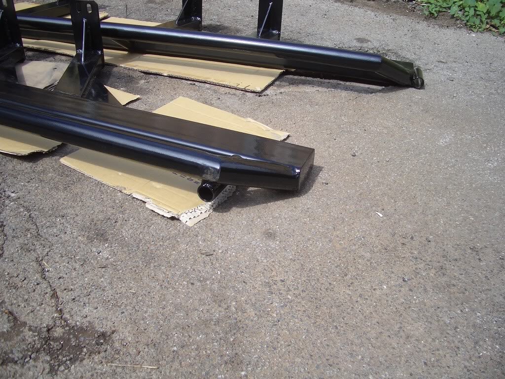

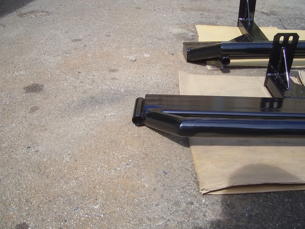

Well what a difference a bit of finishing can make. They've gone from ugly ducklings to Black Swans!
Can't wait to get them bolted on. All I need now is some wheels.

very shiny and very nice. You know they won't stay like that for long dont you! :whistle:
very nice
the driveway has some nice potholes :lol:
They might Tony, as long as I don't let you drive :doh: :doh: :D
Might put some grip tape on the tops, not that I really stand on there, but the coating would get worn off eventually if I did. It comes on rolls of 50mm which would be just right.
