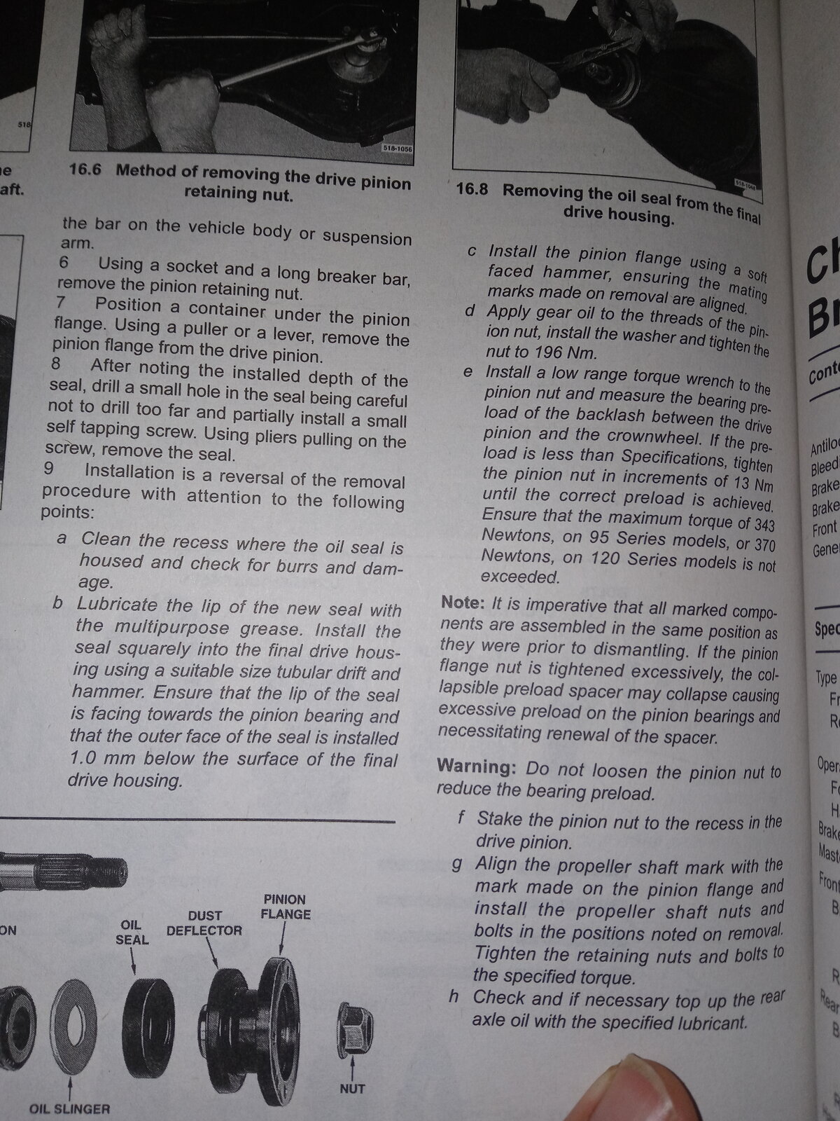

This is from the Haynes manual for the 90 series.
Output flange nut 118Nm
Rear axle nut see text they say, so here is an excerpt.

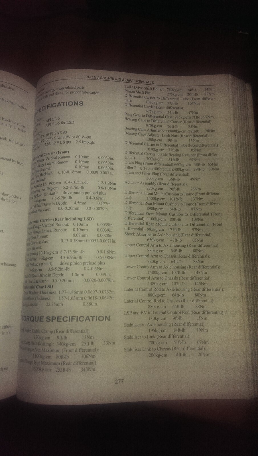

Does anyone know the specification for the rear pinion on a 95? I’m guess I check this with a Beam Torque Wrench?
are you sitting comfortably ?
pinion shaft pin 27NM
pinion flange nut max 343 NM
& a long list of other stuff . i'll try & get a photo posted
Cool, I shall digest that this evening :0)
343Nm on the Flange nut from the picture from good old boy above, and 196Nm from the page Adventurewagon shared? I supposed 343 is the Max that you can’t go over? That is huge...
Not quite follow the backslash check in step e of the manual, can anyone explain?
I have seen few videos on YouTube and most people did the pinion oil seal replacement by counting the exact turns of loosening the Pinion nut and put a mark on it, and tighten back to the same position, assume this is the layman way of doing it and won’t cause any problem?
The 343Nm is mentioned as a never exceed torque for the 90 series at the end of the text I photographed. I think you tighten in increments.

OK, heres what I did and it seems to have worked out fine......
I had a feel for the backlash and the weight to turn the flange by hand with the truck up off the ground with the wheels removed and the prop shaft also removed. I then made a note of how many threads were showing outside the front of the flange nut and the position of the nut in relation to the flange and the pinion. I made a long bar out of flat steel with two holes drilled through to bolt to the flange to hold the pinion still while I undid it and also did it back up. After I'd replaced the seal I did the flange nut up with a normal ratchet until it was reasonably tight then checked its position before torquing it up to 196 nM as described in the manual. This took the nut to just before all my original markings, so I torqued the nut for a further 10 nM twice (13 nM steps recommended in the manual). this took the nut just beyond the markings and reference points that I'd noted before removal by about 1/16".

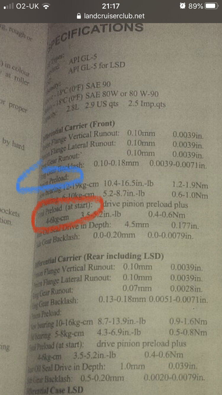

Hi,
On post #7 above, the spec from goodoldboy on the pinion pre load, what is the pre load for the red circle below? Are there for when the diff is on the landcruiser with both rear wheels on? Surely the wheels will add on the weight for the pre load measurements? Thanks
