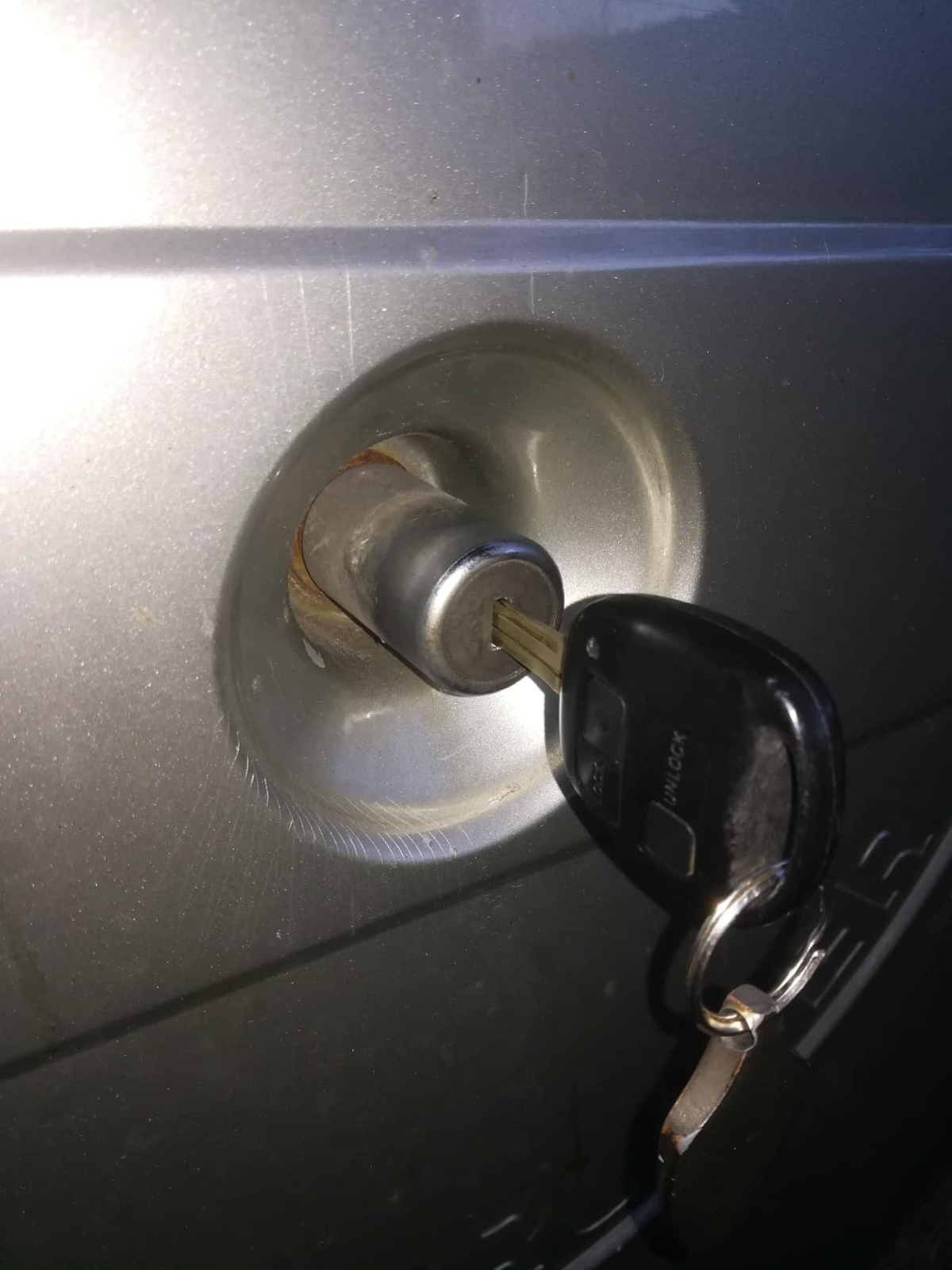

I also have a problem with this lock. I insert the key and no matter how many times i turn the key, the lock never comes off / unscrews... Am I doing something wrong or is it broken? Any ideas how to get this thing off?

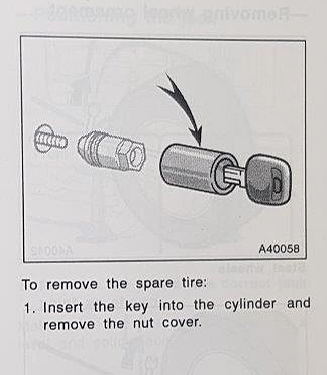

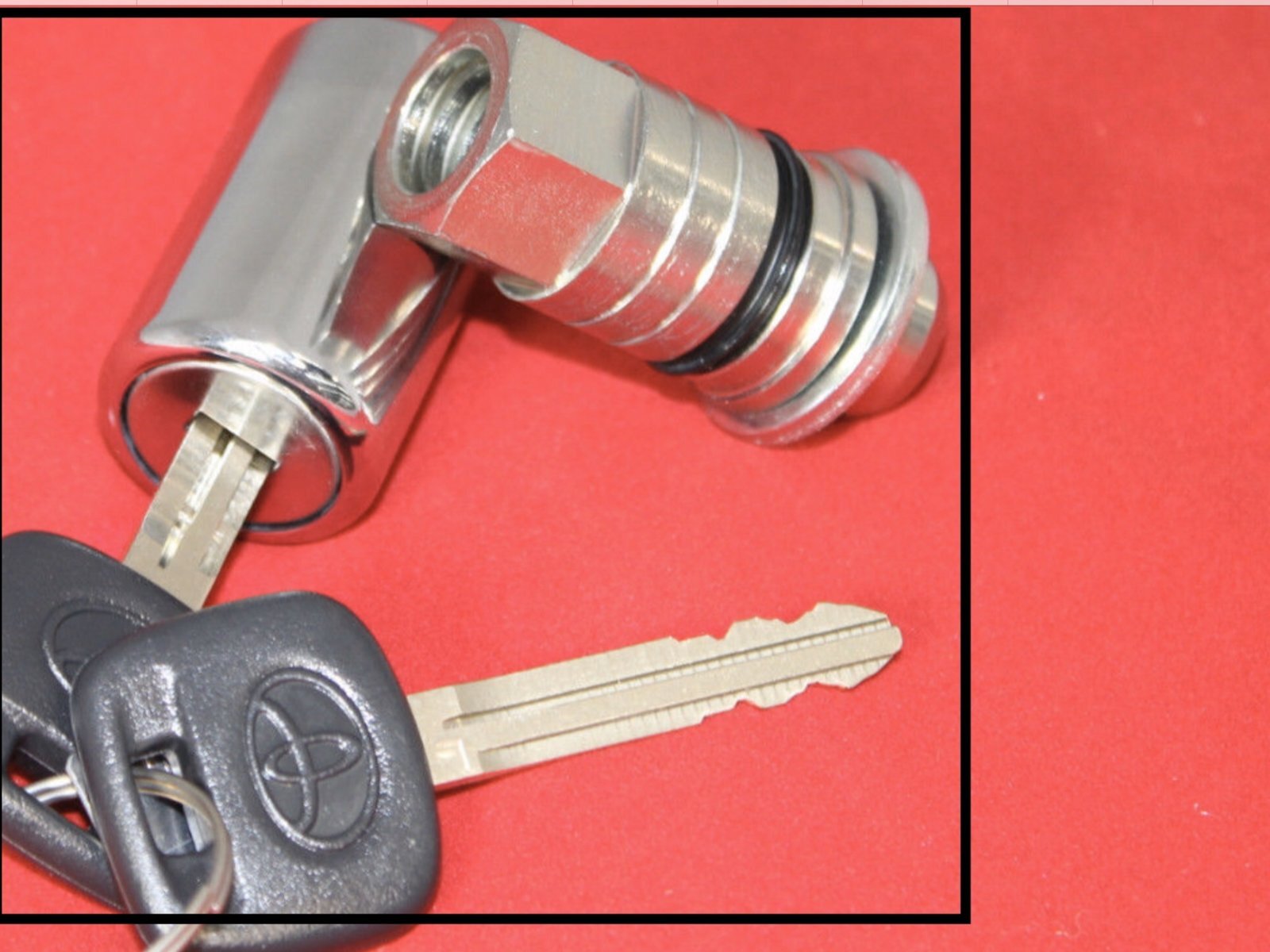

Jureb, from memory the chrome cylinder/key barrel pulls off when the key is in the right position, there is no stop or click, so turn key and pull that chrome rotating cylinder. When in the correct position, off it comes with key and barrel complete. When off, it exposes the other half, which is essentially a modified wheel bolt. This undose in the normal manner with wheel brace/socket etc.

Yes, the manual also says so. But the thing just won't come off. I must have tried every position from 0 to 360 degrees with a step of 1 degree :sweatsmile:. I'm gonna keep trying. I wouldn't be surprised that everything inside the lock is corroded/ seized after all these years of salt and dirt spraying on the back of the car.... I'm going to be the biggest idiot when my tyre gets a puncture and I will be calling road assistance with a spare on the rear hatch :).
When I had one on my 78, it was always hit and miss getting off, and that was kept well lubricated. On that part bolted to the wheel exposed by the chrome cylinder/barrel, there is like an o ring with a raised edge, this grips the inside of the cylinder when slid over, so needs to be held still and pulled whilst rotating the key. Only rotate the key, not both together, even though the outer is free anyway. It's a poor design really as no definate unlock position.
The one on my 120 was corroded to f%$# and I couldn't even get the key in. I drilled the barrel out and destroyed it with a screwdriver to get off, and there was a spare locking wheel nut in the kit which I then used. Of course you have to get yours off first.
I didn't realise the outer chrome barrel has to stay put when you're turning the key. Unfortunately the inner part with the lock seems to be seized to the outer chrome barrel. They only turn together. That's going to be problematic :) .

I think the reasoning behind it is, so somebody can't put grips etc on it and unscrew the whole lot, thus negating the key. If the chrome outer turns separately, there's no way it can be unscrewed.

I think I will drench the lock/chrome barrel in wd40 or maybe heat it up with a heat gun... Hopefully the lock will start to rotate independently from the chrome barrel. I don't have high hopes though, most likely I will also have to drill it out and destroy it in progress.

The outer does not turn independently as said, it's part of the lock. With the key slot vertical, insert key and turn 180 to the left, so the key is now upside down to the position you put it in, the barrel with key now pulls off. I have tried several times and works, twice I needed to jiggle the barrel and key, the key wasn't all the way in.

There is no key turn, on the 120 at least. Putting the key in retracts two little tabs in the cap allowing it to slide off the nut it covers. As has been said if you haven't taken it off for a bit and it wasn't well lubed it'll be fairly stuck. Key in place, and it needs to be in enough to cover all the notches on the key, and mole grips on the cap and it'll come off. Little bit of wobbling in the same plane as the key helps.
