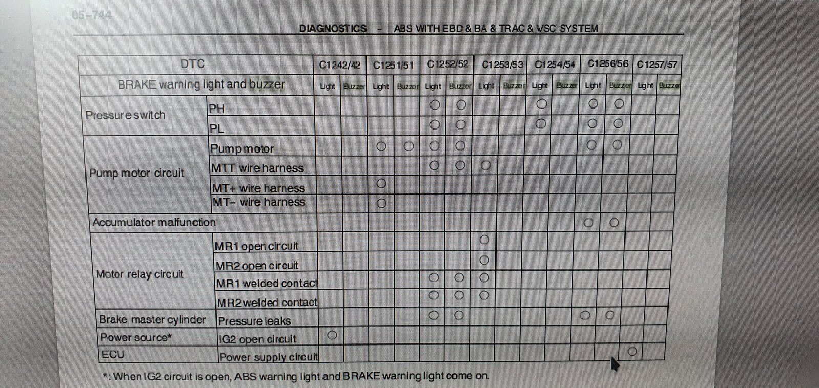

Hi 120 fans, A warning 'buzzer' is sounding on my 2006 lc3 auto , annd Im hoping someone can tell me what its for. There are no dashboard lights on , just the 'buzzer',which comes on when ignition is turned on , and stays on once started.
I have recently replaced both front disc backplates, which as you know, involves stripping out front hubs, and I was most careful in keeping abs rings clean and free from damage, as the wiring with no undue stress, but that was weeks ago.
I have also in the last few days had the air box complete off, to address some rust issues in that area.
This involved gently moving main thick wiring loom in places and masking abs pump, wiring and pipes up to spray. The pump and pipes were not removed or tampered with. It was after completing this job the 'buzzer' came on. It starts like Morse code, then goes to a louder continuous tone, which doesnt stop. As both these recent jobs revolve around the abs, I'm hoping that is not the issue, also would the wiring to the air box include a warning 'buzzer' ? The air filter is new and connections are complete. I am stumped with this, as no lights on to point me in the right direction. Thanks.
