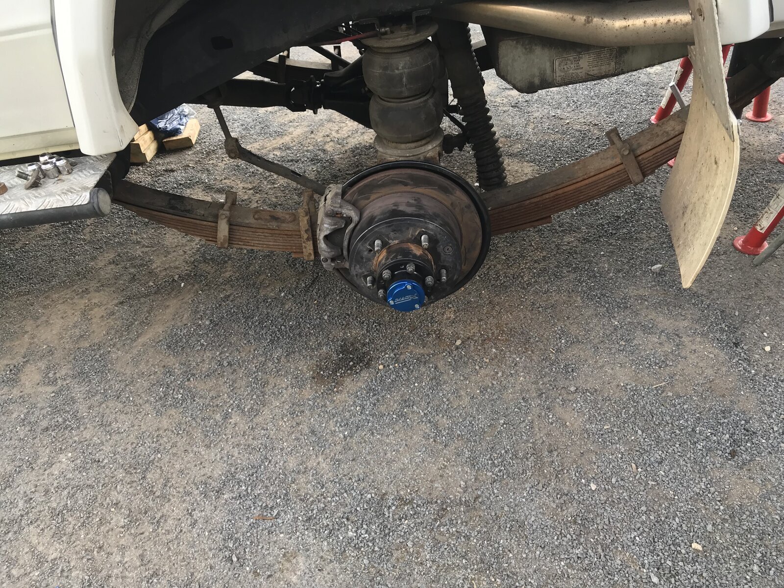

Removed rear axle, start of JMACX track corrected axle upgrade
