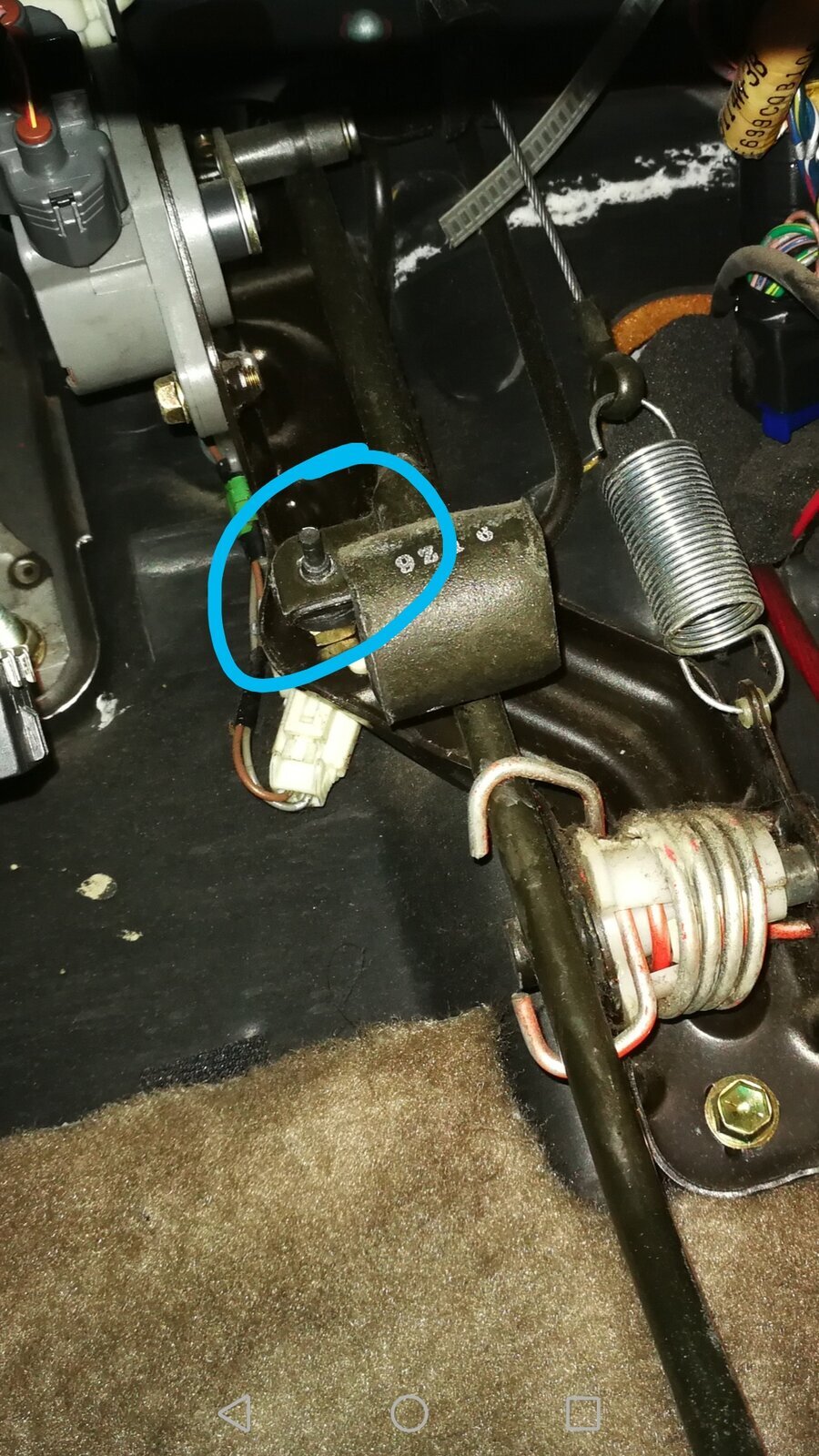

I been searching for months over the Internet over the intermittent limp mode issue on my LC100 1HD-FTE. It's exactly the same as Assuri's described. I got it fixed for free or probably under $1.
Honestly, We found it out by accident. The original "accelerator pedal switch STOPPER" had broken overtime so the switch is not working properly causing the intermittent limp mode. We put on a rubber stopped and the issue never come back *finger cross*. I believe many people would change to a brand accelerator set which is not necessary for my case. Please refer picture attached on the stopper I'm referring to. Hope this helps all the LC users out there.
Hey guys,
Can you please elaborate on this a bit further? If you can take another picture of what you replaced that would be fantastic please! I’ve got the same issue with mine and have inspected it, it looks the same as in your image.
Cheers!

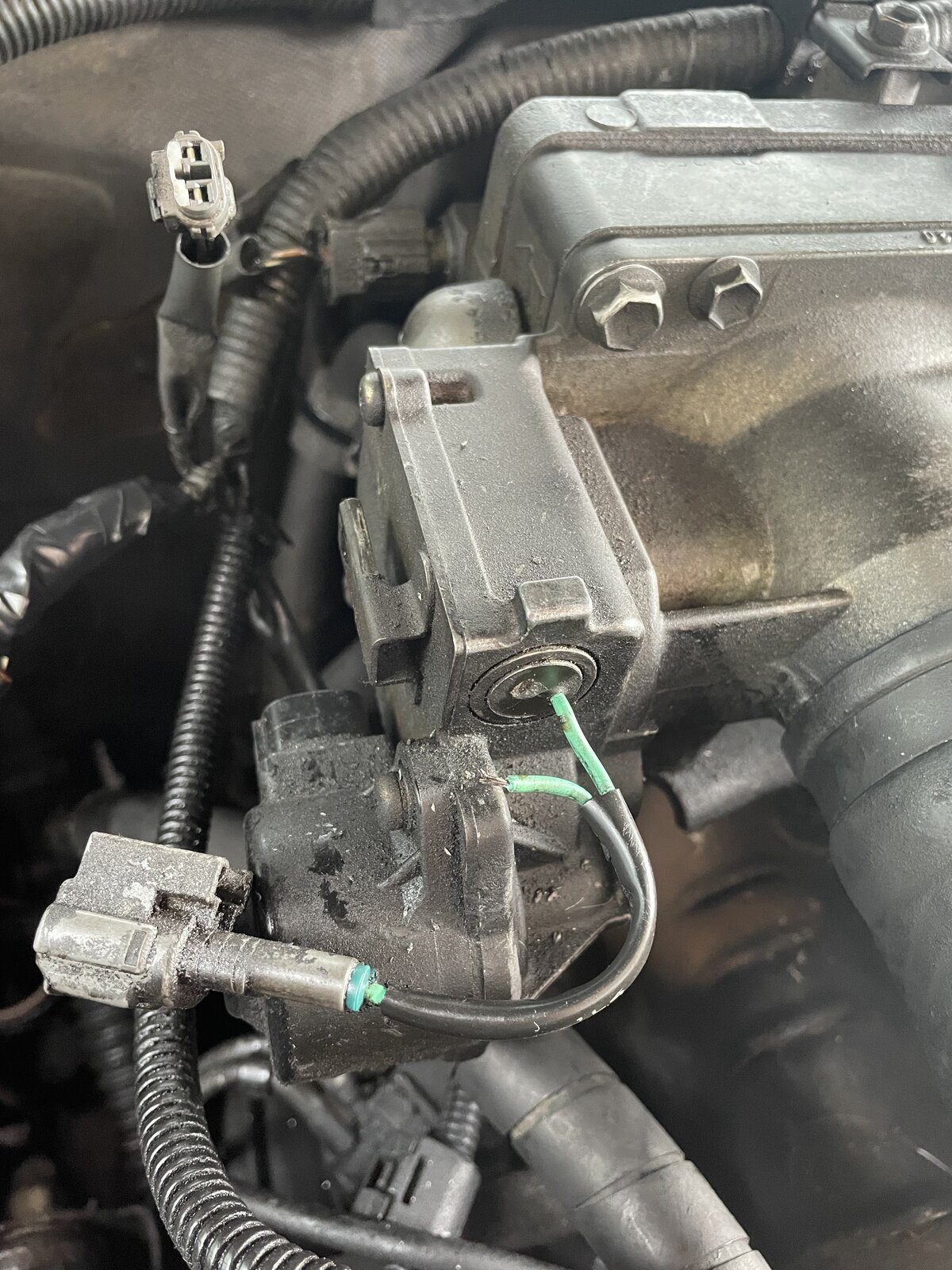

Think i might have found the problem, or part of it.
Will take the pedal assembly out as well
Update - electric wire soldered together in the plastic housing. Engine light not come on again. Touch wood!!
