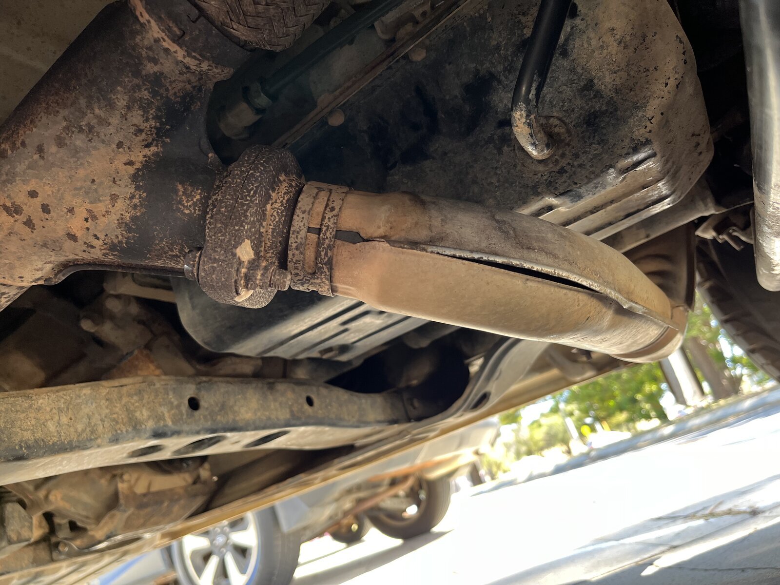

Just wondering what this part of the exhaust is and how/should I fix it??? - 1999 auto petrol Prado
That's the crossover pipe. Connects the passenger side exhaust manifold under the transmission into to the exhaust system.
My mechanic said this??? See below??? Is that the same? He said it’s not a problem??? Is he correct?
that section of exhaust is just a heat shield casing around the section post cat converter.
I guess that's possible, my one does look thinner. However the Australian market ones do not have catalytic converters or even oxygen sensors so the exhaust system is likely to be different.
Yes, just a heatshield, I have the same one on my V6. I tied some galvanised wire around mine in a few places ten years ago to stop it rattling and falling off. It's never moved since.
Thanks so much
