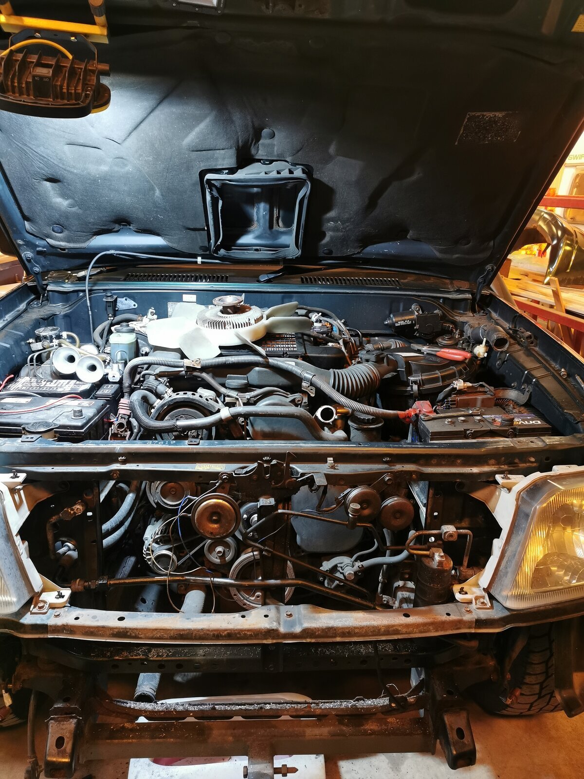

From the year I think yours is a 90, and I also suspect it has the 3.0ltr 1KZ-TE engine... There are 2 different types for the 90/95, the later had the 1KD D4D 3.0ltr, the difference being the intercooler is sat on top of the engine. As per pic attached.
The earlier engine did have head gasket/head cracked issues when over cooked, and with you saying Radiator issues, there's a possibility the head could be at fault..
But would check on your chassis number as to which engine you have, as said the d4 has the intercooler sat on top of the motor..
But yes post up on the 90/5 section on here for some answers...
,you could also join & ask on Toyota land cruiser owners UK Facebook group as there's alot of collie owners on there too...
