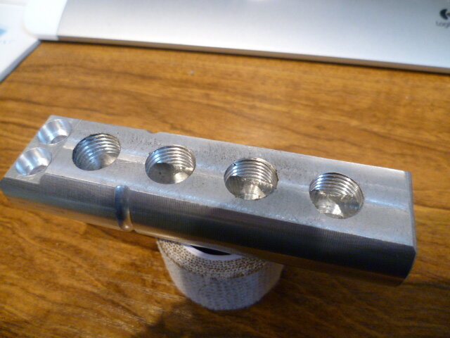

Look, I am not saying that I need one of these nor that I really believe the the OEM breathers aren't good enough, but when you couple being bored and having a man cave - you get this sort of thing:
![P1010123.JPG P1010123.JPG](https://www.landcruiserclub.net/community/data/attachments/21/21401-25c1d3bca05a9798f576ad57a57464de.jpg)
Obviously it's billet, high grade aircraft aluminium - whatever that is![Rolling Eyes :icon-rolleyes: :icon-rolleyes:](/custom/images/smilies/pack2/icon/rolleyes.gif)
Done on the lathe and miller of course from a chunk in my scrap bin. Why 4 holes? Because that's how long it was.
I have ordered some push fit 1/4 bsp fitting for it as these are actually NPT and I don't like them much But you get the idea. The end one is 10mm to go up the snork probably. If I ever bother to fit it.

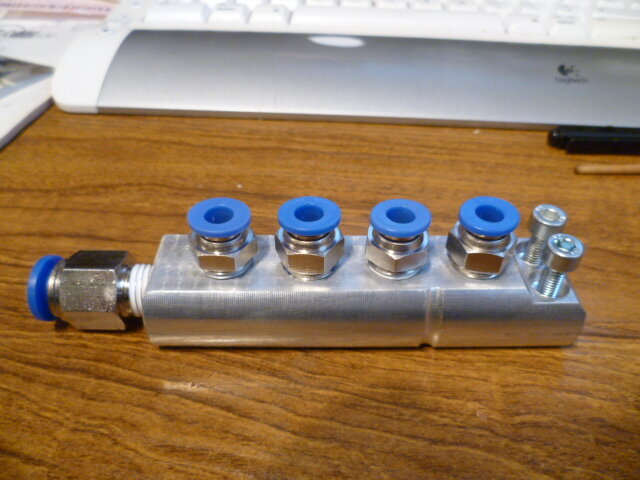

![P1010122.JPG P1010122.JPG](https://www.landcruiserclub.net/community/data/attachments/21/21402-aeb9c5fa263dc204b78dff43e80d5c0f.jpg)
I'm getting better at this stuff. Ther'e more measuring now and less tongue in the corner of the mouth with one eye closed ....
