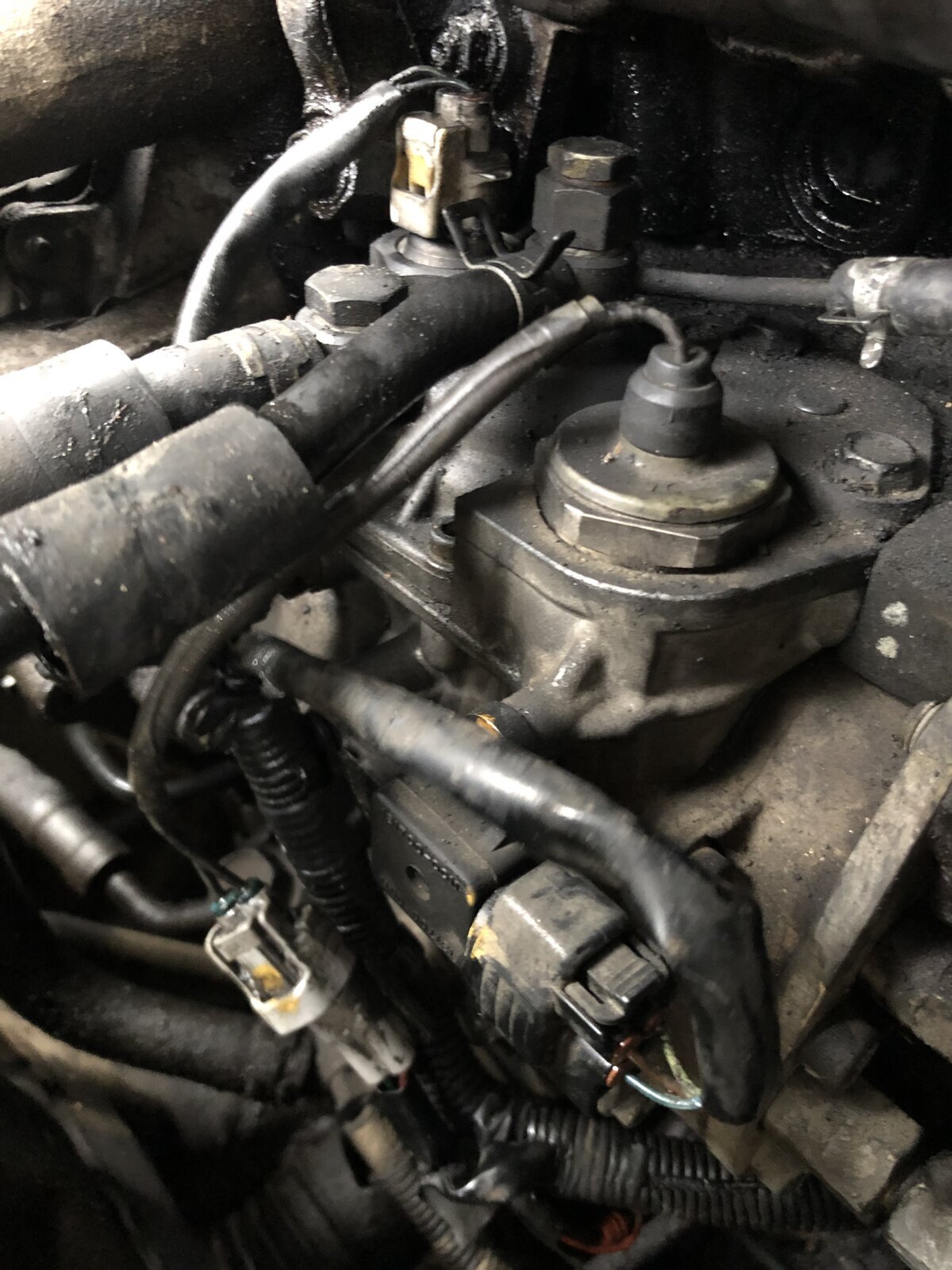

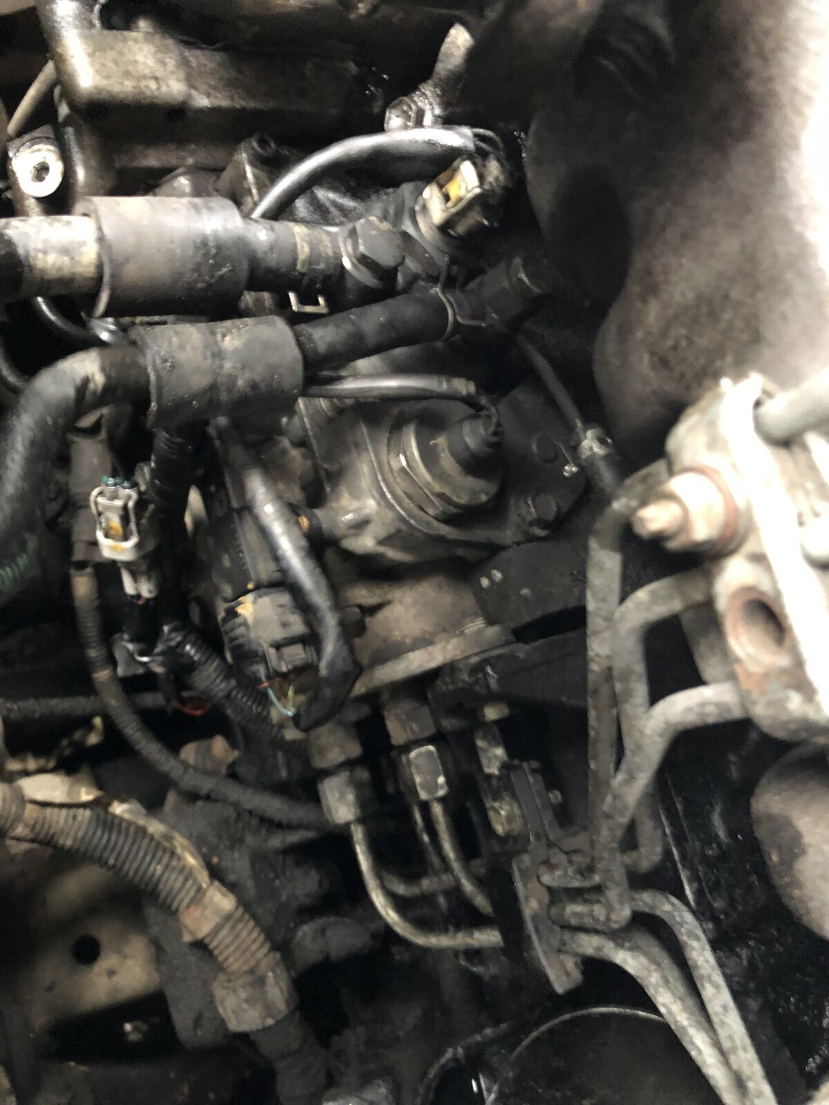

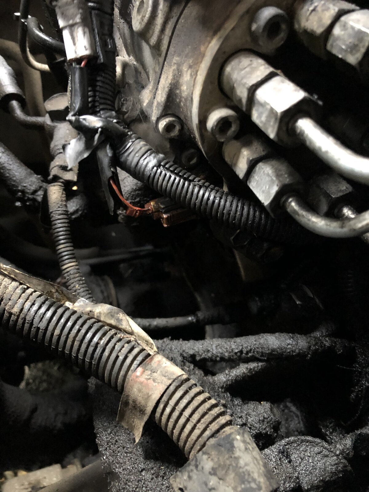

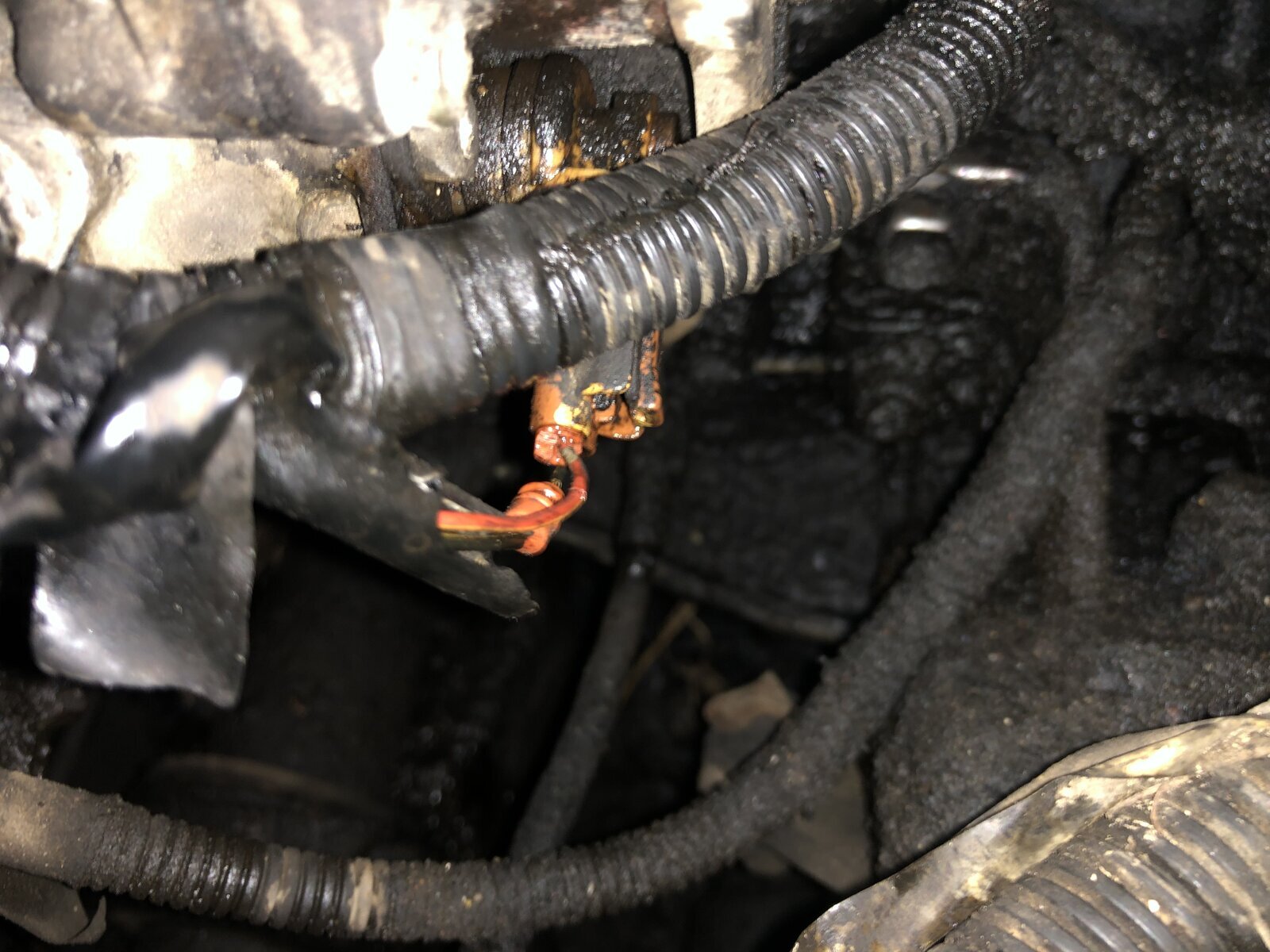

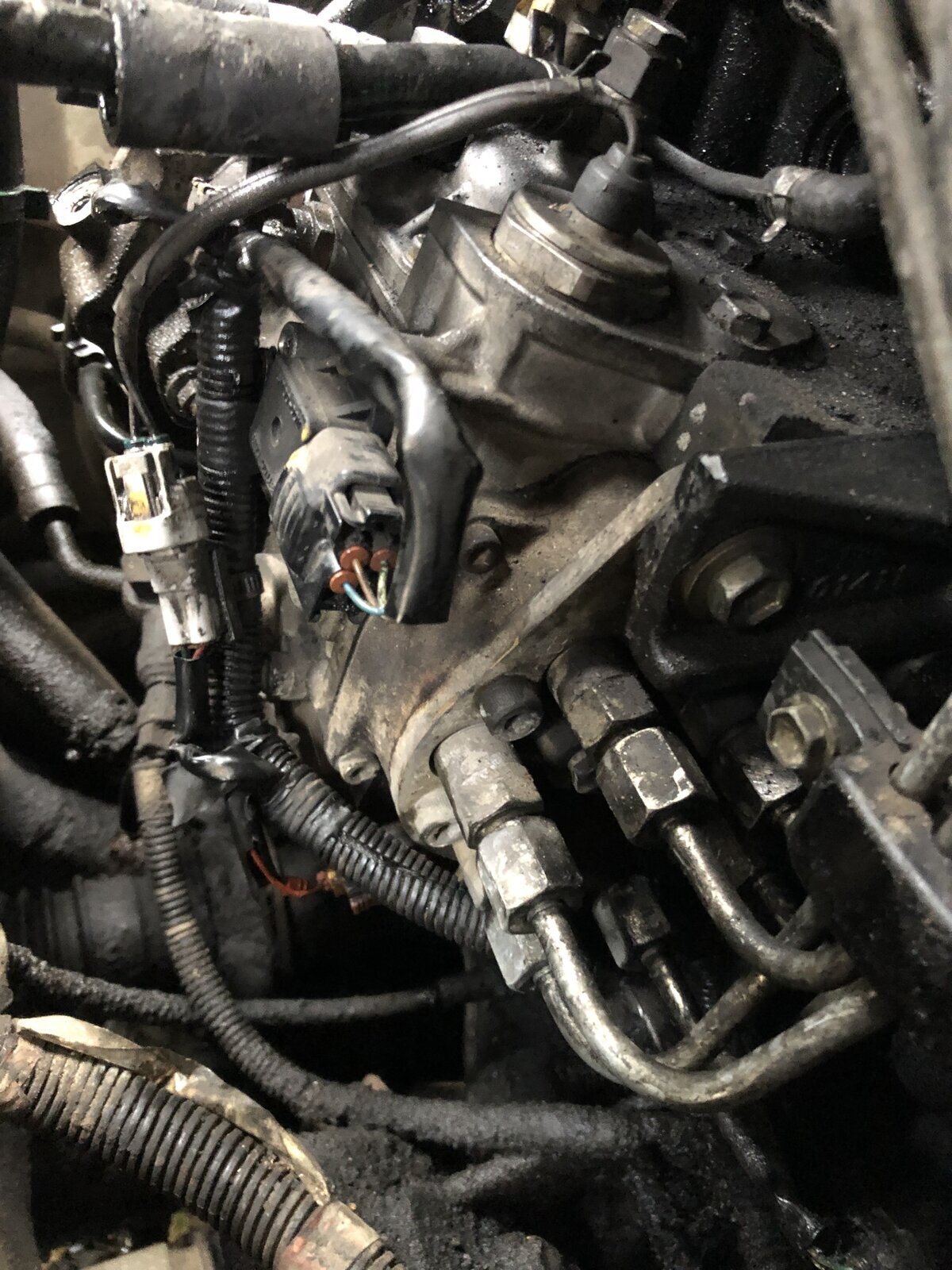

Hey guys,
So my cars a 2001, 330,000 miles, please help.
I’m sorry to ask again but I’m really confused.
The light is back on, runs rough from cold, over fueling ect, lots of smoke. Unplug and re plug in the orange plug at the Bolton, is that’s the TCV (timing control valve)? Please confirm.
But when the vehicle is running well, you wiggle the wiring and the engine note changes and the eml light comes on the dash.
Please can someone confirm which wiring / connectors are the troublesome ones, if that’s ok anyone with experience that would be great, as I’ve read so many threads ! Im now confused !
I’ve added photos !
Please help
Many thanks
Mike

Yes the TCV plug is that nasty f*cked one on the bottom that’s highly like your problem. BTW all plugs are available new from Toyota.
