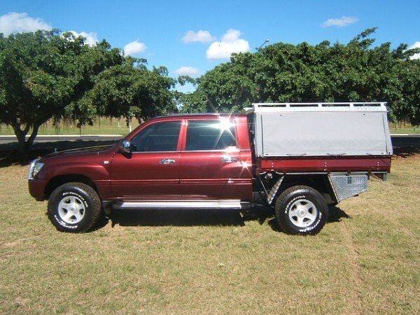

so I want to convert my 100series into a double cab Ute.
Has anyone in the Uk done this?
Tom
Both of those examples you show have had a chassis extension. Pretty common in Australia but not here. I suspect you’ll struggle to find anyone who’ll do it at a price worth paying. Sorry I can’t be more help!

What plans can there be ?
Chop the body behind engine mounts , close the hole , and all tray i've ever seen just bolt to the chassis/frame with u-bolts .
Why extend the chassis you couldn't put enough weight on the tray overhang to bend it anyway .
3 of us did this recently swapping an Aluminium tray back for a longer one , no jacks or anything just two planks between box and frame to help us slide one off and the other on .
Half hour job and I left them to bolt it all up again offering they might want to give some thought to moving the tail lights back a bit which would mean a light subframe .

"I wonder if the guys in Aus have any plans to work with?"
If you look at the videos they often combine it with a GVM upgrade ....
The videos I've seen involve lots of spreader plates , plug welds , and some very neat laser cut profiles....and end up with a job that looks factory and no doubt is the result of 100000's of Ks testing and development .
Any thing is possible if you have the kit and space to do it properly....you seem to have the know how..... post pics as you go.
There is a very neat 6x4 80 series I know of with a tipper body that was done years ago and still looks good and this chap is very talented but it was a farm workshop job so crack on and get the angle grinder out ;-)
Must add my voice to the others though .... yours looks too nice to chop up
