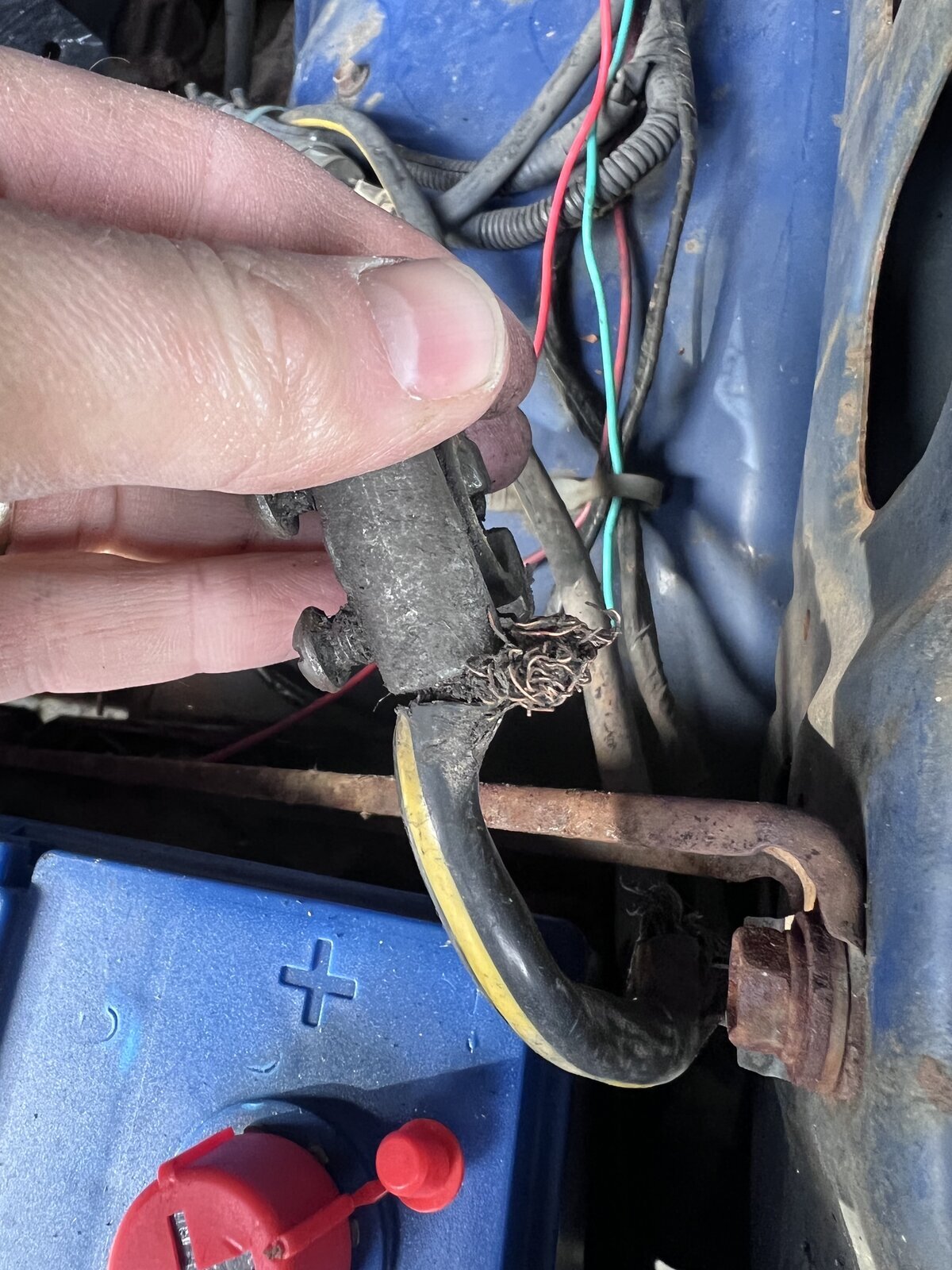

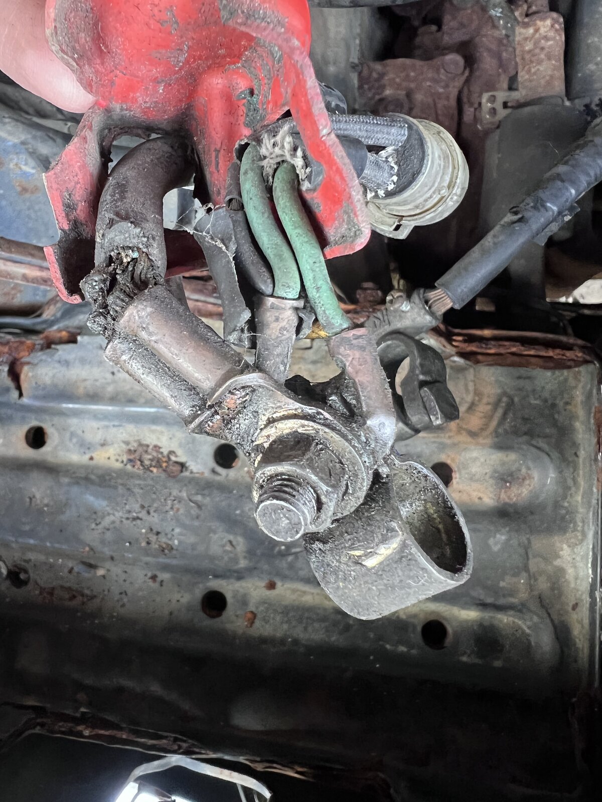

First up I picked up a pair of batteries, connected everything up and it was good to see some lights on the dashboard as well as the side lights working. Next I’ll be replacing the starter relay as you can see from the picture it’s not in great shape, same with the negative on the passenger side. It seems like the negative clamp on the passenger is also a different diameter to the other clamps as that wouldn’t fit on the G7 snugly so that will be replaced also. Obviously not that alert that morning so pic shows the battery the wrong way round.

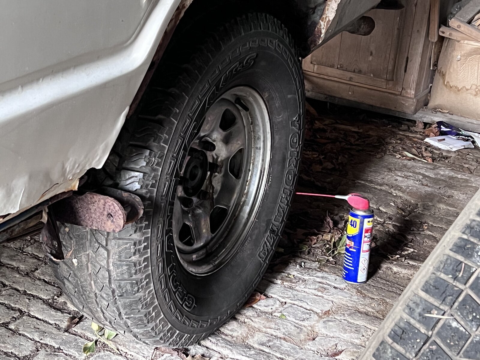

Also picked up a pair of 275/70 Geolandars on eBay as I was getting bored of inflating the tyre every few days. Swapped the rear passenger wheel to the front and removed the spare wheel that I think is beyond repair.

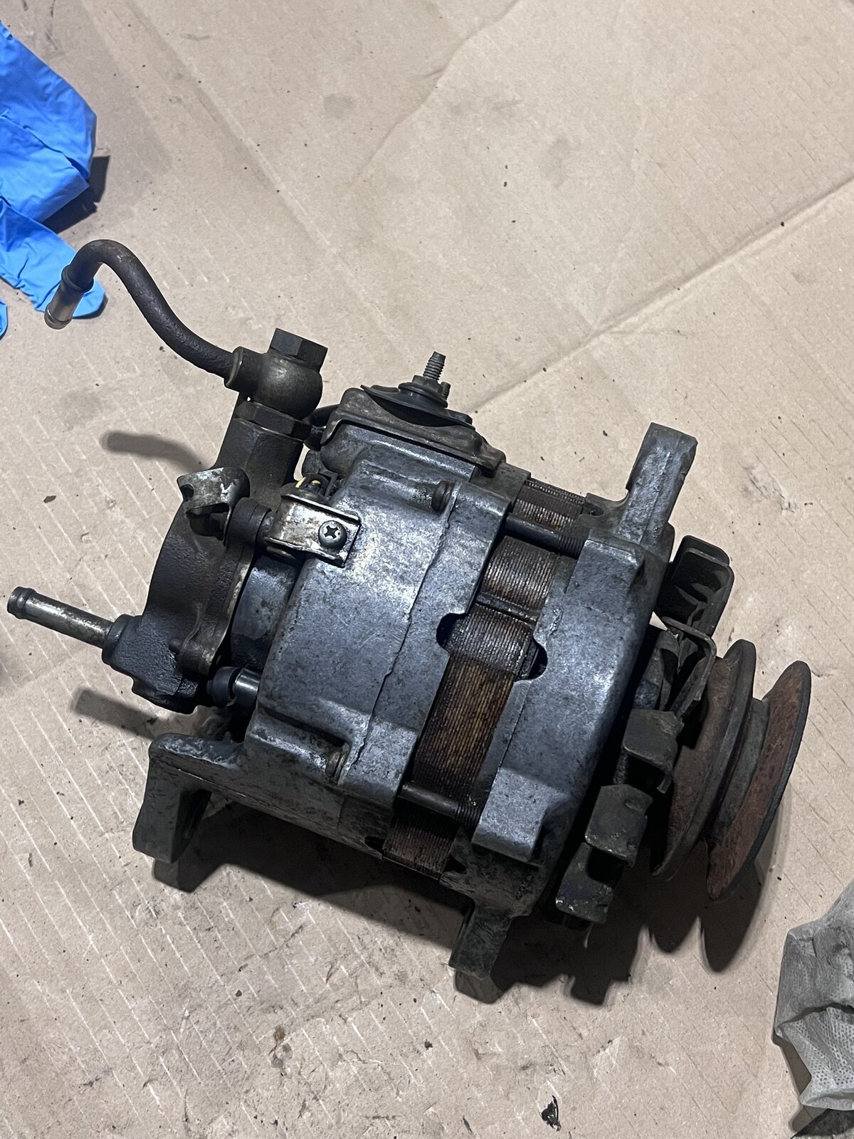

I’ve not got round to fitting the alternator yet, I need to grab a mounting bolt for it. But that has had a bit of a clean up also.
